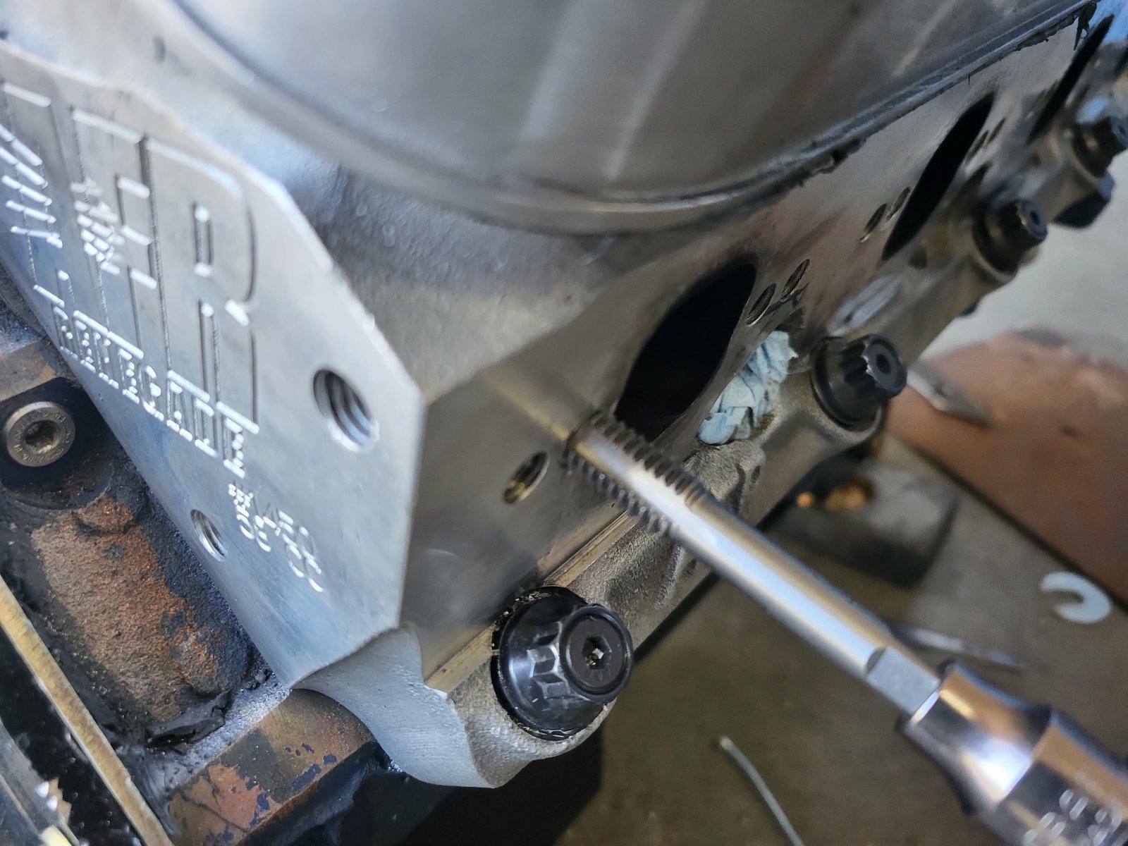

    Just about ready to "floor" test the throw out etc. And slap her back in. Both rear header bolt holes were stripped out. Probably from taking the stupid headers off 100 times. Lol.
    Pretty thin wall there so no room for helicoil. Just drilled it out and tapped it 7/16.

    For some reason I was thinking a 3/8-16 Heli coil would not be than a 7/16-14 but it is by about.007 on a side. Regardless you a brave boy! What you gonna use for a bolt?

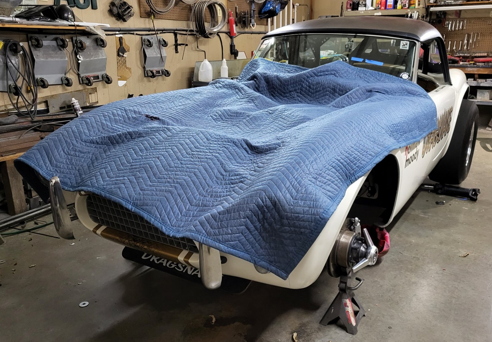

    Now isn't that sweet? I had not been in the shop for a couple of days but stuck my head in yesterday to find this. Dad must have been doing something and covered the still, half put back together engine bay. Looks like he tucked the little car in for a nap.
    It's true what they say about race cars you know. They are the sweetest, nicest little things on the planet...when they are asleep! LMAO!

    A couple of things, I did end up chancing a bit larger hole for the exhaust bolt issues and got a good helicoil fit in both holes.

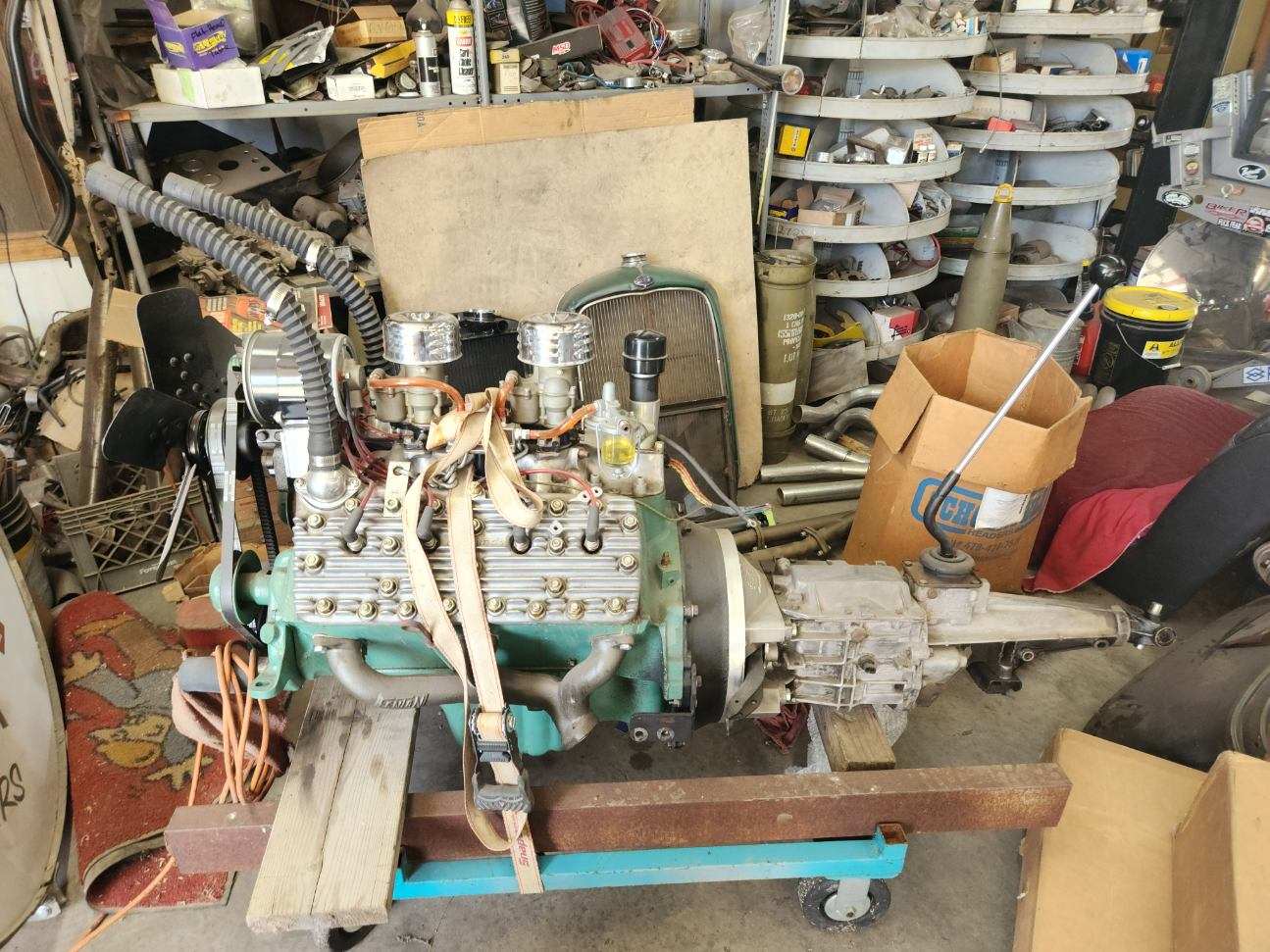

    Hopefully we will find some time this week and weekend to get the Cobra back together. We are planning one last run with it after Carl goes to Sunday afternoon Test and Tune at MOKAN. I have to say though I have been a bit distracted.
    Saturday we ventured a few miles into Kansas and snagged this little beauty for the Model A coupe that is on the back burner.

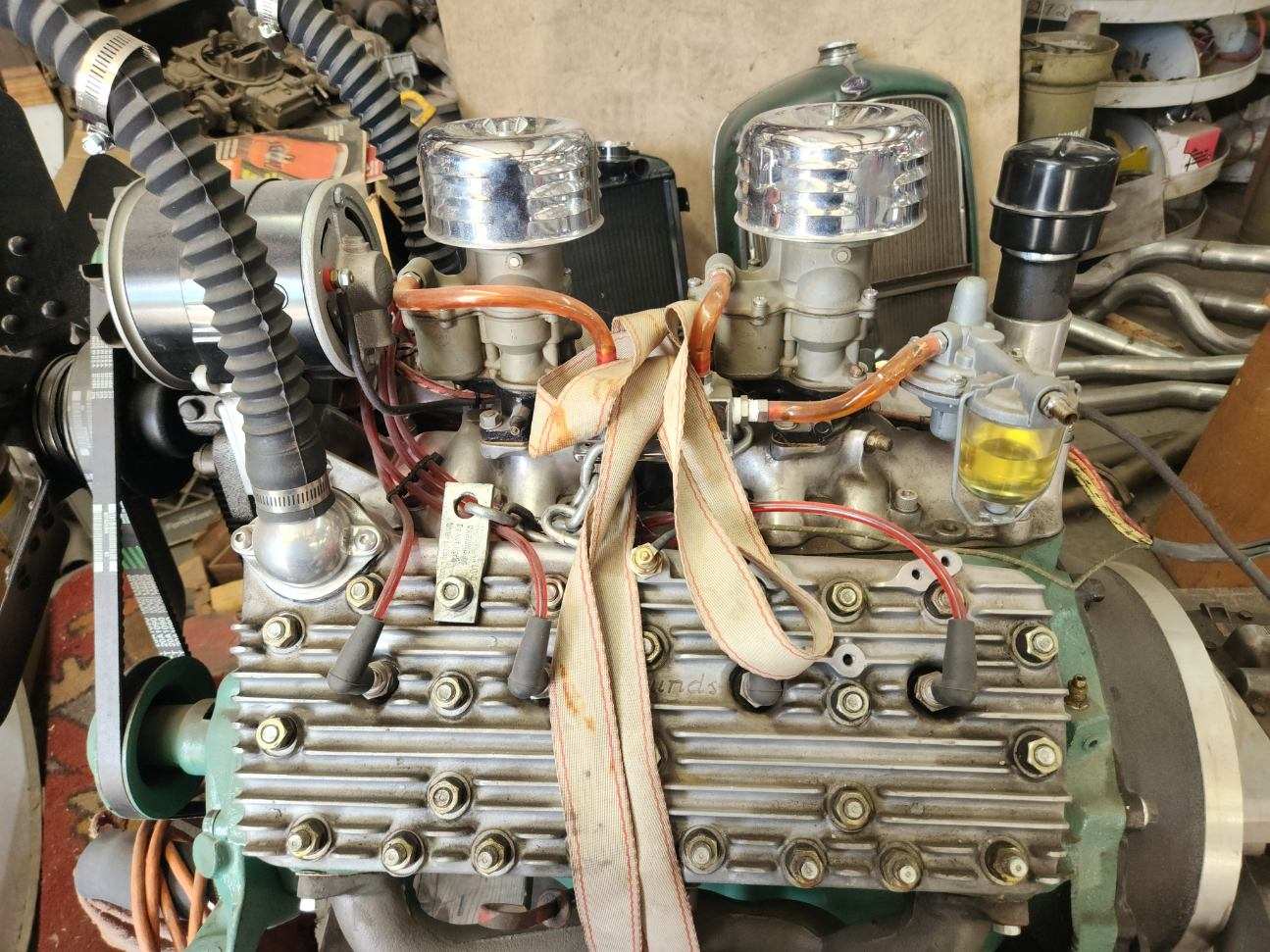

    It came out of a fellow HAMBers coupe and is pretty much ready to drop in and go. It has an exhaust valve stuck open at the movement but it came with a new set of stainless valves and even an Isky high performance cam (or at least as high performance as one can expect from a flatty). LOL
    It is running Edmond heads, Fenton intake and Fenton headers. It is already adapted to a C5 trans and even came with a new radiator that will fit my '32 Shell like a glove. It also has a set of absolutely killer coated custom exhaust. I have to tell you, it was pretty hard putting all this stuff to sleep yesterday. I can not wait to tear into this thing.
    To be honest, this morning it all got the better of me, and I ordered a pinched '32 ch***is for it (just a surround ch***is) so about all I have left to gather is a front end. We have a V8 Winter's Quick change for out back and killer set of '36 Ford Kelsey Hayes Wires on new Coker tires.
