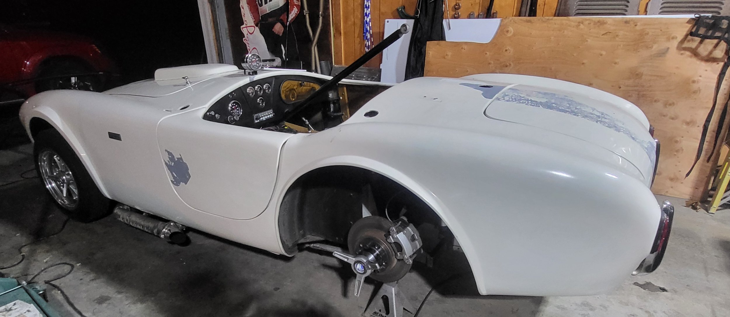

    Well it has been a while boys and girls but the Cobra is back under the knife, so I thought I would update you. We have had a blast with the ferocious little thing but I am tired of dragging it around in a trailer all the time. I am ready to just drive the stupid thing and enjoy it. So I have officially retired it from the strip and we are street bound and down!
    The poor little thing has not had a bay of its own for a couple of years, it has simply lived in the race trailer. But after moving a few other project cars to another storage shop we rolled it in to its own little den. We removed all the drag snake graphics (let me tell you, there is a part of me that really hated to see them go). If you ever saw the car in person you know what I am talking about, they were some bad *** graphics if I say so myself.....and I just did.
    The one thing we found right away was we lost a bit of the paint, Dad was cringing a bit but all and all it was not too bad. Note: this loss is all about me putting the graphics on before the paint really had a chance to cue. I don't remember why but we were in a hurry when we got the final stages the first time around. Probably had a show or race we were trying to make. But no matter, it is getting a whole new color anyway so not a big deal at all.
    After getting her up and on stands and wheels off etc. we set about removing roof and then the full cage. I sort of thought sooner or later we might get to this point so the cage was built and installed in such a way as a couple of quick cuts and it just lifted right out...easy breezy, lemon squeezey!

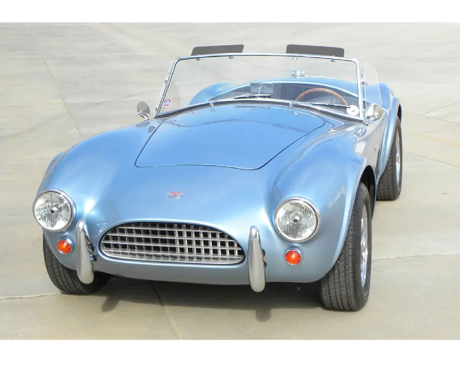

    Then we removed the grill, the bumperetts, all the lights, the windshield etc. We are going to give the entire car a quick sanding and then a filler primer other wise ever bit of the previous graphic placements will ghost through etc. Then we are going to seal it and shoot it Viking blue. Hopefully, we will be something close to this...

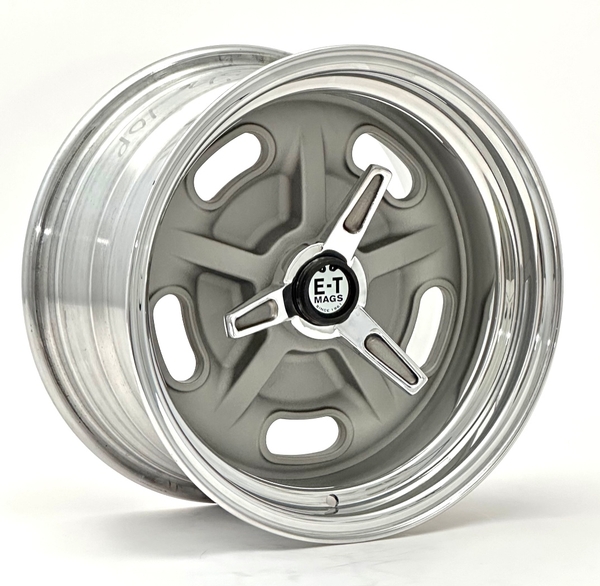

    If you followed from the beginning you will recognize that was the original color I had planned but some kind of scope creep of some kind changed the plans. Even though I really love the Custom Tri-Go knock off rims I am going to change them. I will obviously keep them and maybe pop them back on occasionally, but I want a new look for the car and I have always loved this style of rim.
    These are knock offs as well, from the same company Team 3 Wheels that produced the Halibrand looking set we have ran for the past 6 years. These are Sebring units. Who knows, you might even see the original Cobra wheels and tires on Dad's 3 window coupe from time to time. LOL

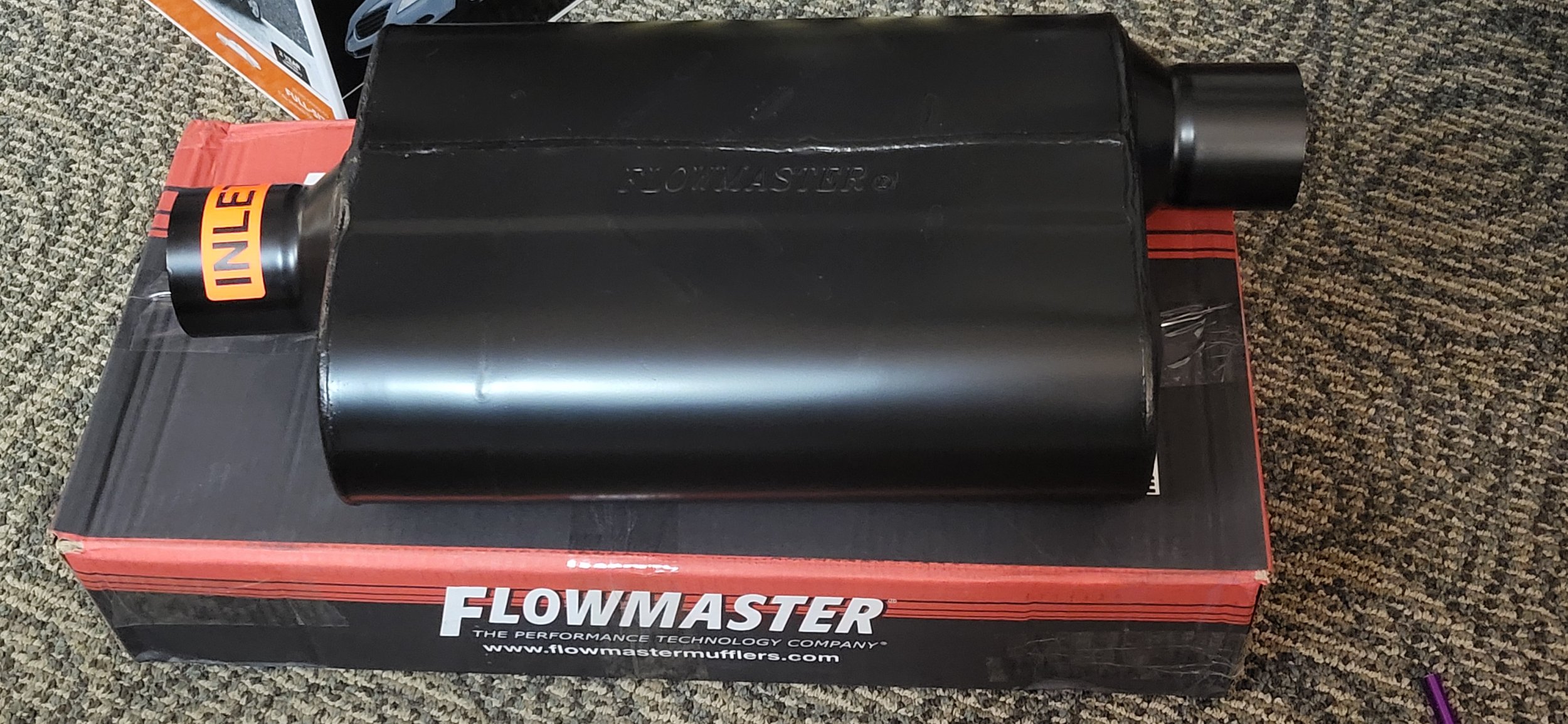

    I found a set of practically new Flowmaster Super 44 mufflers on Facebook marketplace, I told the ***** I would take them and when the next day I would be there to pick them up. When I got to his town I send him a message for the address and he said he tried to contact me earlier on Messenger (which I hate) and since I didn't get back with him he sold them to someone else. I said you sold them to me last night, I am here at the agreed time. But I think Ron White said it best, you can't fix stupid! So instead of picking them up, Zoe and me had lunch and ordered a new set!

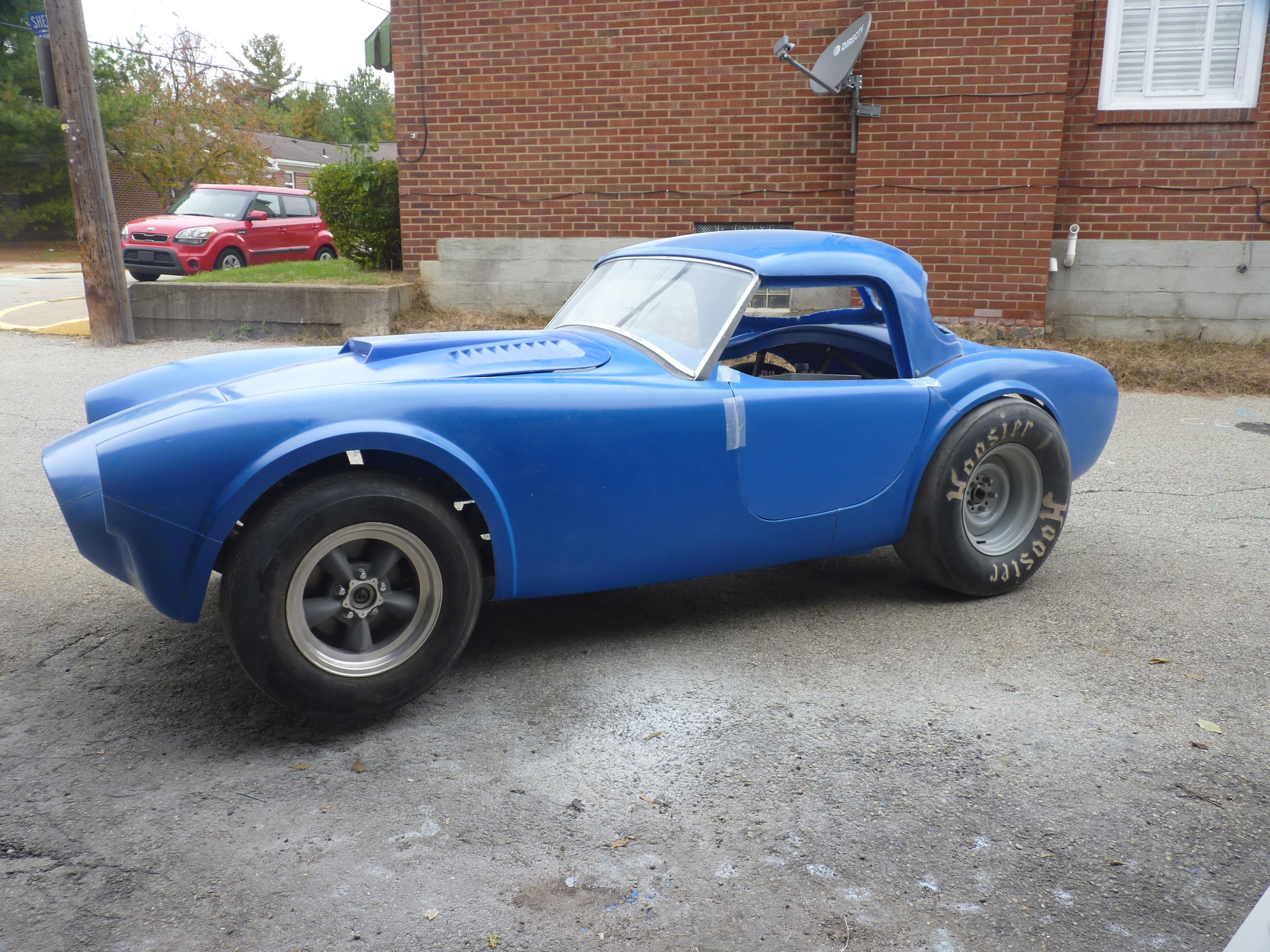

  11. glad to see you back Randal, I was close to having some compe***ion for you, Untill a guy came by and bought this one from me. Got another ch***is in the jig rite now, gonna try to keep that one for myself, been building these things since 94 and never had one of my own. let me know if you need a scoopless hood, I P1090077.JPG might have one stashed up in the rafters.
