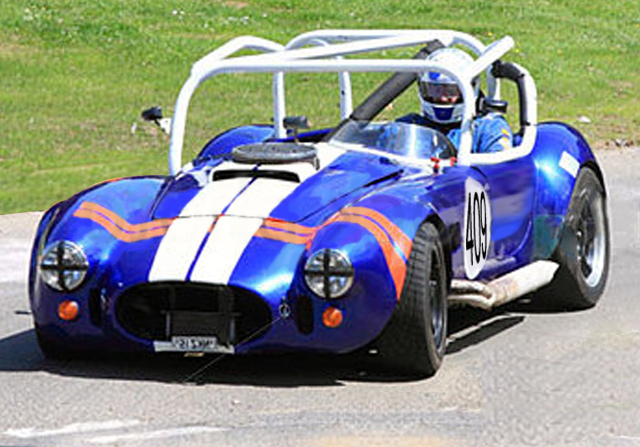

    Just curious, how much of a roll bar/cage will the car have?
    Deuced Up! and loudbang like this.

    Not nearly enough for as fast as it is going to be. Officially one hoop over the driver with one down bar running from the right side of the hoop down into the p***enger side foot area. That is all Shelby put in there! But after we get the backbone ch***is built and rolling I am going to look at hiding some bars inside and around. I mean I want to be safe but I don't want it to look like this with the top off! LOL

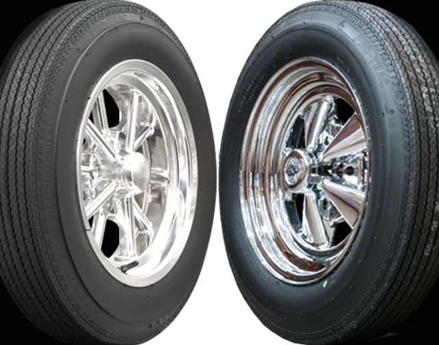

    Remember, those Pro Track front runners are TOTALLY different from side to side. One side has a big ridge on it and the other is fairly smooth. Have them on my OT Ford Fairmont Pro Street car.

    But my point is....that is one of the ugliest things I have ever seen?! I mean if I was going to build a race car and put that kind of vulgar looking cage in it (on it) what ever....WHY waste the time with a Cobra. Why not just cut the roof off an AMC Pacer and drop that ugly *** cage in it?!!!

  17. At least you got a car with room for seats, I am afraid that my old plastic race seats won't even fit in my little heap. I really want a p***enger seat so I can have some ballast and I don't always have to be afraid without company. LOL
    It becomes difficult with our cars sometimes. You have to reach some sort of a compromise in order to be safe/legal and still maintain the integrity of the build. *Then some of us run into the problem of building a car that is way too fast for what it is.
    * a problem that I will probably never have. LOL

    I noticed that...one side looks like someone just pealed a white wall off it an the other smoother side looks likes a normal tire. Not sure what is up with that, it is like Coker put two different mold halves together or something. Or I guess they are giving you two looks for the price of one....I think am going with the smooth sides out.

  19. It has to do with torque and rollout. They are lefts and rights. I can't tell you which one is which though.
    I like the front runners from Towel City, but I am not doing a car that is totally correct like your Cobra is.

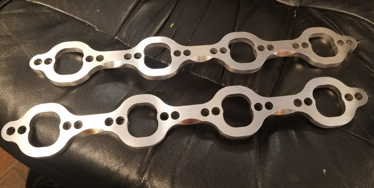

    But I also got these bad *** little stainless steel header flanges...
    These are specifically for the AFR SBF heads. There was a bit of an issue when it came to headers for this car. You see there are several companies out there that make a header for Cobras (both 289 and 427 models). However all of them are designed to exit the body just aft of the front wheel well and then turn into side pipes (which Cobra's) never had but the kit car industry made extremely popular! LOL.
    I don't remember if I went over this already or not but in the case of the 289 Cobras (AND in particular the DragonSnakes) the headers exit in about the same area but instead of coming out of the body they come from underneath it. They turn out and run just about to the door and then end in standard header flange. However what you can not see is there is a "Y" there that sends a pipe off the header back under the car and into a standard looking exhaust system. I believe an 18" gl*** packs and then exhaust pipes on out the rear.
    The deal, on the DragonSnakes, was the rules in NHRA Sports Car cl***es read that they car had to retain a standard exhaust system with mufflers etc. It did not say they had to use them, it just read they had to be on the car and hooked up. The gray area there allowed the dragon snakes to run open headers that were attached to a standard looking exhaust system with mufflers etc....LOL
    For me to make headers drop far enough and exit the way I want, they will have to be custom built. I have a friend here in the area that is going to custom fab them for me. I am really excited because he is really good!
