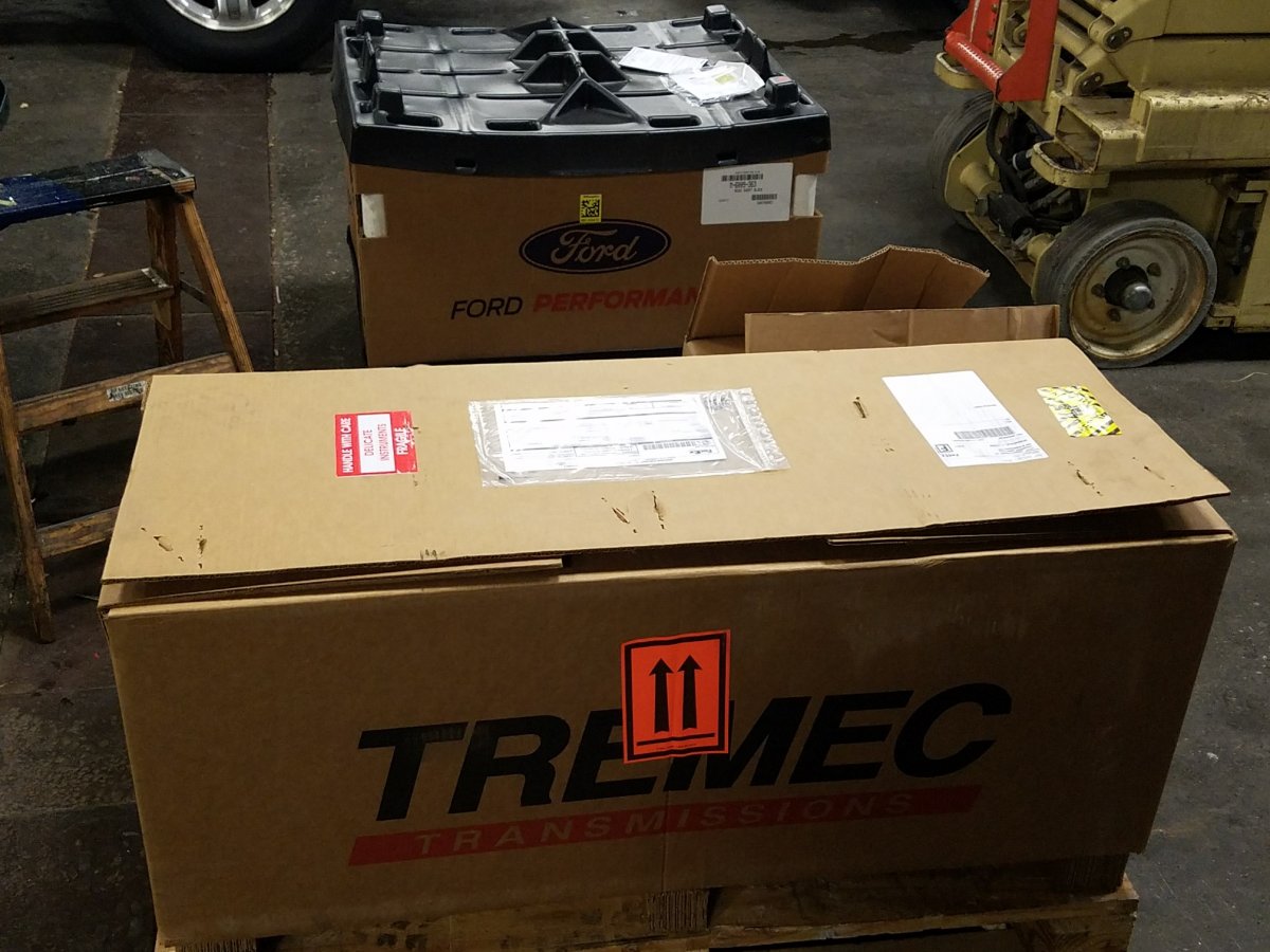

  3. DDDenny
    Posts: 22,554
    OK, just to offset my humorous criticism, I gotta imagine pulling that Weber injection setup out of the box had to be pretty damned exciting, I was pretty jazzed for you myself.

    Yes it was a very exciting day and then I walked in and found this...

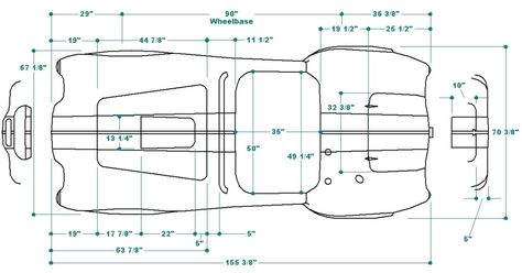

    Well, Fat Man Fab completely fabricated this front end based on the track width I supplied them, including
    narrowing the rack etc. The slab side car is 61" outer front flare to outer front flare so I used that as my
    outside number. And looking at photos of real DragonSnakes their front tires are right on that mark if not
    cheated a bit outside (sidewall only speaking).
    So I took 61" minus my (front wheel width minus backspace) 5.5" rims with 2" backspace is 3.5".
    So I took 61" minus 3.5" x 2 for both sides etc.
    So I took 61" minus 7" minus the wheel adapters for the knock off kit 3/8" or .375 x 2 = .75"
    So I took 61" minus 7.75" and got 53.25" official track width and I had them engineer the front end for 53" even.
    What they sent me surprised me a bit as thought they were sending a stand alone one piece front end with no frame cut out etc. (engineered for 53" track width). But apparently they couldn't do that. Possibly the upper "A" arm/shock brackets are already notched etc. What ever the reason,"they" fabricated a custom 24" wide cross member etc. to do the job. When we had the one side of the front end ***embled I took a rough measurement from the center of the cross member to the rear bearing race on the spindle. It was round 23" so I figure it is close if not dead on for 53" mounting surface to mounting surface after the rotors are in place.
    The 24" frame idea just happened as that is what the front end basically came set up for with the notched upper brackets etc. When we got to the steel yard Saturday (even after talking with them several times over the past week about my round tube, I find they do not stock any of it. All special order. NICE. So that is when Dad and I wandered back over to the steel samples wall and decided what the hell, the front end is set up for 2x3 rectangular tubing, lets just go with the flow.
    So instead of taking their parts and welding up a solid stand alone front end piece and then figuring out how to mount our narrow round ch***is to it, we just got the rectangular stuff and built it the way the front end was engineered. Now I do know spindles, rotors and calipers etc. are all Granada but the "A" arms are custom for our track width.
