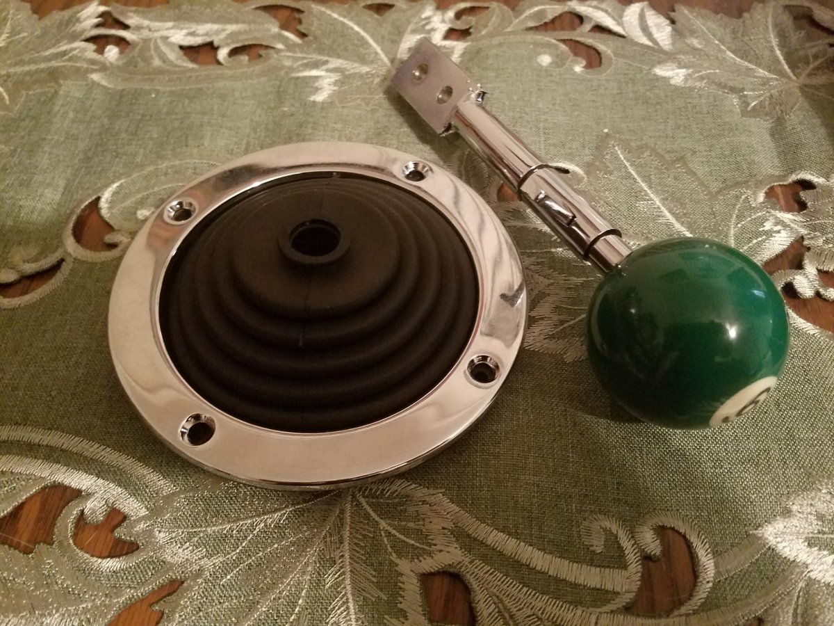

    Yes I think that is a safe ***umption...LOL! AND...I found a chrome ring for the boot...now we are ready! Forget all the fab work that needs to be done, if I can just sit in the shell and hold the shifter all is well. Man if I could just get a steering wheel for this ****er I would be in hog heaven! I mean it is one thing to pretend know how she sounds and shifts but I really want to know how she is going to pretend handle! LMAO!

  21. DDDenny
    Posts: 22,453
    This purely falls under the "food for thought" category.
    When I was looking at shift boots for my roadster I considered the Cobra repop versions but they looked too short to work, and as you can see I needed the shift handle to "dog leg" too. The boots' offset can go right, left, forward or back.
    I only bring this up in case you end up with additional positioning issues.
    Before I got that far I found this one, not sure but I think it is a discontinued Mr. Gasket item, found hanging on a hook in the corner of a local speed shop.
    It came with a cheesy trim plate that I didnt like so I made my own trim ring, it also needed to sit higher so I also had to get creative there too.
    I won't go into detail unless pressed.

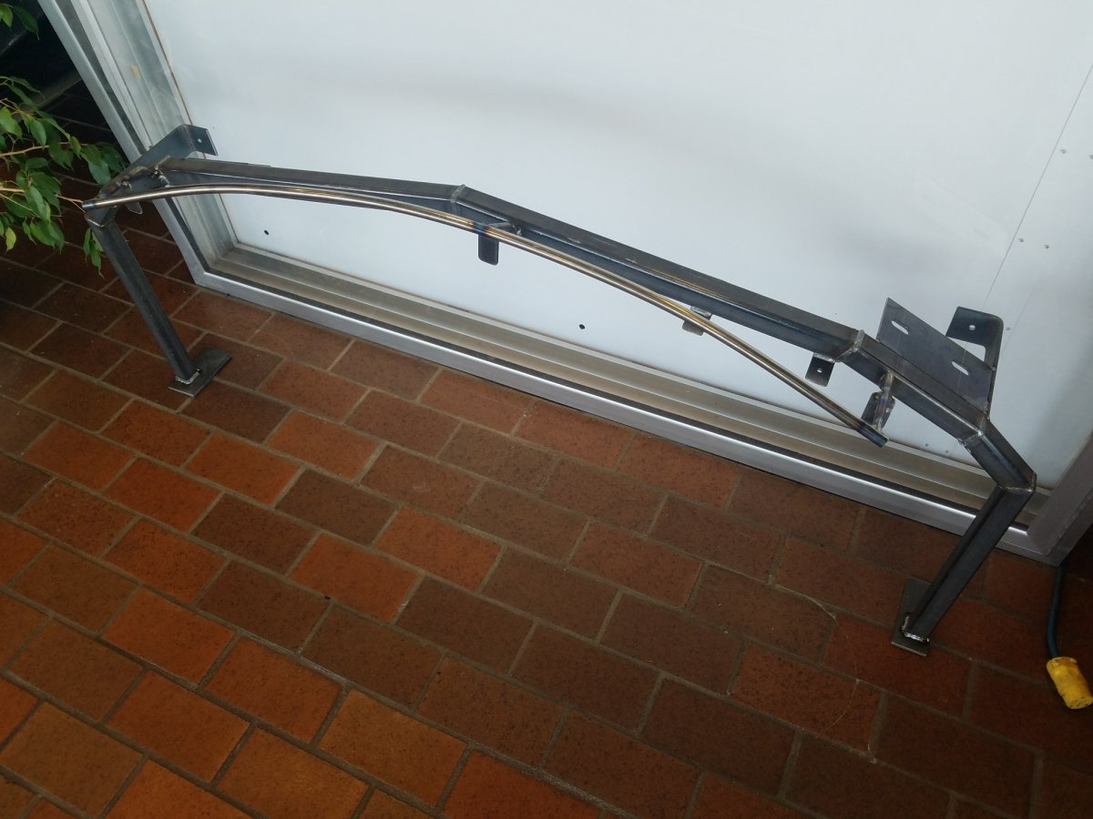

    Well all of the Cobra stuff (minus the br*** over flow tank) rolled in this morning. This cowl hoop is the thing I am most excited about. It came straight from the ch***is department at Shell Valley. Now it may not fit our body perfectly but it has to be very close. It will hopefully take care of several issues that with out it we are in the dark about.
    First off it is set of for the windshield frame mount so hopefully no fabrication there. Secondly it is set up for the door hinge hardware as well. Plus it has mounting area for the glovebox and the dash. SOOoooo....Hopefully this little jewel is going to give us a leg up. I can't wait to get it home tonight and stick it up under the cowl and see how close it is etc. Stay tuned!
