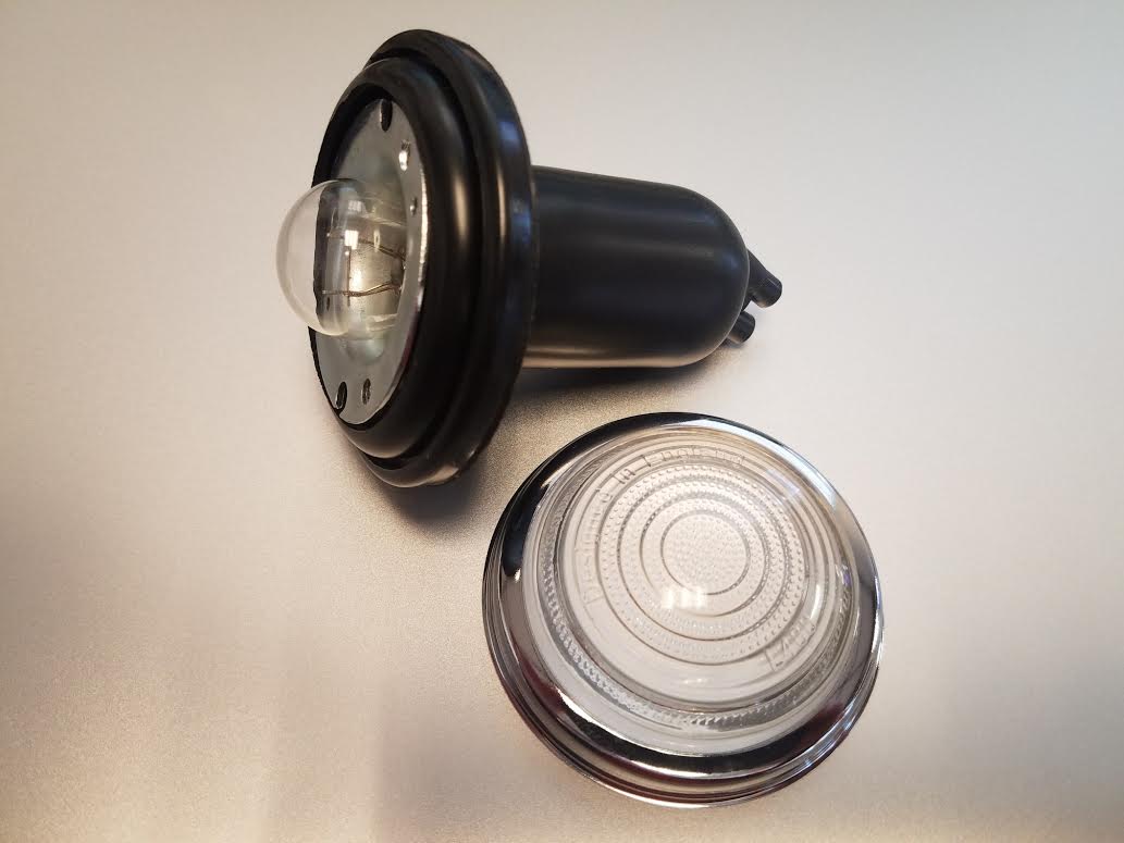

  3. Motor City
    Joined: Nov 26, 2010
    Posts: 42
    Motor City
    from Michigan
    Those lenses look like what was used on reverse lamps on Triumph TR4's & TR250"s

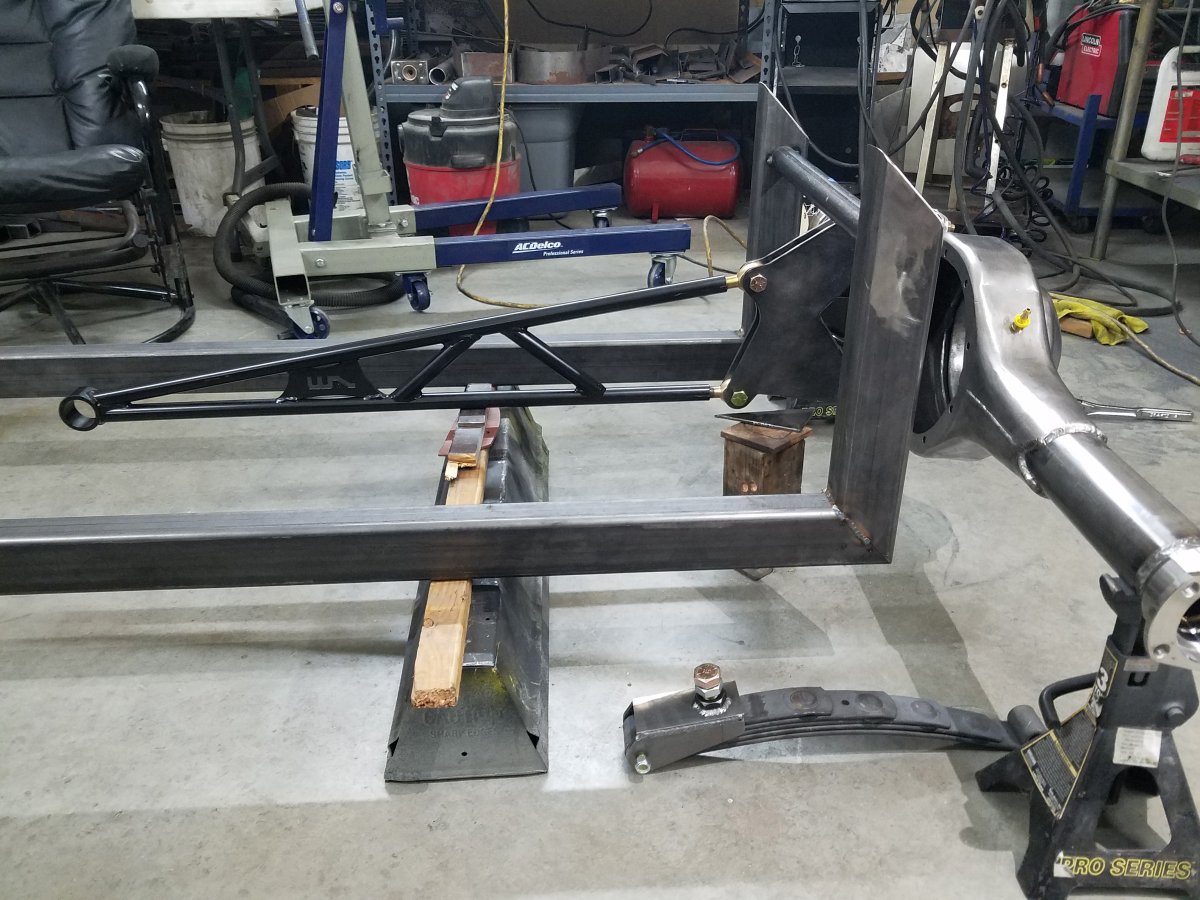

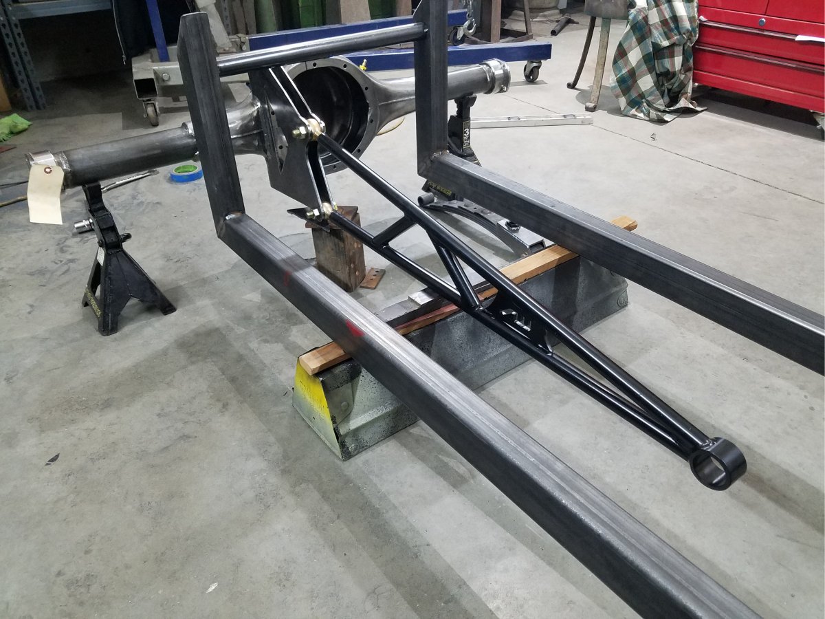

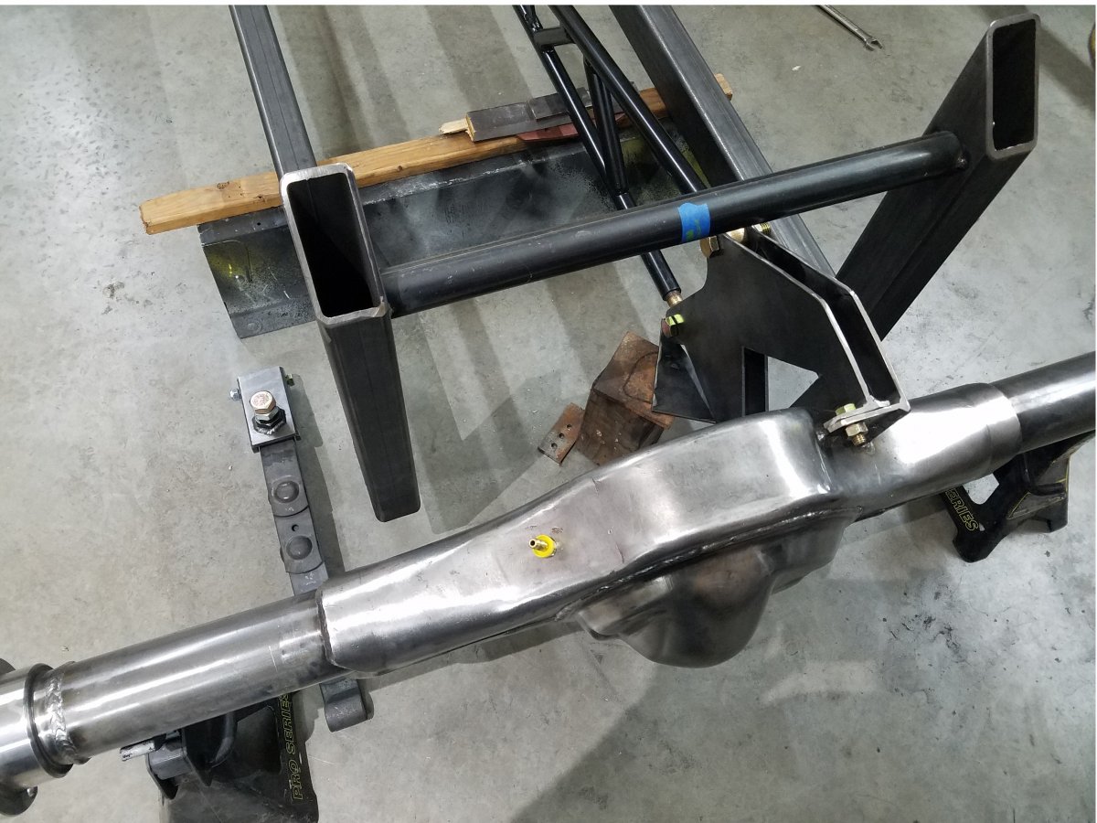

    Well we had a fairly productive day yesterday on the fabrication front. It was a long day but a good day none-the-less.
    We started about 7:30 by sitting the 9" Ford housing on a couple of saw horses and dropping the Yukon Nodular housing in place pointed to the ceiling. Then I walked over to a very nice stack of boxes full of performance parts and cut the top flaps off of one to play around with making bracket patterns on the rear end.

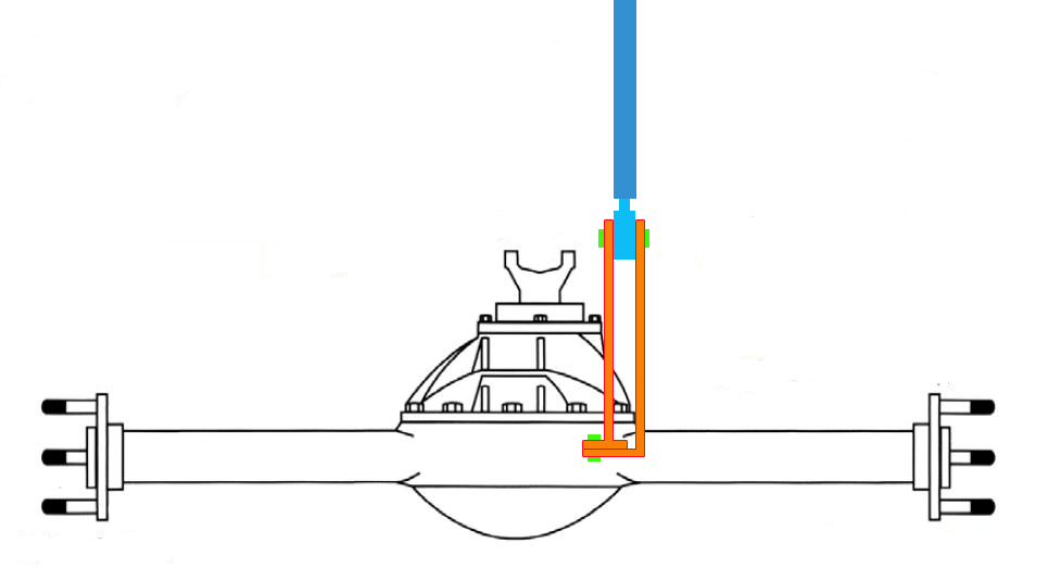

    The plan for the day was to come up with some way to mount what someone on here earlier referred to as inboard ladder bars on the Cobra. The issue we have as I have said before is the ch***is is basically underslung by nature. So unless we want to design it like a lifted 4 wheel drive there is no room under the floor pan for ladder bars etc. So my original plan was to run a single ladder bar and tuck it into driveshaft tunnel. I have read several articles on single ladder bar systems, a couple that down right claim it is the only way to do it.
    However as said above, we started off the morning thinking about tucking two of them up inside the tunnel on either side of the drive shaft. My goal was to come up with a bracket system that would not only mount them but keep them 10" outside to outside. After several hours of trial and error, the floor was littered with hacked up cardboard and masking tape and just about every box in the shop was *******! LOL.
    A**** the issues at hand, making the bracket or brackets removable seemed to be the one of the biggest hurdles. I mean if it can not be removed then the center section can not be removed etc. Most of the problems seemed to occur on the driver's side basically because of the offset and span of center section that had to be bridged to get that bar inside the 10" zone for the tunnel. When I hit the shop this morning below is what had sketched out but after actually seeing it come to life in cardboard there were issues.
    So we started experimenting on the fly with other ideas based off the above and nothing really seemed to fill the bill. In my opinion the two really need to share the same mounting platform to get the geometry correct. I mean they have to be the same height and end up 42" away the height and same length etc. At about 2 p.m. we broke for lunch with nothing to show for the day except a floor full of cut up card board.

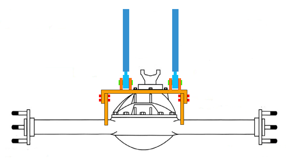

    When we got back I started picking up and Dad went back to pontificating from the office chair in the shop. He made the obvious statement with daylight and our creativity both running short. Back to the original plan, one ladder bar. I don't know if it was exhaustion or bad Mexican food but it sounded pretty good me. Especially since in one of the earlier mock ups we had a really good one for a single bar on the p***enger side (which is where I would want if it we went with a single).
    So above is direction we embarked upon. The outside steel plate being welded solid to the housing and inner bracket designed to bolt on to it with an area cut away to span over the center section. And we hit 5" on the dot from center of the yoke to the outside of the ladder bar.
    Before we plasma cut the brackets installed above, we sat the ch***is on the floor 7.5" up which is about where we are headed. We adjusted the housing for a good pinion angle and aimed the ladder bar to end up front centered up and down in the height of the frame rails. Then we made the appropriate changes to our card board template and went to work with the plasma cutter and grinder.
    After we had the brackets cut and cleaned up we double checked several things. One, did they clear the center section as planned. Two, where the angles correct for the ladder bar etc. After having it apart and marked at least 5 times, double and triple checked, I finally removed the center section and tacked the outer bracket in place. Just to be 100% sure we ***embled the inner plate and the ladder bar and sat it all back in place to check the pinion angle and the front mount point for the ladder bar and we were dead on. So I welded the holy hell out of it.
    By 6 p.m. we had it all back in place and could finally set back and enjoy our handiwork. We laid out the quarter elliptic springs and they appear like they are going to work perfect. And our little upper and lower bolt holes on the inner bracket will be the starting point out back for the Watt's Link mount etc.
  5. Tickety Boo
    Joined: Feb 2, 2015
    Posts: 1,800
    Tickety Boo
    from Wisconsin
    It would be close to the frame rail, but is there room to do the same on the drivers side?

  6. Deuced Up!
    Joined: Feb 8, 2008
    Posts: 4,224
    Deuced Up!
    You know while Dad was pontificating (lol) Saturday he had a pretty good idea. After the wheels get here and we get the mocked up suspension (front and rear) installed. We could actually just stack the part boxes on the ch***is to double check our sprung weight and ride height etc. Since everything is still in boxes starting with two big ones with the Engine and Trans in them. We can just set those two on the frame rails and then stack what ever else (of consequential weight) on top of them still in their boxes as well. That is going to be a pretty funny photo! But a pretty good idea!

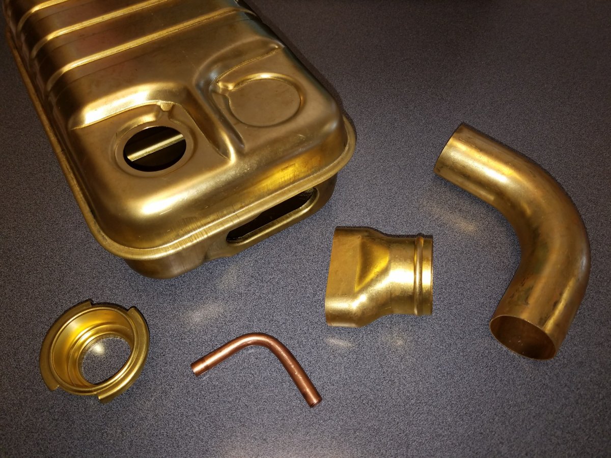

    Well I had a pleasant surprise when I got to work this morning. I was out most of the day Friday onsite with a customer and apparently the Cobra Elves delivered a few more packages. The ProMaster alternator is here as are the QA1 Adjustable rear shocks. And this handy dandy (some ***embly required!) br*** expansion tank. What a pain in the backside. So I guess since it came with absolutely no instructions that we have to ***emble the car first, then install in the tank, figure out and mark it for the direction the hose needs to go and then find an old school radiator shop to have it all brazed together. (well at least they pre-cut or punched the holes in it!)...
    mad mikey, loudbang and enloe like this.
  8. squirrel
    Joined: Sep 23, 2004
    Posts: 59,977
    squirrel
    I think they'll solder it, not braze it. And yeah, I would get someone with some radiator experience to ***emble it, too. Even though I've been soldering stuff for a long time.

  10. oldolds
    Joined: Oct 18, 2010
    Posts: 3,640
    oldolds
    Have the rad shop use Silver solder on that tank. They will cry about how much harder it is to do, but it will be better in the long run. Much less prone to crack from the vibrations and thermal cycles.

  12. Deuced Up!
    Joined: Feb 8, 2008
    Posts: 4,224
    Deuced Up!
    Thanks Jim. Actually had no idea the difference which shows how much I know. I have soldered my share of copper fittings (plumbing style). I guess I just ***umed in the world of radiator repair it was brazing. So for the rest of you that might not know either....
    "The basic difference between soldering and brazing is the temperature necessary to melt the filler metal. That temperature is defined to be 842ºF/450ºC by the American Welding Society (AWS) but is often rounded to 840ºF. If the filler metal melts below 840ºF the process being performed is soldering."
    Well there you have it. Either would probably work better than black RTV which is about all I could throw at it. LOL!

  13. southcross2631
    Joined: Jan 20, 2013
    Posts: 4,412
    southcross2631
    Those front marker lights are exactly like the original ones on my 58 Morris Minor. Mine say Lucas made in England on the gl*** lens.

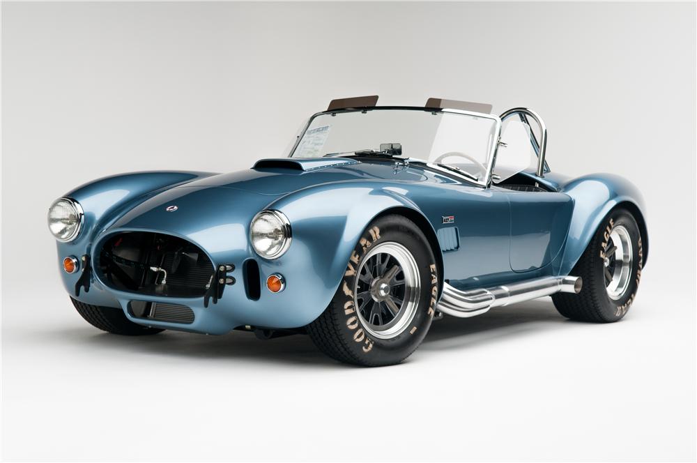

    So I know the color for the Cobra: Viking Blue. That is what the original Team Cobra cars were painted. However there seems to be some consistency issues in the Ford Viking Blue color from paint chip to paint chip etc. ....surprise, surprise! We have several good paint shops here is Springfield (and when I say paint shop I mean auto paint suppliers etc.). I have been to a few and even had some test samples mixed up but I am not happy yet. Then last week the guy behind the counter said I should just go find a car the color I want and ask the owner if they know the paint code etc.
    Not a bad idea. So that is just what I did..... Here it is....
    AND here is how I found the code. I reversed searched this photo on Google and found several hits for it one of them Barrett Jackson. I took that hit and chose to go to the original publication. That was indeed a Barrett Jackson Auction from 2013. Under the listing for this car it was listed as CSX 6166 and the color was Viking Blue. I continued reading through the cars bio to see if there was any indication of who sold it. All it said was, "A CSX 6000 generation Cobra offered by the Largest Authorized Shelby Cobra Dealership in the World.
    So I Googled: "What is the Largest Authorized Shelby Cobra Dealership in the World?"
    header_home_button.jpg Was Google's ANSWER. So I went to their site.
    They show to be from Windsor California and sure enough, right across the top of their web page it said:
    "Largest Authorized Shelby Cobra Dealership in the World!"
    So I called them up and said I had a question about the CSX 6166 that you guys sold through Barrett Jackson at Scottsdale in 2013, I believe it was lot number 1301 if that helps. He pulled the file and I told him what I was building and what I would love to know was the paint maker and code etc. He said the only problem was they didn't paint it, it came to them complete. However he said he knew exactly who painted it and he would give them a call for me and get the information!
    See that was easy right? Just find a car painted the color you like and ask the owner for the paint code! LOL
    slv63, kiwijeff, mad mikey and 3 others like this.

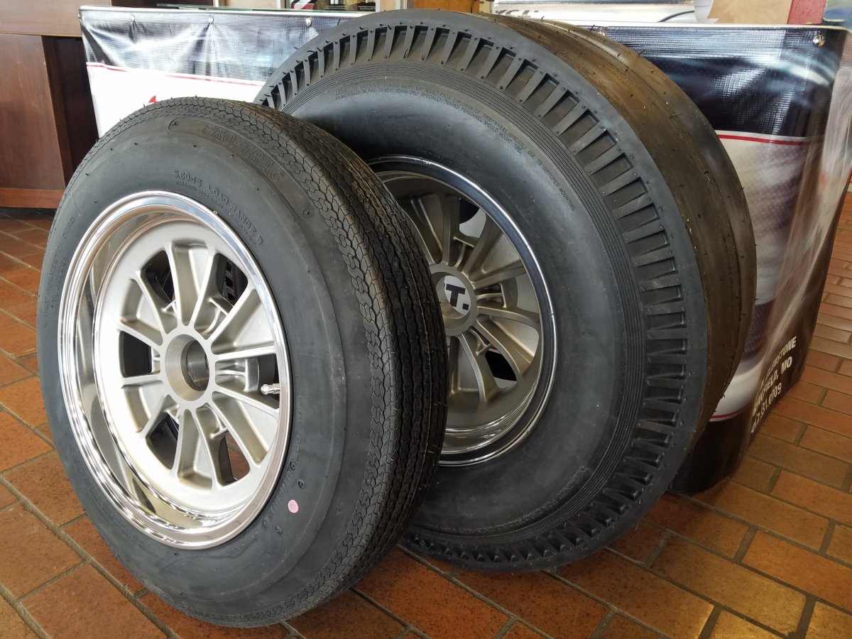

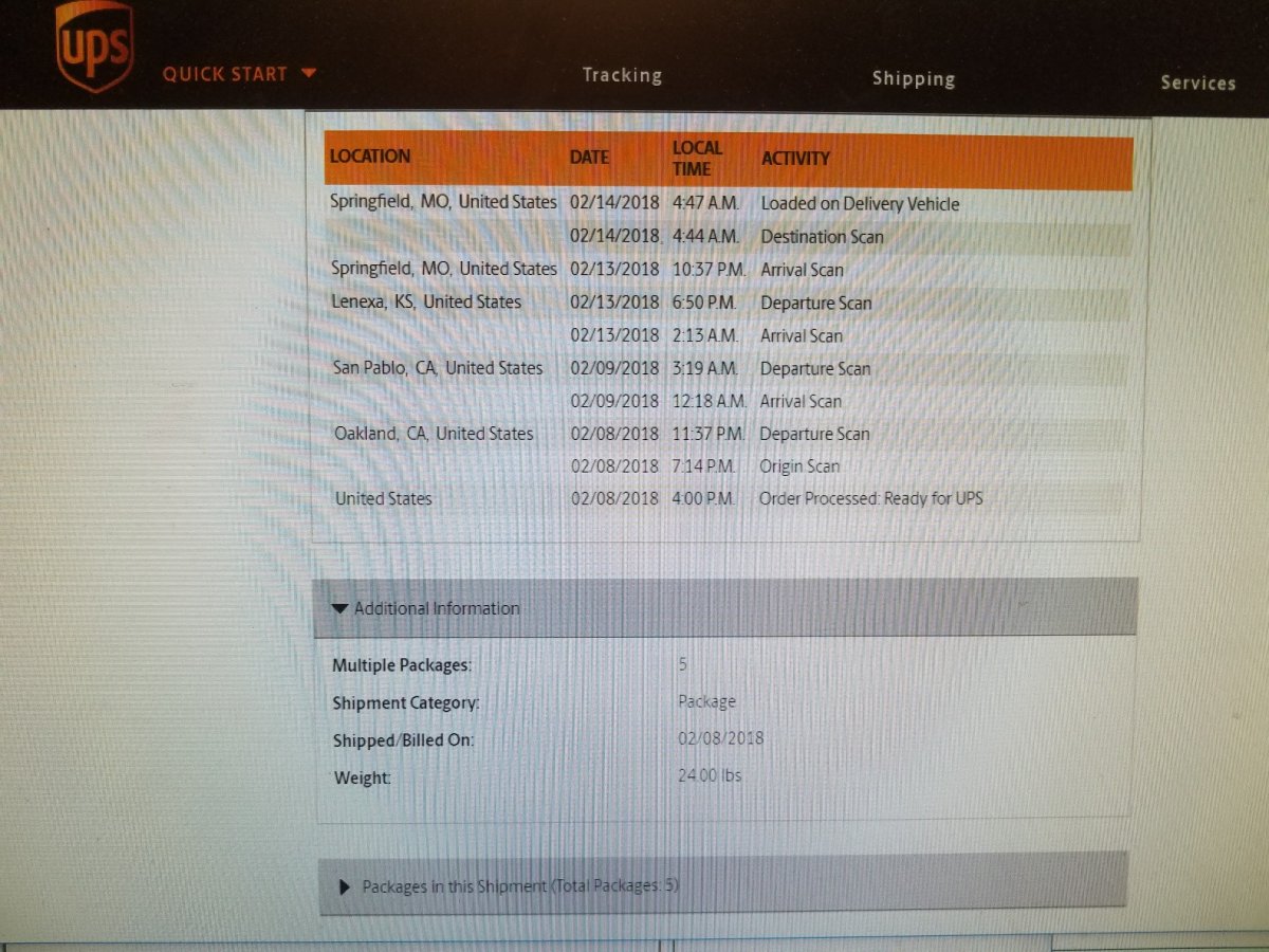

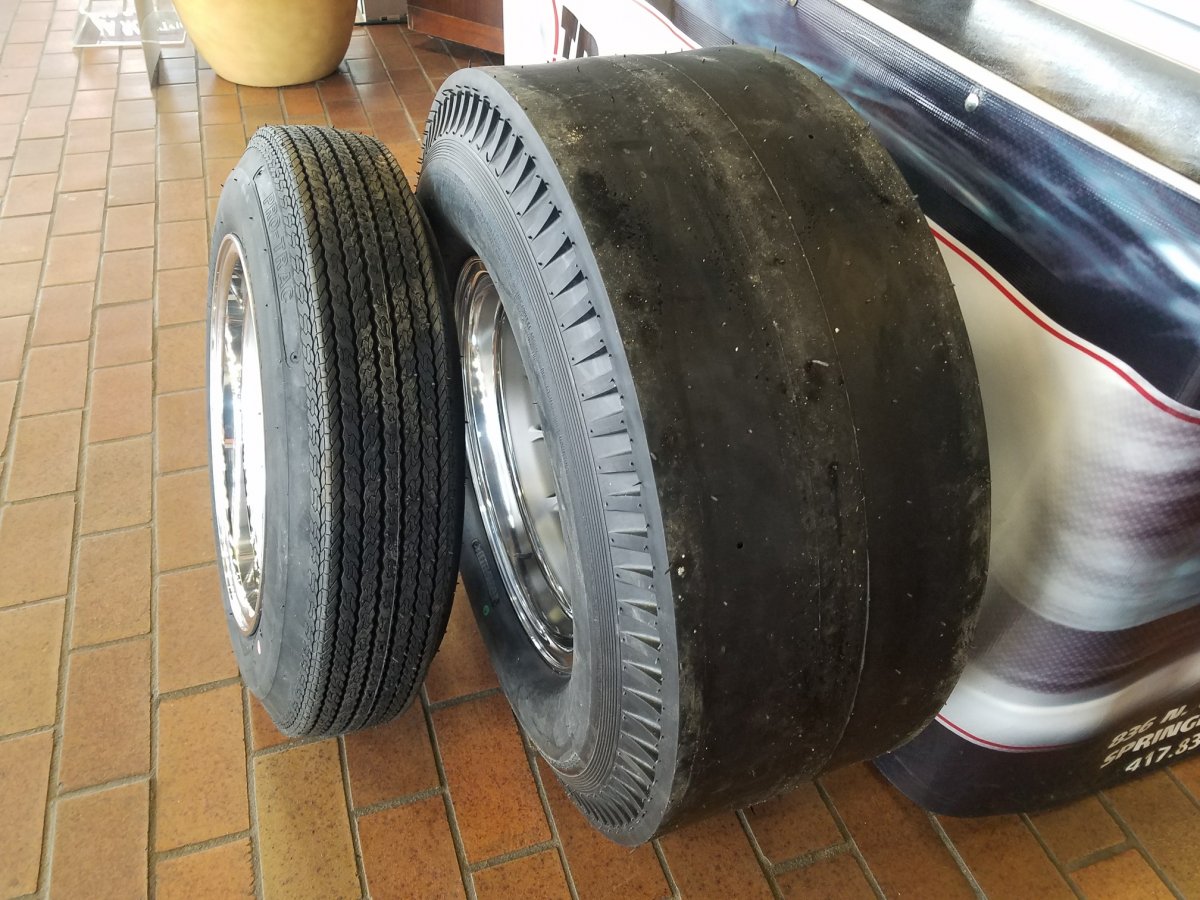

  24. Deuced Up!
    Joined: Feb 8, 2008
    Posts: 4,224
    Deuced Up!
    Happy Valentines Day to me! LOL. UPS says the wheels are in town and on the truck for delivery! I can't remember when I have been this excited. In anticipation of it, the tires are in the back of my truck ready to be installed! It is going to be a really nice day!

  28. Deuced Up!
    Joined: Feb 8, 2008
    Posts: 4,224
    Deuced Up!

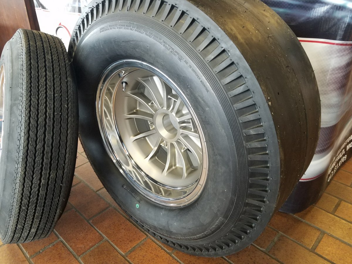

    Well that didn't take long! The rims went straight from the UPS Truck to my truck and to the tire shop down the street. ...and ****!!!
