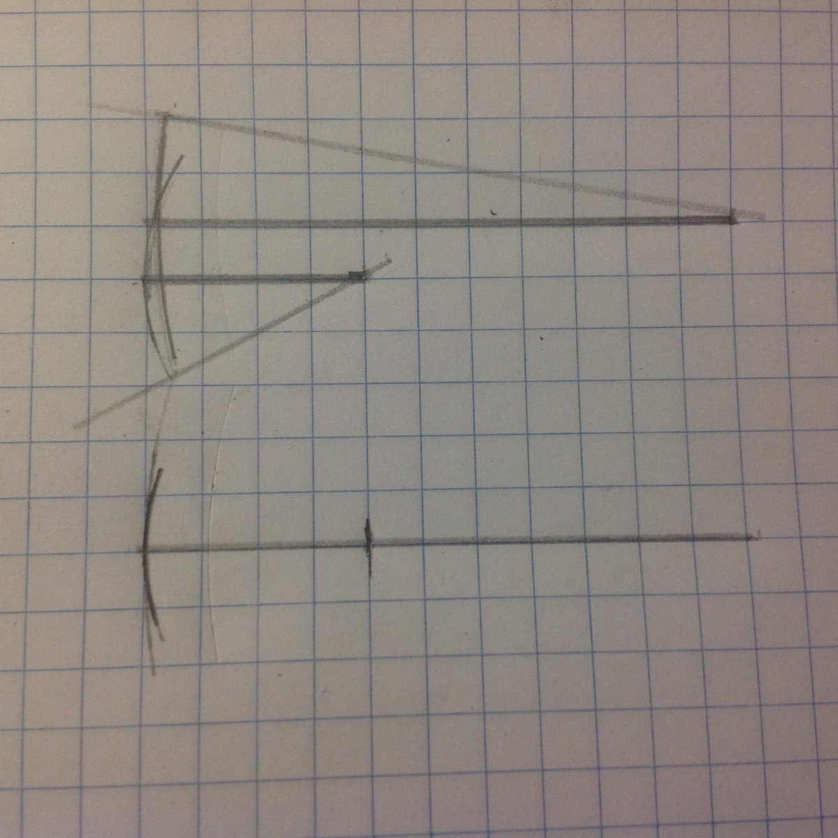

    So after talking with the engineer at SW Racing Suspensions this is what we came up with. He said cut the bushing holder circle off the ladder bar I am not using. If there is room, between it and the driveshaft go ahead and bolt it on the outside of the inboard mount I built and run it right beside the other one. After it is bolted in and we are happy, tack and then weld the two bars together for added strength. Gusset the the end where we cut off the large bushing holder for added strength at that end.
    Then run a couple of good quality lower control arm bars from the outside of the ch***is (preferable outside the springs back to the rear end tubes. Get the housing all square and wheelbase set etc. Re-position the cross member where the front of the torque arm mounts to make sure the torque arm front bushing holder is close to center on it. Then take (with no bushing in it) the cut off holder, weld it in place solid to the cross member directly under the matching torque arm busing holder. Then fab a couple holders (shackles) from something strong at least 1/4" thick plate etc. Do not make them very long (just long enough that the two bushing housing do not touch....give them no more than .25" etc. between each other.
    Install the bushings in the lower (just welded) piece and bolt through the shackles and the bushing. Then do the same with the bushing in the torque arm. Basically we just created a very heavy duty front shackle. Between the small movement provided by the shackle up front and fact that both sides of the shackled points are Neoprene bushed, there will be no lock up etc. He also suggested similar to their torque arm bracket, a simply pan hard style bar from the mount point of the top ladder bars across to the other side of the housing. Probably over kill but very simple and just some stability insurance.
    Here is what I envision:

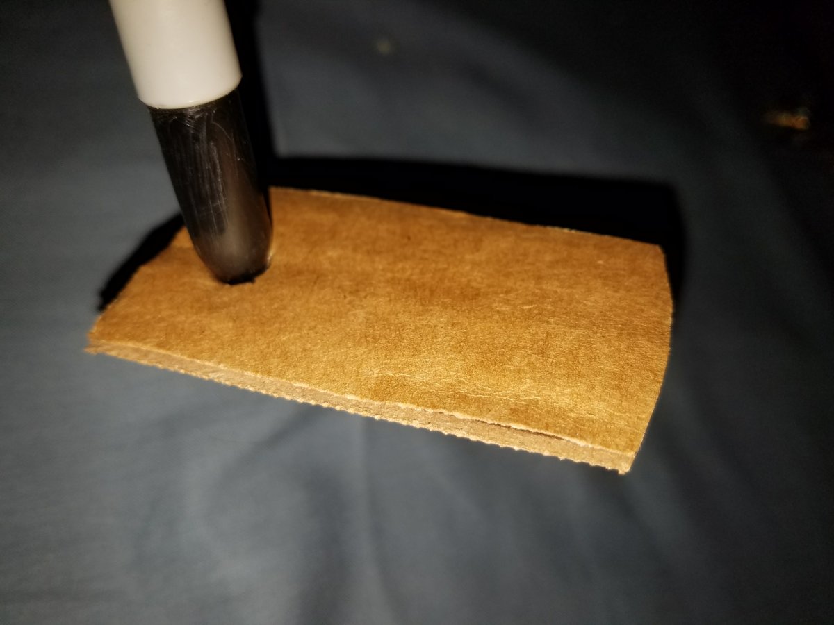

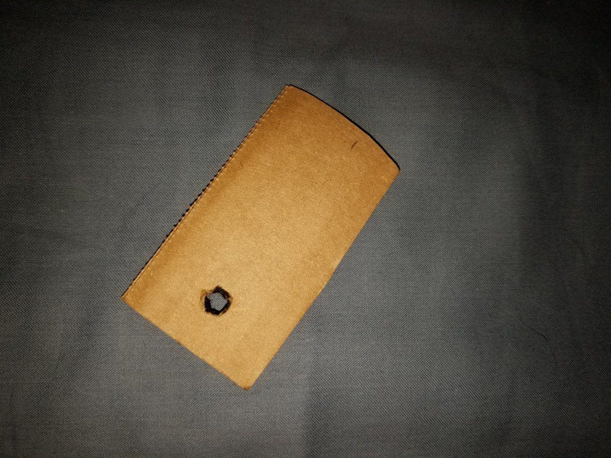

  2. Make up your paper doll mock up. Full size and see how that works. Try for press fit pins in the holes to simulate low compliance bushings

    Is that red bar attaching to the side of the frame or is it attaching to the housing? If it's just attaching to the housing I still don't see what is going to keep the rear end from shifting side to side.
  4. The panhard (or watts link) is not shown.
    I'm interested in this aspect though.

    I think that bind is alleviated by the shackle on the front of the torque arm. So you only need to worry about the Arc of the shorter bars. If I understand it right..
    Yes I would start to buy it if there is the use of a panhard rod or Watts Link in addition.

    Won't the shackle at the front mount of the torque arm make up for that?

    Do not understand what long torque bar purpose with a shackle allowing it to move fore and aft. Sure limits movement but short bars by springs already do that. Short bar on top and 1/4 spring without shackle is all you need fore and aft. Then parhard or watts side to side. Almost 4 bar with coil overs me thinks.

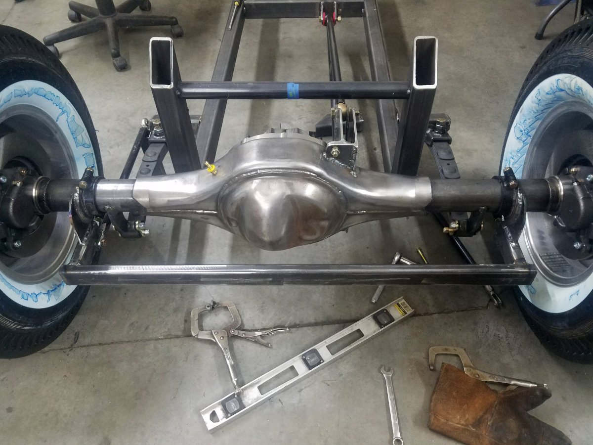

    So not a ton of progress this weekend as I spent the entire day Saturday trying to get the 327 for Dad's Coupe back together for an upcoming show. But finally by Sunday afternoon the Cobra got a bit of attention. I really do not want to order the lower bars as it will be difficult to get the exact size. Basically I would just have to orders what was offered and build around them. Which is nothing new here but I have a shelves full of previous build parts etc. So I decided to raid them a bit and see what I could come up with.
    Right out of the box I found these little beauties...I don't even remember what they were off of, I am thinking a pair of bolt on ladder bars that I cut the mounts off of and made solid etc.
    Never-the-less I decided to use them for my mount lower control arm mounts and quickly came up with a plate design to weld to them. My thought was after they are installed and we are happy, I can tac the front mount to the axle tube just for a bit of security and then bolt the back bracket half in place. This means if I ever need to remove them for some reason, just a couple of bolt and boom they are off again.
    After we had the drop down plates welded onto the axle mounts we put both sides on to have a look. While we are sitting there Dad says you know I think we should tie those two brackets together across the back. It was a very good idea because we still have a few things to bolt on back there (shocks, watts link, etc.).
    So we measured how far back from the axle bracket the cross member would have to be to miss the rear of the housing (two inches). Then the width front to back of drop down plate bracket from front to back (three inches). I took the 1x2 tubing that we have for the ch***is outriggers and made two 5" pieces. I carefully marked them and split one end 3" top and bottom with the plasma cutter removing enough material for the pieces to slide right on the drop down plate bracket. Then we took a careful measurement left to right for placement and then welded the pieces (slits up) to the same material cross member.
    After welding them up straight, plumb and solid, we took the piece back over and slid the cross bar in place over both drop down plate brackets. It took just a slight tap with a hammer to get them in place which is perfect. After adjusting both sides up, down and in etc. we finally got them in the correct place on each side and the cross bar was level. So at that point we tacked them it in place on both sides, removed the entire pieces (cross member and the back halves of the mounts) and welded them solid. We capped the ends of the cross member as well as the fronts of the split arms etc. Did a bit of quick finish grinding and took it back over. It went right back on absolutely perfect. We aligned the bold and gave both sides a little tap onto the axle tube and installed the bolts on both sides.
    With our lower control arms set in place we are ready to work on the front mount. It is going to but right up to the rear body outrigger back there on both sides. We still have some finish work to on the new cross member like a couple of gussets on the inside corners etc. But it if going to be a very solid bar and will allow us to mount the shocks absolutely anywhere across there and then also serve as the base for the Watt's Link mount etc.

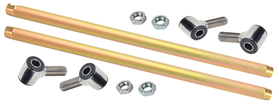

    Personally I am not satisfied with my off "MY" parts shelf answer for the lower control arms. I really want them with bushings etc. So today I broke down and ordered all the pieces I need to do it right. Chromoly 20" Swedge Tubes and Forged polished stainless 4 bar style ends. Since I procrastinated most of the week, they will not be here until Monday. But I have my hands full will Dad's rod etc. Plus I hope to finally get the wheel wells cut and the body placed so we can lock all this stuff down for sure etc.

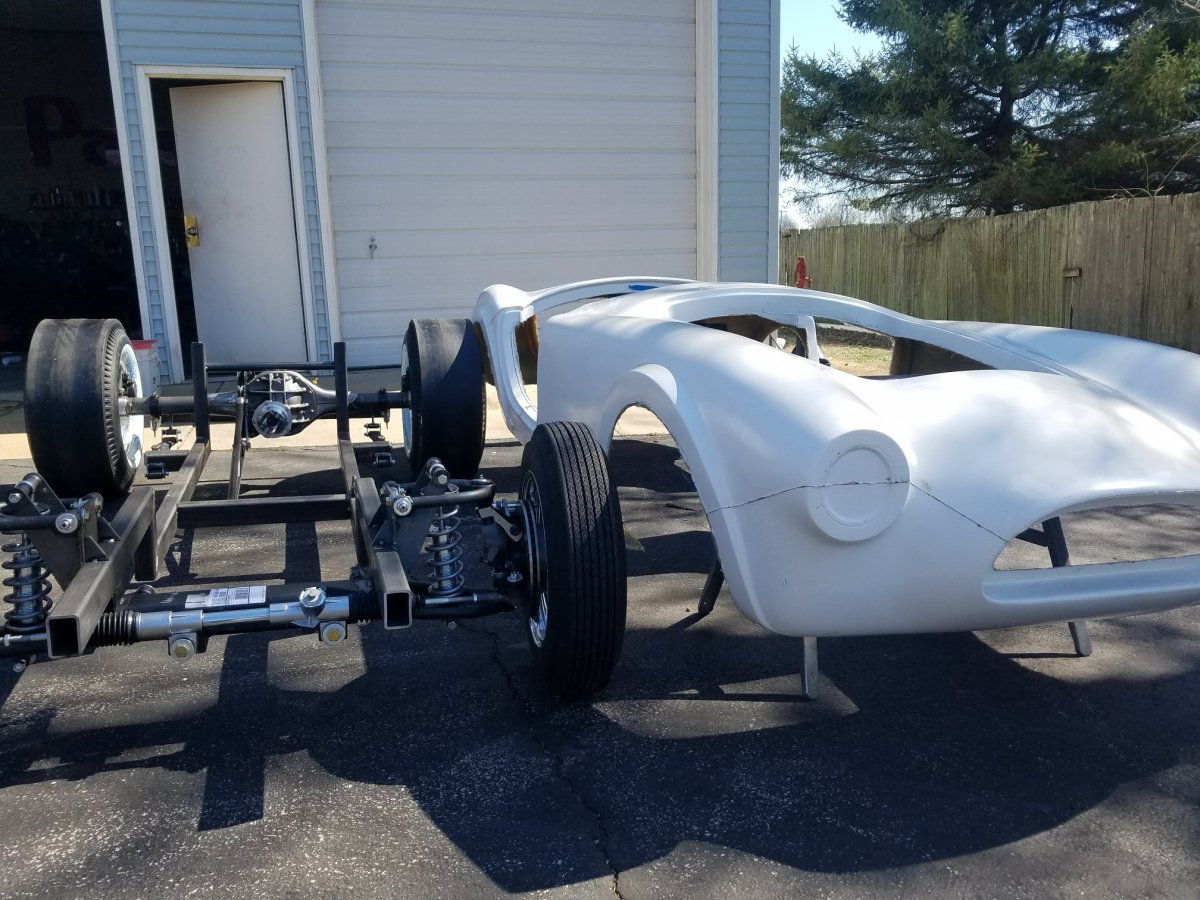

    Well we are catching some sun today. Sat the ch***is and body side by side just to get an idea. Wheel base looks perfect...
    Off to get bbq burger for lunch and pick up some blades to trim the wheels wells.[​IMG][​IMG][​IMG][​IMG]

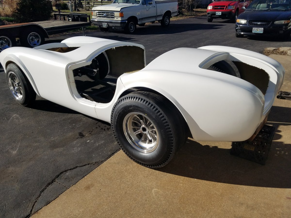

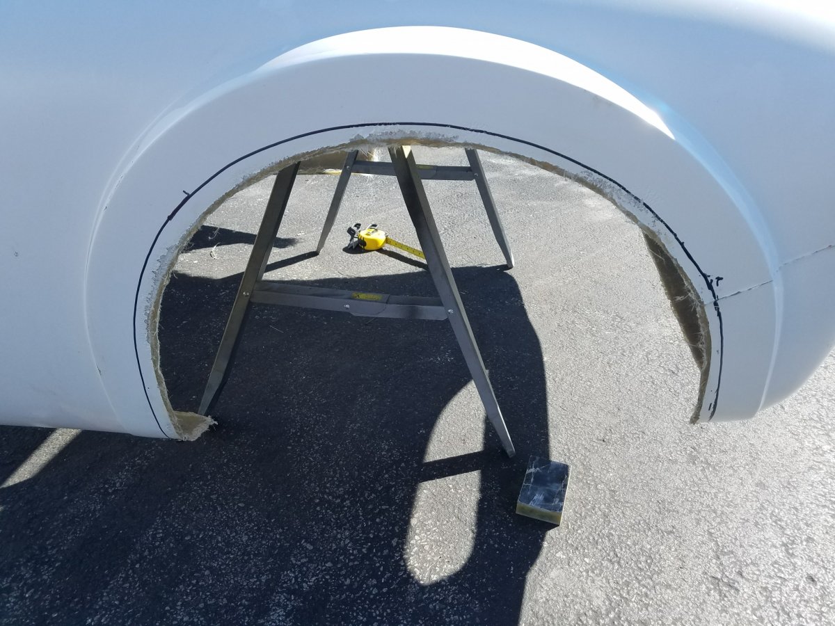

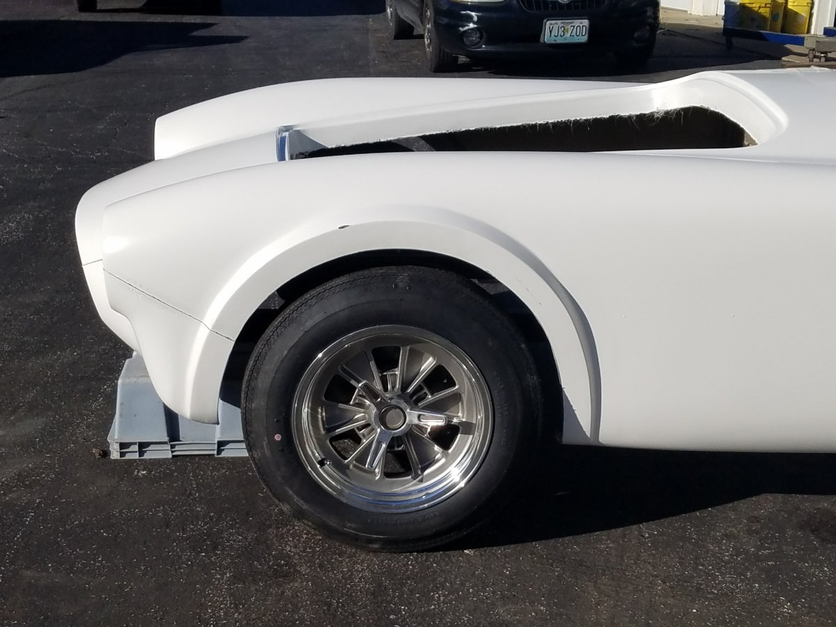

    So as you saw earlier we pulled the ch***is and the body out of the shop today but for more than a bit of sun. Today is the day we cut the fender wells etc. and it will make a much less mess of the shop if it is not inside it...LOL It has been a day that I have looked forward to with some apprehension. I mean I know it is just fibergl***, not like anything I might do is irreversible, but I would like to still get it right the first time.
    The front wheel arch will remain in tact, just taking off the over mold area. But that means creating a new line. I was not sure how to find that line. After looking at a lot of photos I finally decided the best way to find it was use the current line, the top of the slap side molded flare. I took a piece of cardboard and made a comp***.
    The top is trimmed along the shape of the upper flare lip.
    I poked a Sharpie through on the other end the same width I planned for flare side. I then carefully took the top and followed the top of the flare, dragging the Sharpie below making a duplicate line. This is the line from above on the flare and the line I cut with jig saw and a carbide encrusted ceramic tile blade. I cut a bit shy of the line so we can sneak up on it a bit etc.
    But it cut extremely clean. I cleaned it up a bit by hand with an old sponge style sanding block wrapped with 60 grit sand paper. I am very pleased with the result. On the rear, as in all the original Dragon Snake cars, we cut nearly all the slab on flare away. I used the same marking device and put a line on the rear flare about 1/2" down. Below is photo of it before I cleaned up further by hand etc.
    After the cutting we dropped the body on the ch***is to get a sneak peak of the stance and a confirmation of our measurements and work thus far. I have to say, and with as much humility as I can muster, we have one bad *** machine underway! LMAO!
    I can't tell you how good it felt seeing sit there. We must have walked around it for an hour or more just smiling and muttering to ourselves. Check out those one off front runners sitting perfectly right where we planned. Actually I can't really say that because even though I dreamed of them, I never imagined how amazing they could be in person.
    Nice fit. Very nice fit. Wouldn't you say? LOL
