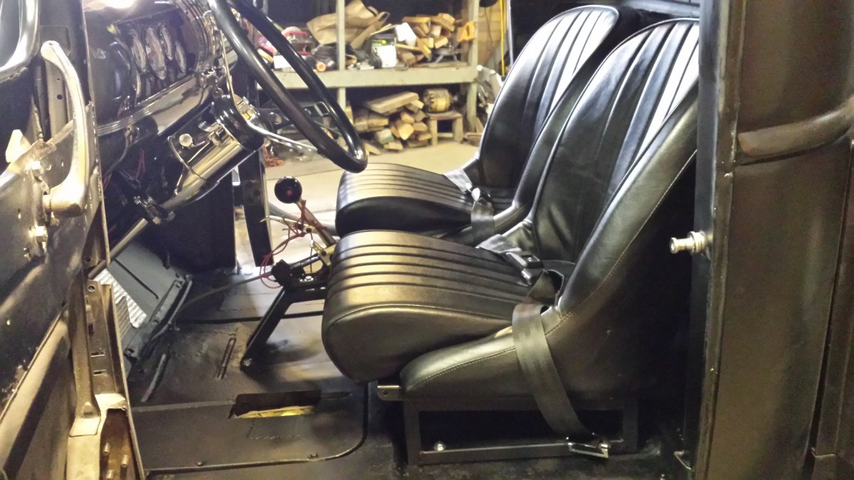

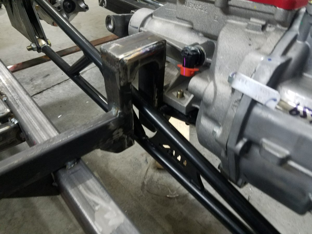

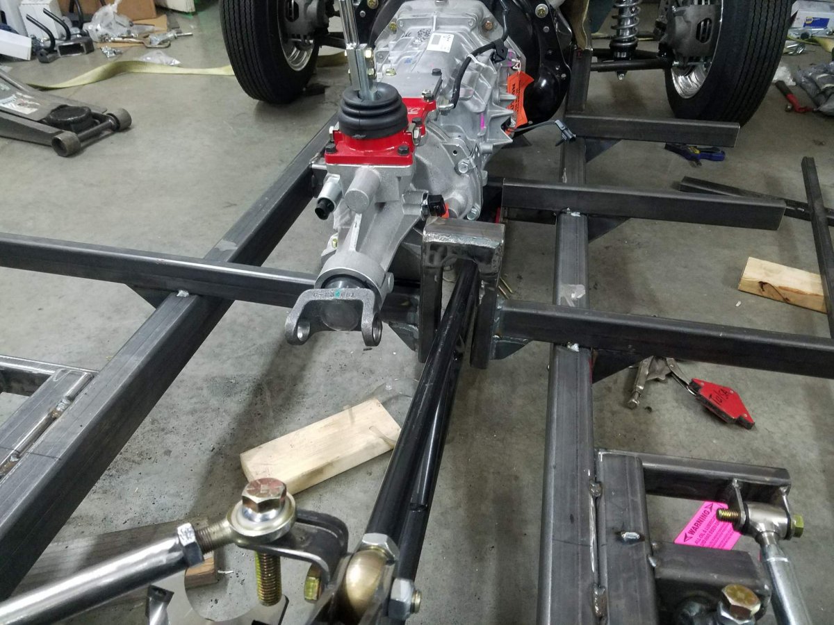

    Well pretty long weekend and really not a lot of photos to show but I will update you. So she is totally standing on her own this morning after we fabricated motor and trans mounts. We had to adjust the front coil over up about an inch to get her back to ride height after the ch***is finally had the weight on it etc. We just took a guess at it and got pretty darn close. Probably another half inch and we will be back where we started.
    Then engine mount is just roughed in, I will be cleaning it up, cutting some groovy curves in it and some holes etc. But it is what it is...a piece of angle iron and piece of the frame rail material. But it will be strong.
    I guess I will show you the trans mount as it was quite a feat of engineering although this morning it is all sitting in the s**** pile LOL. We couldn't go straight across the ch***is because of the torque arm so we had to come up with something that when it got to the arm it either went over or under it and then back to the frame rail etc. Since above would be in tunnel, we went up and over.
    So yes you heard me right, it is all on the s**** heap this morning. So here is where the photos get scarce. Basically because it was crazy busy and I got slightly hacked off about it the end. So our transmission mount was basically one of our body out riggers. After we had it in place and the ch***is standing on its own, I made quick work of the rest of the outriggers and cut and tacked the tunnel together with lighter 1" square tubing. Then we put the body back on and the outriggers were dead perfect, we could have mounted the body at the lower points with no changes etc.
    However when I dropped the seat in it was little cramped. Not that expected '65 Caddy spacing or anything but it was unnecessarily too tight. That was not a big issue on the driver's side as I had plenty of room between the trans/drive shaft area and my newly ***embled tunnel framing. I could easily give myself several more inches there. However, it was going to be a huge issue on the p***enger side because of the torque arm in the tunnel. At that point, with no changes, I had twenty inches on my side but because of the torque arm, there was only 19 on the other. I contemplated just going forward with one seat (after all it is a drag car right?!!) but alas I have had several people already clamoring for rides so I guess I need to fix it!
    So I popped the entire tunnel out and "temporarily" tossed it on the s**** heap. It is not total waste, we will probably use 50% or more of the pieces when we re-fab the tunnel. So what to do with the torque arm is the problem we sat and contemplated last night till pretty near dark. The final decision?......the torque arm has to be changed. I saw no other viable option other than changing the design of the torque arm. I mean it is just as well, as you know it was just one side of a set of ladder bars anyway. The real question was could we pull that off without changing the mounting bracket etc. OR at least making the least amount of changes etc.
    So this is what we came up with last night. The top view is the original torque arm and mount etc. Note, remember at the top mount point up there, we also have a cross bar for stability. So we basically cut all the center supports out of the current bar and ground what was left down smooth. Then we clamped the bar in the vice and started compressing it closed. At around the 1.75" closed area through the middle. I took a piece of poster board and traced out the shape of the center area. I plasma cut the shape out of .25" plate, inserted it and welded it solid.
    So we drilled a new hole for the new bottom mount and just for grins and maybe some stability I added an up bar there which required a new mount hole as well. The cross bar mount will stay in the original upper hole mount with a bushing between the mount plates etc. The extra holes were planned anyway to strengthen the bracket but now instead of having a bushing in them they are functional heims end mount points. Over all I think we are in good shape with a minimum of edits etc. Now the entire torque arm is below the frame and has plenty of clearance as the ch***is moves etc. This frees up the entire area to the side and aft of the trans to shrink the tunnel and make sure both the driver and p***enger are nice and comfortable etc.
    And as I said when we started, the change also allowed us to toss the crazy fabricated bridged transmission mount system for something much simpler and more pleasant to look at...LOL!

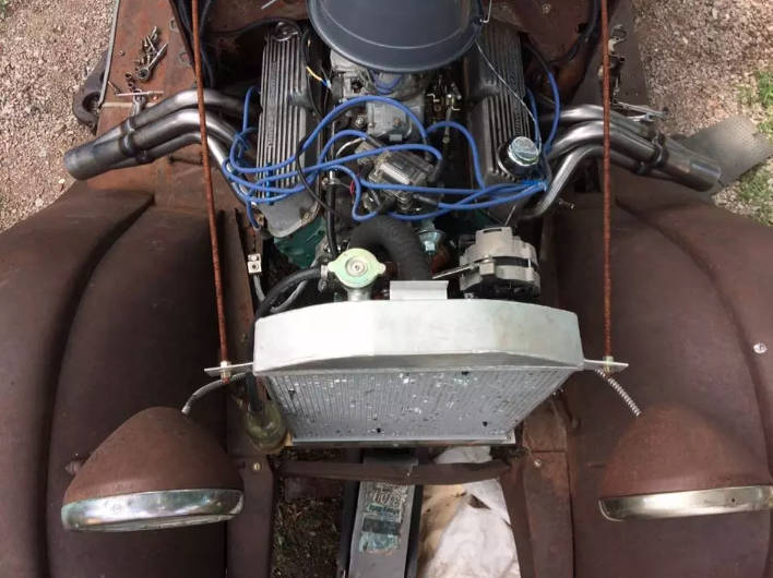

    I am pretty excited this morning because I think I have my header issues worked out. You see there are several companies that make SBF headers for Cobras but they are designed, measured and pointed to exit just aft of the front wheel well through a notch cut in the body. The Dragon Snake Header exited in the same general area but under the body (no notch). And of course they were not side pipes they simply look like a header hung out there. So early on I was looking at and comparing measurements of these different headers but to be honest it was just a gamble as to whether or not they will fit. AND a certainty that we will have to modify them for an under body exit even if they do.
    So decided to have a set fabricated. I think I mentioned earlier that I snagged some stainless steel header flanges and was prepared to have a local guy build a set for me. But while I was messing around this past weekend with the firewall and tunnel placement etc. it was obvious that we should have the headers in place and work around them versus trying to fab them around my stuff later. So just for grins last night I started googling SBF Headers and one set actually caught my eye.
    First off they are for a Modified Dirt Car. But what grabbed my attention was the fact that basically shoot straight out from the center of the block. That is what I need. I figure if I am going to have to modify a set anyway these would be perfect. So I chased down their home page and started reading about them. They are from Schoenfeld Header (sort of the go to brand in the stock car world). They are raw finish so easy to modify etc. They are 1.63 tubes with 3" collectors. But then I started reading the customer responses at the bottom of the page.
    One of the first entries said I actually used these on my Austin Healey SBF v8 converted car and they fit like a glove. Now you have my attention. Then right under it was this photo of a hot rod and the entry said something about spark plug clearance and the fact that he cut the cross bars on the flange and installed them upside down. Take a look at the photo he supplied...
    From that photo I did a bit of scaling based on the width of the engine and in my opinion those crazy things are pointed right down almost exactly where I need them. We shall see. They will be here Friday!

    from Berry, AL
    How did he do that, SBF exhaust bolts aren't in the center of the port? Turn them upside down and you'd have 1/3 of the port uncovered.

    I believe the exhaust bolt pattern on stock Ford heads are diagonal but some of the aftermarket heads (Dart/World/AFR) are horizontal across the center of the ports.
