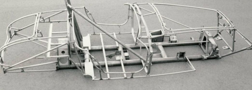

    So here is an original style space frame cobra ch***is.
    I am pretty sure we will build our own.

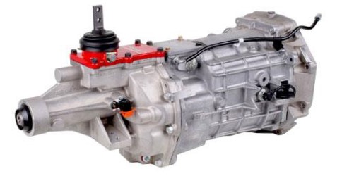

    I have been looking at transmission choices for the little snake. I think I am going this direction for several reason.
    This is the Tremec Magnum 6 Speed with dual placement shifter. Sort of high tech but it will be all be hidden. It has an optional gear ratio that I really like: 2.97, 2.10, 1.46, 1.00, 0.74, 0.50. I think the original DragonSnakes were in the mid 4 range on the rear gear. I am doing the math now but I am thinking 4.11 out back may be the ticket. We shall see. The two overdrive gears should make it very highway friendly and that is one thing we are not going to mess up this time (scope creep)! This car is going to be driven, not drug everywhere on trailer. The cool facts about this thing are it is good through 700 hp, can easily handle as high as 7,500 rpm shifts, and it is a proven unit. Certainly the way I am leaning anyone have other thoughts?

    Here is the gear ratio formula that you can use several ways etc. rpm = (mph x final gear ratio x 336*) / tire diameter. Basically if you know any 3 of the numbers above you can figure the 4th. LOL
    Wondering how accurate it could be? Well the Austin ran a very consistant 144 mph out the back gate. It didn't matter if we ran 9.50 or 10.50 et, if she was rapped out in 4th by the finish the mph was 144. (7,000 rpm was my shift point so 144 mph with my configuration should = 7,000 rpm)....lets check it out!
    (mph - 144) (Final Gear Ratio From Below In 4th - 4.305) (Tire Diameter - 30) SO....
    rpm =(144 x 4.305 x 336)/30 Formula says rpm was: 6943.10 Pretty Darn Good!
    My Doug Nash with 3.50 Rear Gear
    1st:. 3.27 Final Math 11.445
    2nd. 2.14 Final Math 7.49
    3rd. 1.5 Final Math 5.495
    4th. 1.23 Final Math 4.305
    5th. 1 Final Math 3.5
    Tremec with a 4.11 Rear Gear
    1st. 2.97 Final Math 12.2067
    2nd. 2.1 Final Math 8.631
    3rd. 1.46 Final Math 6.0006
    4th. 1 Final Math 4.11
    5th. 0.74 Final Math 3.0414
    6th 0.5 Final Math 2.055
    So using that same formula numbers from the Tremec etc. 130 mph with 4.11 gear and 29" tall tires would be just a tick over 6,000 rpm in 4th gear. In a perfect world in 5th gear 70 miles per hour will be 2467 rpm and 6th a mere 1667 rpm. With no wind...lol and a long enough road and big enough (well you know whats) 6 grand in 6th gear is over 250 mph...

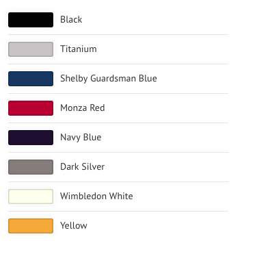

    Boy I am going to catch hell for this. It took a while to track down the actual "Cobra" color I am looking for but I just found the paint code and you are not going to believe what it is called: "Princess Alice Blue" ....nice.
    els, kidcampbell71, loudbang and 2 others like this.
  24. Deuces
    Joined: Nov 3, 2009
    Posts: 26,687
    Deuces
    So, let's see the color please.... Gotta paint chip??? :)

  27. Deuced Up!
    Joined: Feb 8, 2008
    Posts: 4,224
    Deuced Up!
  28. Deuced Up!
    Joined: Feb 8, 2008
    Posts: 4,224
    Deuced Up!
    Actually I think I am wrong. Especially knowing the first 100 cobras were either black, white, or red and Black is not on that color wheel from AC. I believe the color chips above are for the Ace Bristol and not the converted Shelby Cobras. It appears below may be the actual color options.
