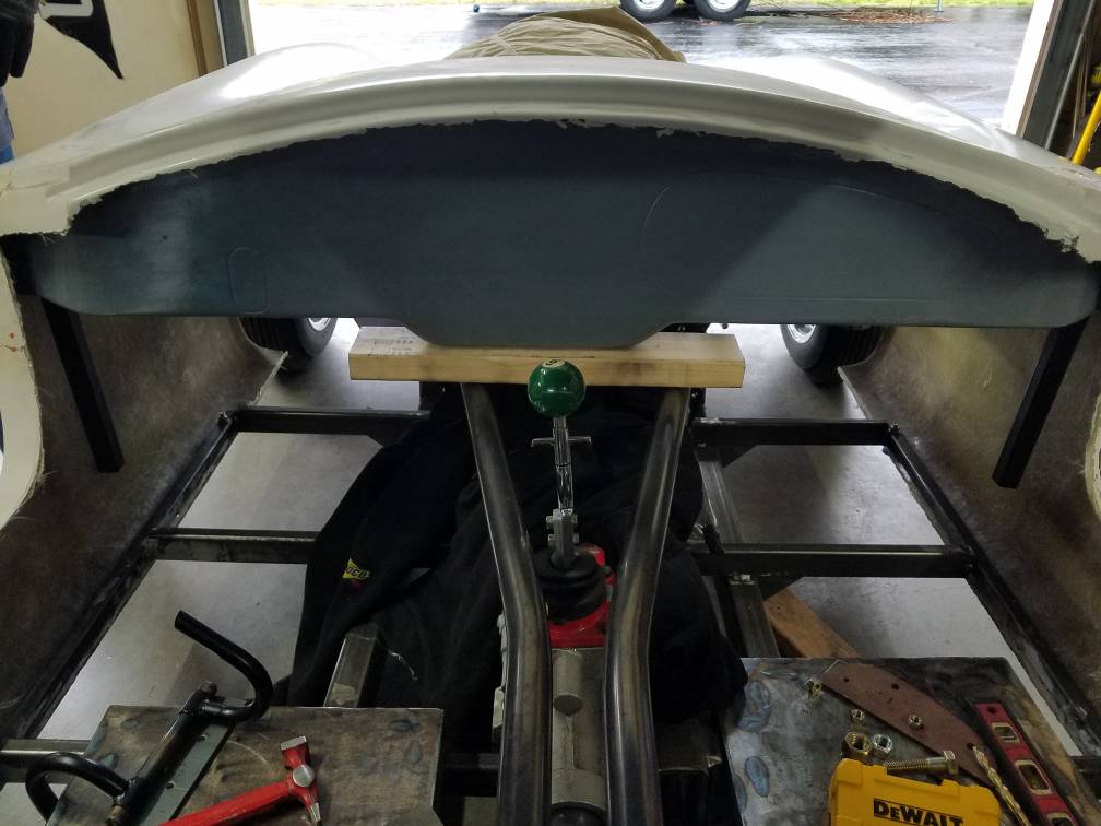

    Hope you don't have big feet . It looks like your foot boxes are going to be tight once you get a trans tunnel in there. Working on that issue putting 3 pedals in my small block Ford powered Morris.

    Believe it or not I have a ton of room in there. I think I mentioned it before but there is more room here than in the Austin and twice the room from the Model A. I think it is in part to the Tremec being narrow. However as the Dash issue earlier pointed out, there was not much room in the originals because the tunnel was left alone, stilled skewed to the right hand driver side. Drop in a BB Ford and I would imagine "toe" shoes from the ballerina world would be in order. LOL

    I have plenty of room in the foot well for either floor mounted or hanging pedals. I have had both. The last two cars were polar opposites, the Model A had hanging and the Austin had floor mounted. I think I prefer hanging, something about the motion of the floor pedals in the Austin bothered me (at least at first). However after launching the crazy thing I always had more to worry about than pedal motion etc. LOL! Either way, I am going to go with a remote filler system for both the brakes and clutch master cylinders. So that is not a concern. I am wondering if the more reclined seating position in the Cobra will lend itself to one or the other of the systems?
    loudbang, Sancho and enloe like this.

    squirrel
    I think either will work ok, but getting the pedal pivot point in the right place is very important.

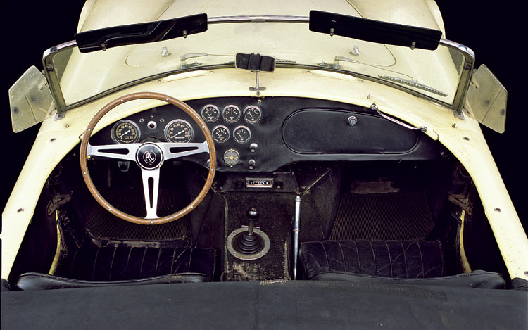

    Deuced Up!
    Yep...looks like I am pretty darn close (talking about the original ****pit being offset to the left a bit). I stumbled across that perfect photo this afternoon and sure enough...there it is! LOL
