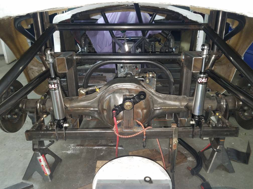

    We also finished up the shock upper mount points on the end of the rectangular frame rails.
    Thor1, Swamp Rat 4, 55Deso and 3 others like this.
