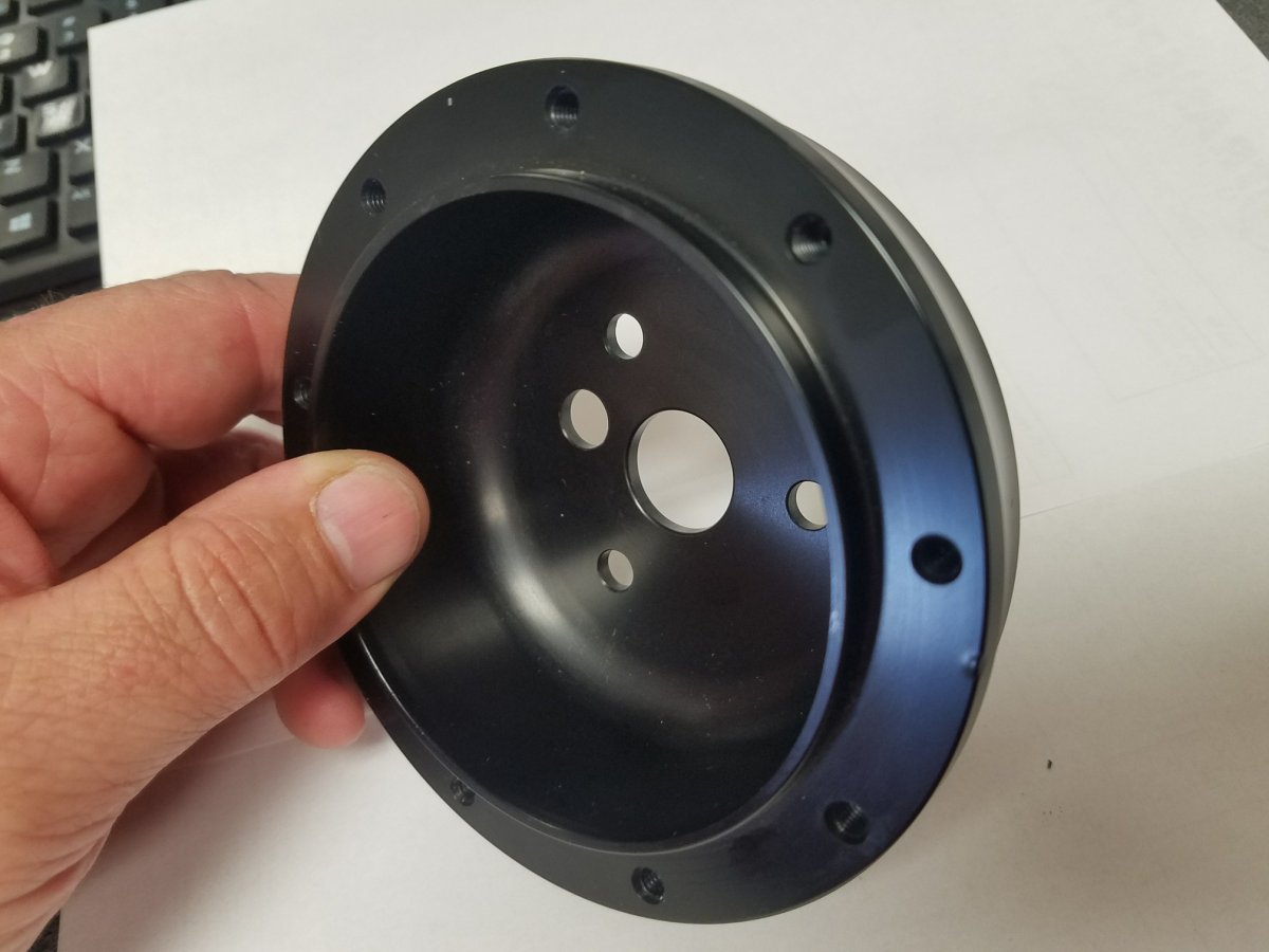

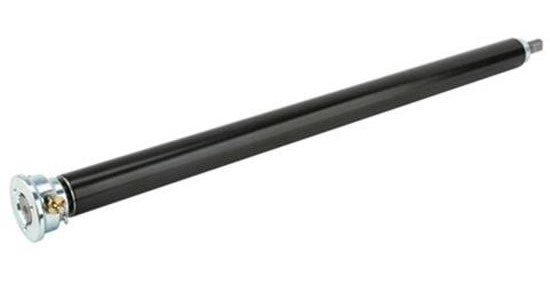

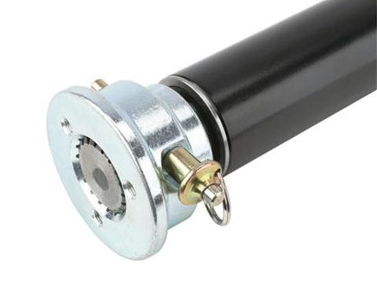

    This weekend we also decided to install the steering column. To do so we have to have the dash in place as the column p***es through it. So we popped it in place, drilled the hole for the column and with the steering wheel installed and me in the driver's seat, experimented with the angle and placement. While I was sitting there it seemed like a good time to make decisions on gauge placement.
    Now I know the stock orientation was tach on the left of the wheel and speedo on the right and then the smaller gauges in the center console. But that is not very useful. The tach (the one gauge I would be watching the most) is going to be nearly impossible to see, stuck over to the left half hidden by the curve of the dash not to mention the steering wheel. But then I "Googled" Cobra ****pit and saw several (likely 427 cars) that had the tack in the center...I liked it!
    Dad liked the idea of breaking out the spray can of 1964 Ford Viking Blue Metallic the paint shop mixed up for me and shooting the dash! We will likely cover the dash in black vinyl with a thin pad but for now nothing wrong with shooting some blue!
    As eluded to earlier however, he would have to wait as after drilling all the holes (even though we checked to make sure they would clear) there was an issue. As we slid the gauges in for a quick trial fit, the stupid speedo clipped the roll cage upright that connects the tunnel area to the cowl hoop. We messed around with it for a while but alas took it back out, laid the drilled out circle piece back in its hole and gl***ed it all back in from the back side. A little Bondo and some elbow grease and we were back where we started earlier in the day.
    By night fall Saturday, the dash was painted, had cured for a bit in the sun and was back in the shop.
    We rolled the Cobra out to catch some rays this afternoon. While it was out we decided to install the dash for a little sneak preview etc. of the Holman Moody gauges in place.
    Plenty of room left for the ignition, starter ****on and a few toggles across the bottom under the tach...

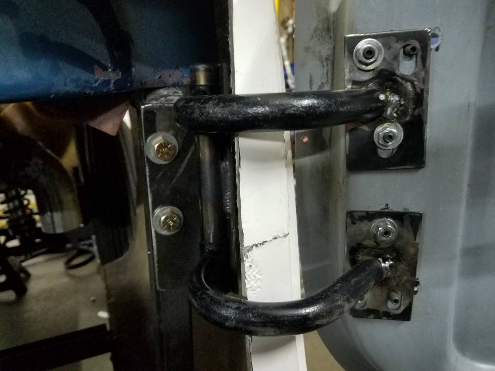

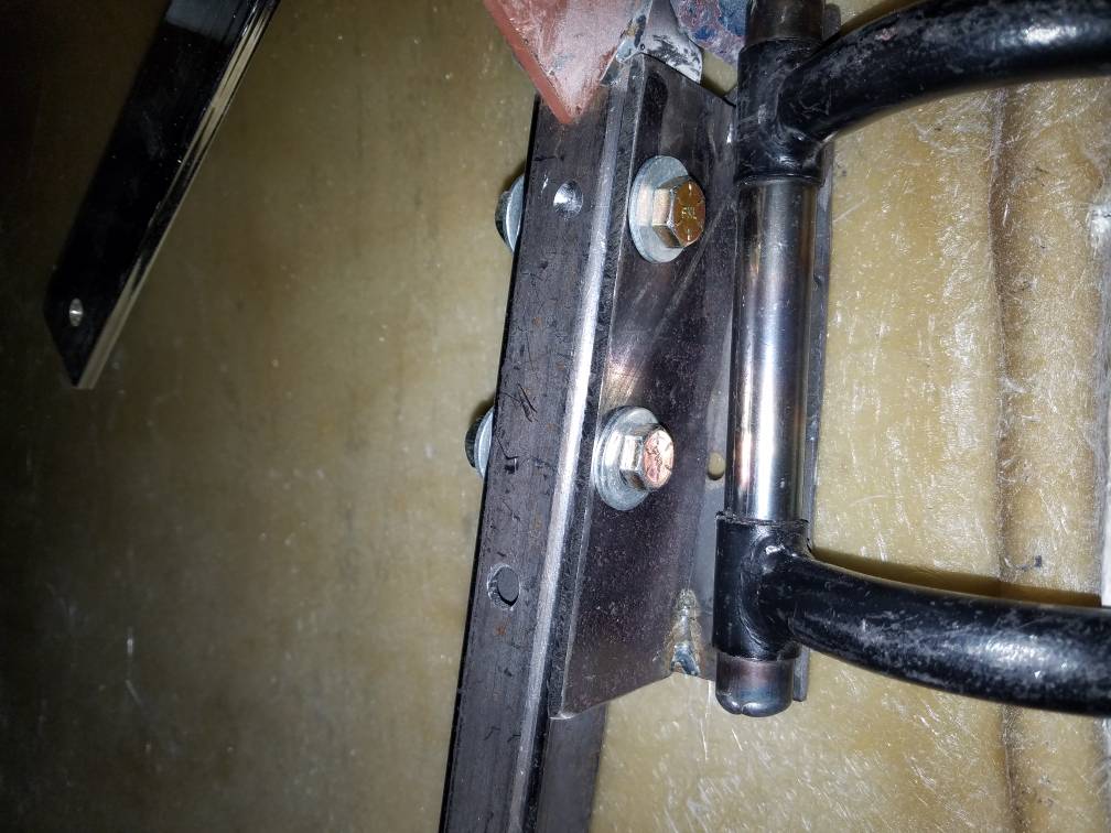

    So we move on to the door. Now you have seen the p***enger door inner skin in place but it was not perfect. It was clamped there pending further adjustments.
    It opened but it still had a slight rub at the front area. So calling on our vast library of hinge installation knowledge (lmao) we set about to fix it.
    The issue with the rub can only be fixed by pushing the hing point deeper into the fender area in front of the door sill. Current it is too shallow so instead of opening freely it opens into the front fender etc.
    The only issue is where the hing has to go is no man's land in there...nothing to mount it or clamp it to etc. So we basically had to hold the hinge in the air, clamp a perpendicular plate to the cowl hoop and Mark the hinge mount plate to know how to weld the clamped plate
    That was complicated enough to try and explain let alone accomplish...but when complete the hinge and door were in place and can easily be remove by two very accessible bolts.
