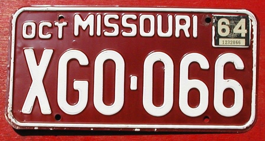

    Well I finally decided on a license plate for the Cobra. I have been toying with a custom historic tag like the Austin's AA GAS but to be honest just about everything you can imagine surrounding a Cobra tag is unavailable. Between all the Cobra Replicas and Mustang Cobras etc. It is pretty hard to think original in that world...
    The other thing I have been considering is a vintage 1964 MO Tag. Actually in Missouri that plate came out in 1962 and then for several years just got a sticker placed on it with the year. I felt like that was an advantage (especially being in the business I am in...I figured just snag a plate in that year run I liked and create a replica 1964 sticker to place on it etc. Now there are lots of them out there but to me honest I guess I was looking for something that meant something to me in the numbers and letters.
    I have been looking for it since the body arrived in January. I have seen hundreds of tags that fit the bill but nothing really tripped my trigger so to speak. Then a day or two ago while re-checking the online inventories I found this one.
    I don't know exactly why but it just felt right you know. First off it is an October Plate which is my birthday month. It actually is a real 1964 plate. And I like the number: XGO! I mean all the real cars VIN started with CSX so the "X" is cool. Then how can you go wrong with GO! Right? It even made me think it represented a former fast car as in "ex-GO"! It has a 66 which could easily be a year a Dragon Snake raced...probably a total over ****ysis on something as insignificant as a stupid plate...but suffice to say for what ever reason it just felt right when I saw it. So there you XGO....that is the plate.

    Even better, that configuration is currently available for a YOM registration. Get your app in!

    I know, I checked before I bought it. They will not allow me to apply for it until the car is ***led and registered etc. I tried to get them to just let me reserve it but no go. Oh well, pretty good chance it will be around when we are ready...LOL

  22. Can you register that as a ‘64?

    You know "cactus" that is a really good question. I had not even thought about the official date that will have to go on the car according to the State of Missouri. I will have to ask. I may need to find a 1964 ***le of some kind and claim a large percentage of car was built from it etc. But that raises all kinds of issues though. If it even could be registered as a 1964 vehicle, who has been paying the taxes on it for the past 54 years?!
    Something similar happened with the Austin that had not been tagged since 1962. I thought I was in trouble with it as it had a signed ***le from 1976 that was never processed. I can not remember how we got through that but one big difference was the Austin really was a car manufactured in 1953! I bet you are right, it is going to be registered as 2018 (IF WE ARE LUCKY AND GET IT FINISHED THIS YEAR...LOL!). That likely puts the "Kabosh!" on officially having a 1964 plate ***igned to it.
    Great! ...Way to go Cactus...you have ruined my license plate day dreams and meanderings. LMAO!
    So anyone got a really cool 2018 tag I can buy! LOL!

    Well I AM sort of a wizard sometimes. And since the post I think I may have actually done it. I can't say how but it looks to me like we are about to be able to legally wear that recently acquired 1964 MO Plate...LOL!

    Send an email to mvbmail@dor.mo.gov and ask about the process of ***ling a "replica motor vehicle". Also ask if a replica motor can be registered with YOM plates. I'm pretty sure they can.
    When you go to ***le it, you'll be expected to prove where the various components came from, and whether sales tax has been paid. So be sure to keep track of the components you've purchased through detailed receipts!
