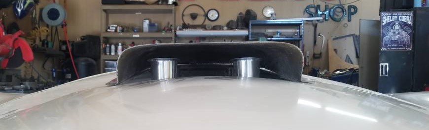

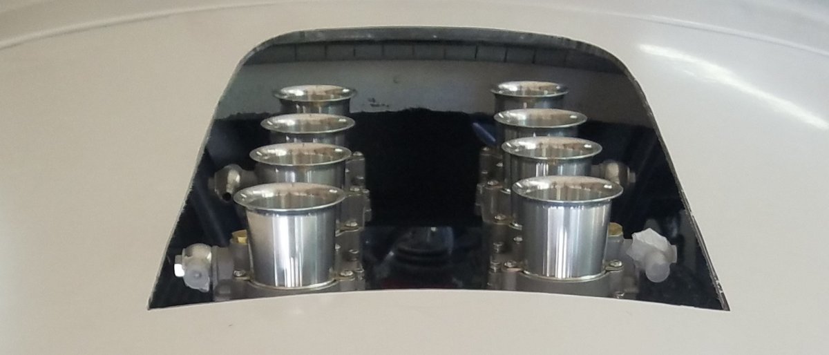

    One of the last tasks before removing the body is cutting the hole in the new outer skin and making sure things fit. In the limited shade beside the shop we measured twice, marked twice and cut once!
    Then we installed the hood, crossed our fingers and closed it! Like a glove baby! But we are only halfway home. Will the new taller hood scoop clear the Webers?
    Survey says? .....Yes!
    Plenty of room to breath. And after holding our breath for a bit...now we can breathe too! LOL

    After finding out for sure the Webers weren't ****ing on the bottom of the scoop...LOL...I decided to check the original 289 scoop that came with the car. I read some where when the cobras ran the Webers carbs they had to have a taller scoop. Later on I understand they used the 427 scoop??? So I sat the original scoop on there and sure enough, it just sat on the top of them and then still missed sitting on the hood by a good .75"!
    We did some t******* to clean up the new scoop. Trying to decide if we want to rivet the unit in place (as the originals were) or if we want to use some small bolts to allow us to remove the scoop in the future if we needed or wanted to etc.

    Did you consider cutting the shorter scoop so the tubes fit tightly out the top, could look drag racy ???
    chryslerfan55, loudbang and saltflats like this.
  19. Deuced Up!
    Joined: Feb 8, 2008
    Posts: 4,224
    Deuced Up!
    We actually did consider it. Dad mentioned if neither of them fit that we might need to cut holes in them and expose the Weber throats through the scoop. ....AND it might have looked cool if things were on more of a level surface. But with the engine tilting down a bit towards the rear and the drastic drop in the hood from the cowl down to the front, only the first set set of them and a small bit of the row two would make it up and through. The rest would just be empty holes. Fortunately though the taller scoop fits.
    The one issue I have with it is the lip is very thin (too thin). When I say lip I don't mean the part that gets riveted to the hood but rather the leading edge. We are going to address that before we install it...sort of beef it up. Right now it is about and 1/8" thick, I think we need at least 1/4" or so to make it look right.

    Some small diameter copper tubing is easy to form and could be fibergl***ed to that edge easy enough.

    Actually the leading edge was too long anyway, as you might have noticed, sort of angled forward too from the hood up to the leading edge of the scoop.
    So we marked it at a straight across point (much more Cobra like). Then before cutting the leading edge off we marked it about .75" forward from the final proposed line.
    After carefully cutting both lines, I had a small toss away end piece, a .75" wide strip and the rest of the scoop that now looks correct. Then we took the strip and bonded it to the under side of the scoop right at the leading edge...
