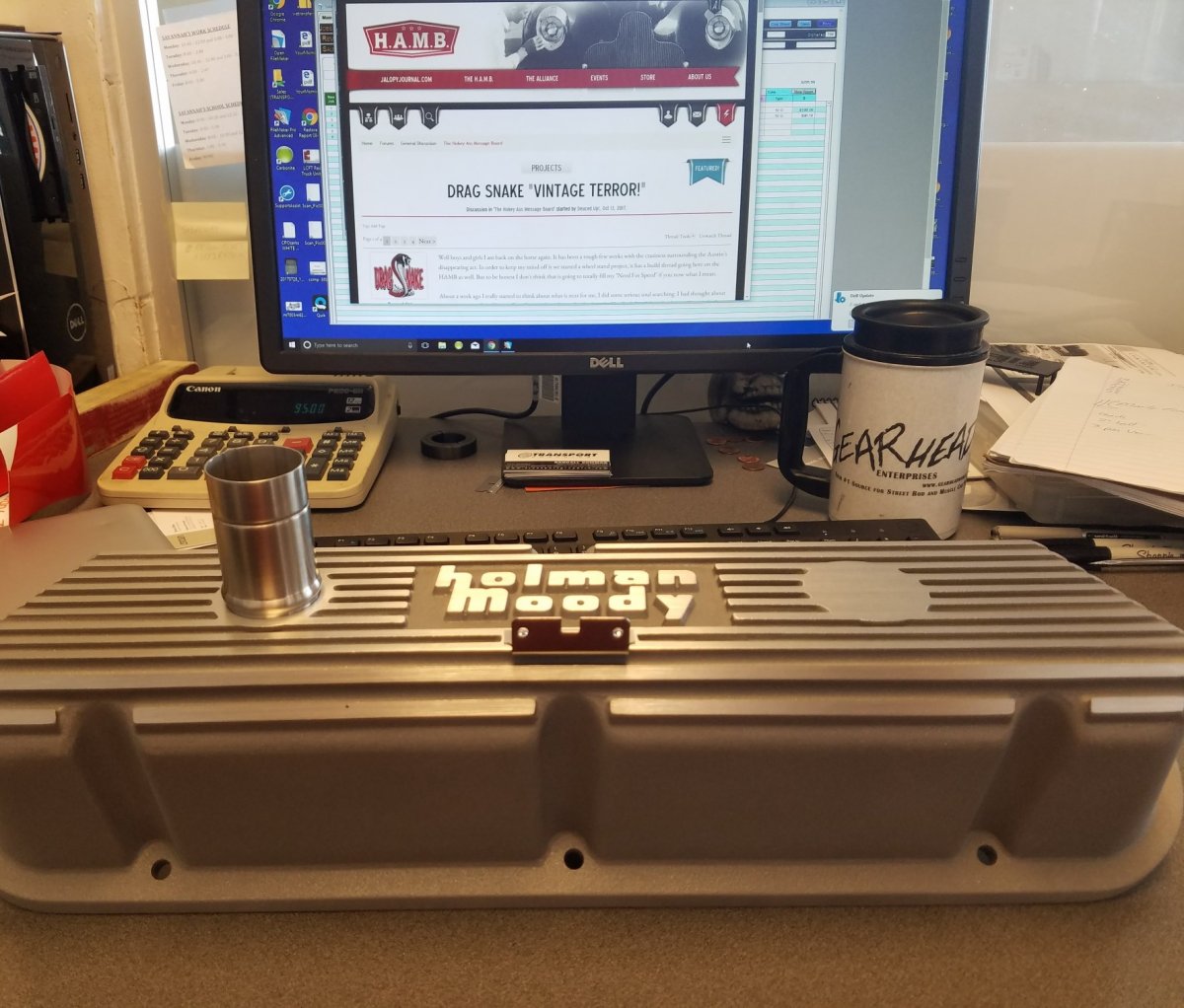

    Well my premature valve covers arrived today but they shipped me the wrong ones. They were supposed to be the black crinkle finish but after seeing these just "natural" finish, I think I like them better....happy accident!
