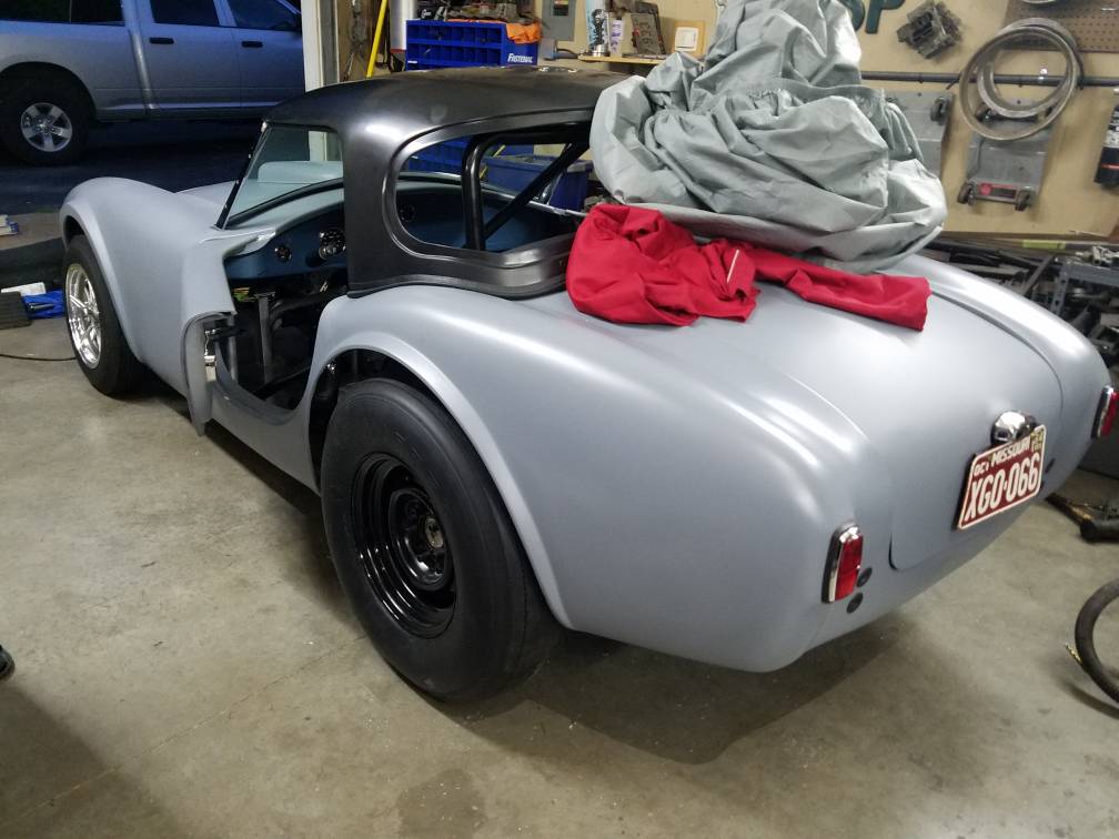

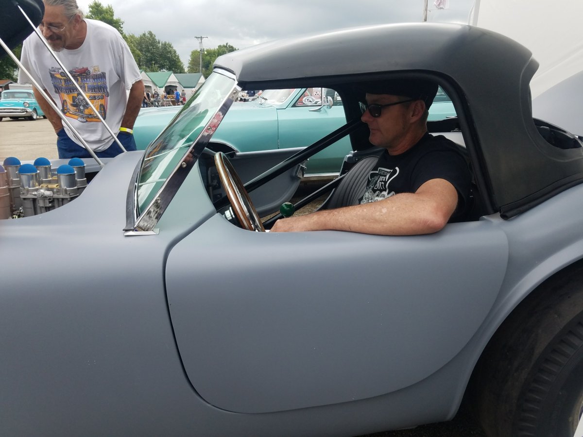

    Sort of comical but hard to laugh at with all the time we spent on the theory of hinging the crazy roof for an easy entrance and exit. But last night I climbed in the car for the first time since we put the floor pans in it. I know that is hard to believe but we were so goal oriented to make it to the Meltdowns that I just didn't have the time to try it out. The real reason for the effort is the roll cage or lack there of in the ****pit. Dad and I have been talking since getting back from the Meltdowns about finishing the cage.
    So last night with the top on and down, I got DOWN with actually getting into the car. There are a couple of factors that have played my way in this endeavor. First off, the doors swing crazy wide open, I never expected them to actually go that far but they go as close to 90 degrees off the body line as you can get. Also when I was experimenting early on with getting in there, the floor was not in place nor was the down roll cage bar etc. Plus I was spurred on by how easily Jackson (@wrenchbender) slid in there at Byron.
    Now I know what you are going to say, I am basically twice the man as Jackson but what I really want to talk about is my size! LMAO! Sorry Jackson, couldn't resist it. But seriously I pulled the wheel and basically slid right in there. It was sort of an odd contortion getting out. I had to stick my left leg out and then kind of turn and back out. I was concerned how that might look but then later last night I caught some NHRA recaps on the tube and that is exactly how the Pro-Stock boys exit their rides. So I figure we are good to go! LOL.
    So why the effort with the roof in place? Well the other thing I decided while sitting with the car in Byron was I am not going to take the roof off. That was always sort of in my thought with a bunch of roll cage bars running everywhere (what will it look like with the roof off). But if we are down with leaving it in place, then we can go ahead and complete the full cage. We spent some time this week looking at it and really because of the inside height of the roof about the only thing you are going to see is what I would call the "A" pillar down bars, the rest will all be tucked up inside the roof.
    I know this will make a lot of folks happy that have been worried about my current roll bar design. It is also just the right thing to do. So we are now planning bars on either side that run from the current roll bar up into the roof, over the window openings and then down just inside the windshield posts. They will have a cross bar between them across the windshield header area but tucked up into the roof and then an angled cross bar from the front driver's side corner to the rear p***enger side corner etc.
    One of the other reasons we were originally on the removable roll bar path was so the body could be removed easily. But after thinking about it, who cares. We are not going to remove this body anymore than someone with a Mustang or Chevelle etc. So after the HAMB DRAGS we are going to weld it all solid and finish the rest of the cage. This will make a 10 point affair.

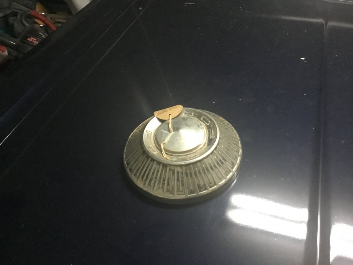

    Hey Randal, after reading your post,you answered my questions already. Hope to see you at the HAMB Drags. Can you post a pic of those proverty hub caps you need? I picked up a 65 proverty hub cap this year at a swap meet in Tennessee. If it’s what you need I’d be proud to see it on your car, sorry only have one.
    Bones
    Went out and found it, not quite as nice as I remembered, but it’s yours if you want it.
    Bones

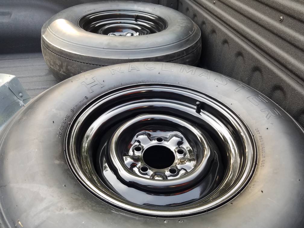

    This could only happen to me. Monday I ordered a set of steel wheels and tires for Dad's street rod from Coker...(ie the whole poverty cap comments from above etc.) After I placed the order I got to thinking about the Cobra and having a set of steelies for the rear with some different slicks (M&H). I decided what the heck I am going to go ahead and do it. So I did. That night I am thinking I wished I had ordered them last week, I could have had them for the HAMB Drags!
    So first thing Tuesday morning I call Coker to see if they had already shipped etc. The answer was "no" they were ready to go and would ship out that afternoon. No shot at them being here today of course so I asked about second day air on the M&H and Wheels etc. I figured I really didn't want to know but in the end it would just be an extra $100 to have them here today. Totally driven by ego, I opted to go for it. So about an hour ago the shipping department reports they have several things for me from FedEx.
    However when I get back there I find Dad's wheels and tires instead. So you guessed it, Coker sent the wrong shipment 2nd day air. I am fairly bummed out about it if not completely pissed off. I call them up to complain and at the very least get my $100 back! They were very nice and went about checking on how this could happen. What they found with the Tracking was in reality, the 2nd day air is still on the truck for delivery somewhere. Dad's stuff, that is sitting in my office as I type, came regular ground and has now officially beat the 2nd day air packages by an hour. Who knows when the air packages will arrive today! LMAO!
  21. Deuced Up!
    Joined: Feb 8, 2008
    Posts: 4,224
    Deuced Up!
    Well they finally showed just before lunch! 3 hours after the standard ground shipped pieces arrived...LOL
    Got them painted and over to the tire shop for mount and balance. Hopefully I will get home in time tonight to try them on...

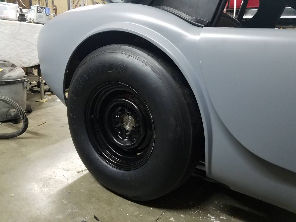

    Well they are on. I am digging the look but I think I need about an inch spacer behind them to push them out just a bit further.
    Sent from my SM-G930V using The H.A.M.B. mobile app
  24. DFH-GMC
    Joined: Dec 24, 2011
    Posts: 132
    DFH-GMC
    from Texas
    They look like they are just inside the well.
    I like them just like that!
