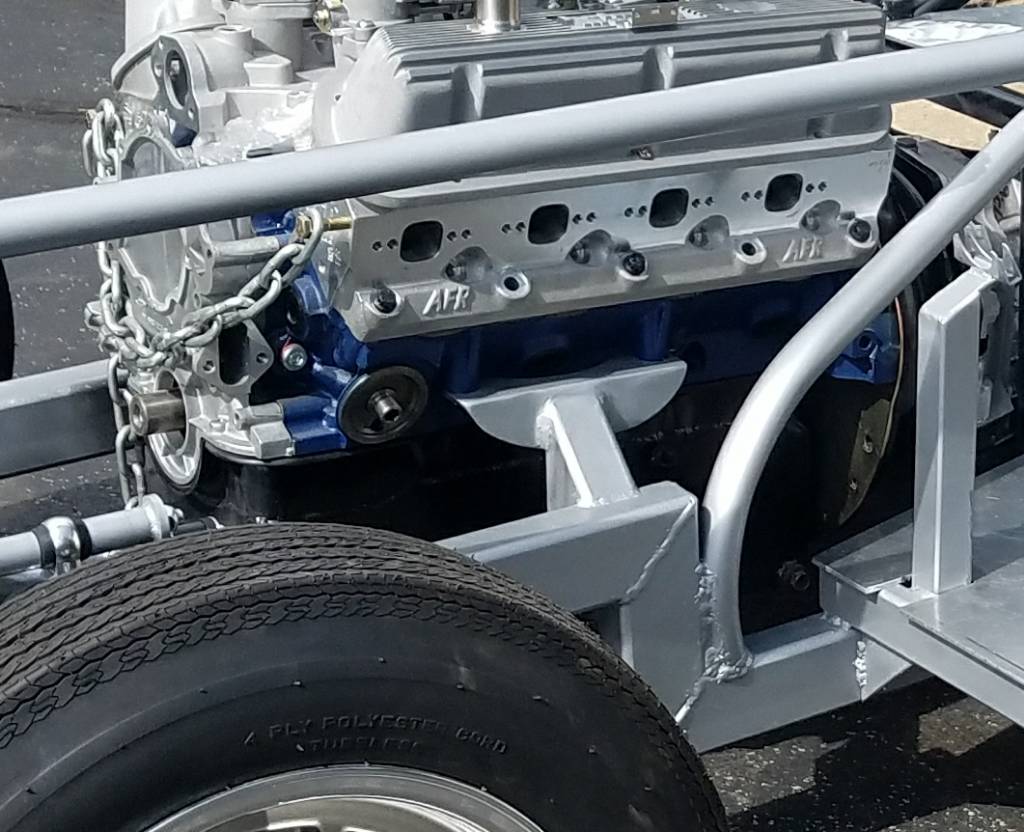

    As you can see above we are going to be pretty tight when it comes to the oil filter. It is something we recognized early on.
    But check out what Dad discovered today while reading Street Rodder. It's a 90 degree adapter from Ford Racing.
    Sent from my SM-G930V using The H.A.M.B. mobile app
    chryslerfan55 and Sancho like this.

  12. Deuced Up!
    Joined: Feb 8, 2008
    Posts: 4,224
    Deuced Up!
    Yep...that was my plan until this thing. Now we can put a nice sized Wix Racing filter on it. But those shorties are cool.

  15. oldolds
    Joined: Oct 18, 2010
    Posts: 3,639
    oldolds
    If you use that adapter, try to set it up so the filter hangs to the right. On some Ford trucks. they use a similar adapter. Sometimes they have the filter hanging on the left side. I have seen them loosen and leak. Use the weight to keep it tight if possible. Imagine the weight of a quart of oil being dropped when the front end hits the ground after a big wheelie.
    chryslerfan55 and Deuced Up! like this.

  19. oldolds
    Posts: 3,639
    oldolds
    Quick starts might loosen it too. Hanging on one bolt with nothing to stop it from moving is the problem. Just a thought. Keep an eye on it if you use it.

  22. oldolds
    Posts: 3,639
    oldolds
    You are tightening against the rubber o-ring. You can make it tight. Sometimes that o-ring has other ideas about how much is tight or too tight. Most times it is no problem. Smooth running daily driver it usually stays. The harsh environment of racing and vibrations of the race engine. Things happen. I would hate to see 10 quarts of race oil laid down on a race track. As we all know sh-- happens.
  23. squirrel
    Joined: Sep 23, 2004
    Posts: 59,963
    squirrel
    some guys use loc***e or safety wire on bolts on race cars....

  25. BamaMav
    Joined: Jun 19, 2011
    Posts: 6,969
    BamaMav
    from Berry, AL
    Yep, get it tight. I have the same adapter on a 460 in my E350 motorhome, it's never came loose. But then again, I wasn't pulling 6 foot wheelstands, either!
