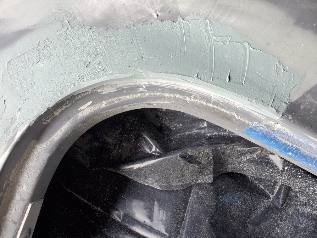

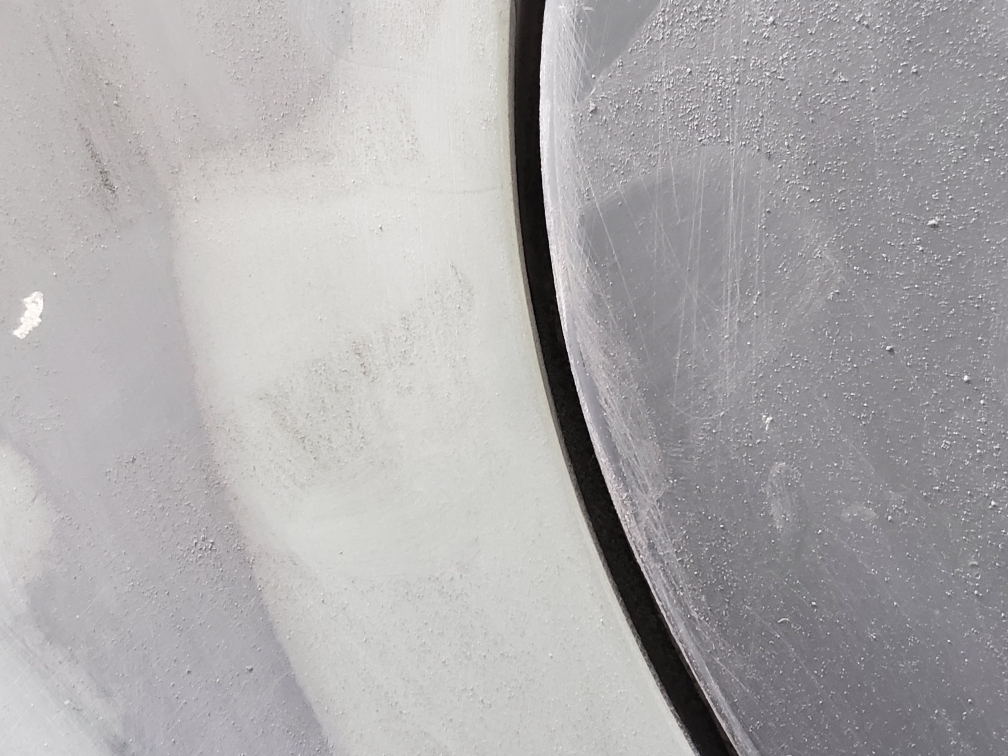

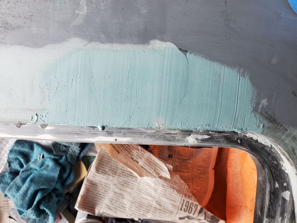

    Okay I so I thought I would take a few minutes and talk about the body work I keep complaining about. I have had a couple of "What the Hell is taking you so LONG?!" messages...LMAO...so let me "splain it" to you all.
    I am sure in the process of bonding the outer and inner doors, trunk and hood skins to the inners that we managed to warp them a tiny bit. That or the fact that they might have not been stored in the best possible manner from the get go (on our part). Never-the-less between that and simply producing the hinge mount points totally from scratch, none of if fit perfectly. Now I am not saying it was crazy out of wack or anything. In fact overall I have been pretty impressed with our fabrication job to get them initially as close as we did and all functioning correctly.
    First up we went after the fitment with either shims or lack there of top or bottom or right or left or all of the above at the hinge mount points. But there was only so much we could do. When we finally felt we had produced all the alignment moves possible, we locked things down and set about body work to finish the job.
    I posted photos of Dad a while back working on the doors. Round 1 was to get all the joints as level as possible. For this we simply filled a bit at a time on one side (door or jam) or the other until we were as close as possible. None of them were "*****en Rides" perfect but close enough for whom it is for, if you know what I mean. Then came the fun part. Trying to get the lines straight and somewhat uniform as far as gabs.
    That usually started with picking at least one gap (if possible) per section that we were happy with. Don't forget both the hood front, fronts of the doors and trunk lid rear area all have to be a large enough gab to look good but also miss the other lip when they open. Above is about the size gap we tried to stay near, somewhere between .25" and .375". We still have a bit of final blocking to door to straighten the cowl side but we are close at this point.
    To get to that level, I would start with a section about 8" long. This is one side of the trunk area. I would close the trunk. Inspect the gap. With a 14" sanding block, lazer straighten the lid (if needed and then close it again. At that point I would take a piece .040 aluminum and place it in the gap. With cardboard strips wedged behind it and it straight, you could see where the body line in the area was off. I would mix up lightweight filler and force it into those areas and let it flow out higher than the top area.
    Then before it totally cured, I carefully removed the wedges and .040 strip leaving a very straight inside line. With a straight razor blade I gently carved off the access at the top and any at the bottom. The filler at this stage was very easy to make clean cuts with the blade.
    After blocking the top area I would take a block and work the inside lines closing the trunk after every two or three p***es to check the gap. I would mark with tape any area that I could visually see was ascue, address it and then close the trunk and check again.
    Finally after working the entire line of the panel from one end to the other, I carefully knocked off the hard 90 degree corners to give it that factory rolled edge look etc.
    When it was finished it looked like this and on many of the gaps we added as much as an 1/8 of an inch.
    On the hood corners even more to match the contour of the hood. I did it the same way, bending the .040 strip to fit before putting it place etc. The final result is pretty good.
    ....or again. Good enough for whom it is for...
    Then after all of that craziness...we started simply wet sanding the entire car...
    Someone said earlier it will all be worth it in the end. I hope so...as it has been a crazy stupid pain in the back side. But we are getting close to some color! Thank goodness!

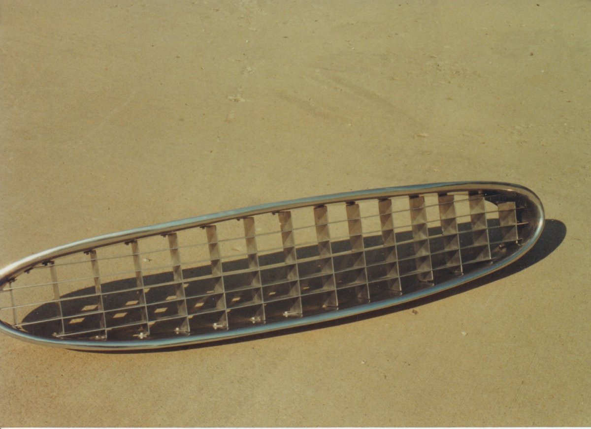

    not sure where the photo of the yellow car came from but this is the one that I restored and any apparent curvature in the bars is due to camera lens distortion (especially in the shot of the yellow car).
    Note that the grille ***embly also has a loop of material surrounding the egg crate portion. I don't have any photos of the Cobra grille before it was fitted to the car but here is one that I made for a Ferrari restoration that I worked on around the same time that I did the Cobra. Notice that the slats in the Ferrari grille are a lot thinner than those in the Cobra and are simply flanged at their outer extremities where they meet the surround.
    Roo

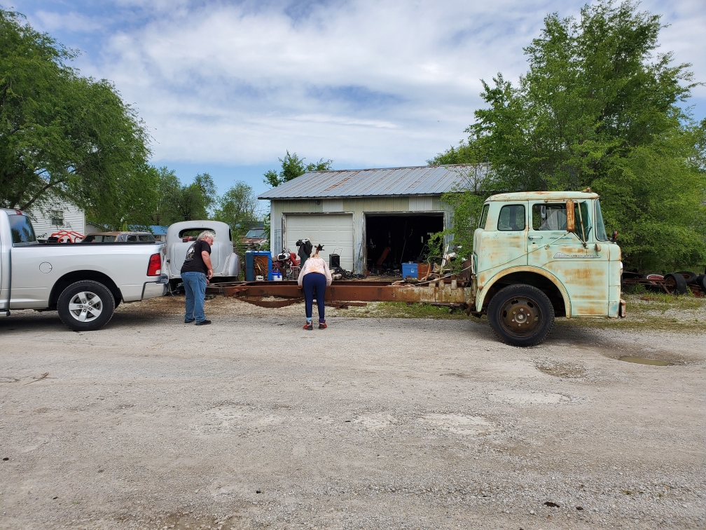

    Well it has been a while since my last update. I have meant to get on here several times and do some catching up but time simply gets away from me. We are getting pretty close to painting the beast. I know I have said that several times but we really are. Dad has been relentless with the body work. Which honestly has been a blessing. One because I certainly did not want to do it and two it keeps him safe in the shop during the past several weeks of stay at home orders etc.
    And since we have no where to go even if we were ready it has been a rather leisurely stroll through final body prep etc. Which to be honest has given me a lot time to think...which is usually a dangerous situation!
    As you can see some good ole Wimbledon White has made its way to all the jam areas and one of the things that is taking so long is all the final prep work to the under side of the hood and trunk etc.
    Dad has really been working hard to clean them up and they look really nice. But back to this "thinking" episode. I have had the killer blue picked out for the car for quite a while but playing around with the Ford c600 vintage hauler graphics a week or so ago I got to thinking...
    ??? What Vintage Ford c600 Hauler ??? ...sorry did I leave something out? LMAO
    Well not really, you might remember WAY WAY back I had a chance to purchase a 600 and I even played around with what it might look like as a hauler for the Cobra. However the deal fell through and we simply moved on to more important things. But the thought has never worked its way too far out of my brain. AND maybe it is the fact that we are on the last few pieces of the Cobra or chalk it up to Covid 19 Madness I don't know but I sort of got serious about it recently. And the very minute I said it outloud, I pretty much spoke it into existence.
    First off I was talking with Jackson (@wrenchbender) several weeks ago about a few parts I have that he wanted etc. After talking about it for a bit I said, instead of buying them, why don't you find me a Ford c600 cab so I can build a hauler. It didn't take long. The following week he found one and started trying to work a deal with the owner. Just as he was about to close on it a family member of the owner got in the way and ****...the truck was off the market.
    However not even a week later while checking on an old hot rod project at a friends house, there sat another c600. AND in much better shape than the original. He shot me some photos of the truck and I said lets do it.
    I was pretty stoked with it especially when I saw it had the quad headlights. That makes a '58-'60 model (unless a fire department ordered quads on a later model). My initial thought was correct and it turned out to be a 1960 with a pretty smooth running little HD 292 "Y" block in it. Which incidently appears to be headed for another HAMBer's wife's hot rod (since he picked it up today while we were picking up the truck and before I got home already had it installed)...LMAO!
    But I am getting ahead of myself as usual. So earlier in the week we shot over to Jackson's shop to have a look at my new toy. While we were there we started contemplating exactly how to get it from there, which is nearly in MOKAN Dragway's backyard to Republic, MO. This is what we came up with...

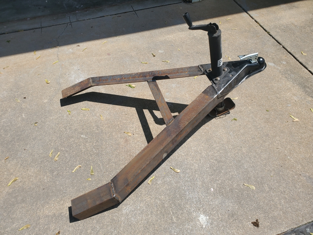

    Fabricate a heavy duty tow bar. Take it to Jackson's house. Slide it in between the rear frame rails and weld it in place. Then blow off the spring shackles, roll the original rear end out of the way, drop coupler on my hitch and flat tow it backwards home.
    Jackson and Dad getting it all squared up this afternoon and ready to weld. My daugter Zoe supervising. LOL. After we got it in place, Jackson welded it up and Dad and I worked on strapping the steering in place. Since it such easy access with the flip top cab we started by strapping ONE of the THREE pitman arms in place. Then for good measure we closed the cab and did the old steering wheel straps as well. By the time we were finished, Jackson had a couple of heavy beads laid down and the tow bar firmly in place.
    Jackson torched the u-bolts and after rolling the rear wheels out we had a c600 trailer! LOL
    Dad and Zoe ran the wires from the towing lights (thank you Harbor Freight)! And I took the contraption around the block to see how she tracked. She seemed to handle pretty well on the tight streets of Waco, MO so we decided to set sail for Republic!

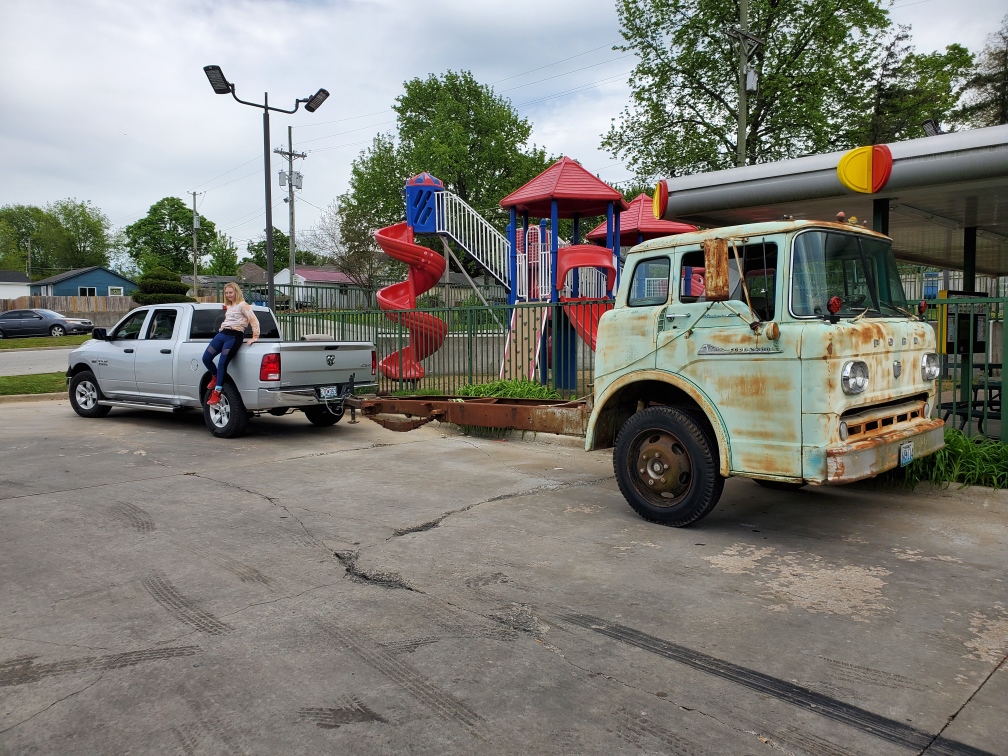

    About 20 miles in we stopped for a snack at a local Sonic. We checked the tires and they were still up and no visiable rubber missing etc. The bearings were as cool as cu***bers... so we Cherry Lime-Aided ourselves up and hit the road again. It was an uneventful trip. We stayed around 55 or so and she pulled and tracked like a brand new trailer!
    I am sure my neighbors were wondering what in the world we drug home this time. But to be honest, it would not be the first time. Thanks Jackson for all the ***istance and for finding us one killer cool little Cobra hauler! LOL
