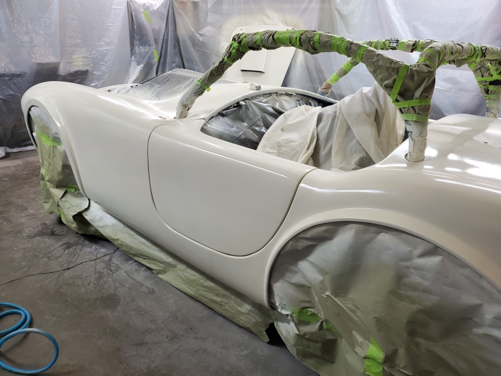

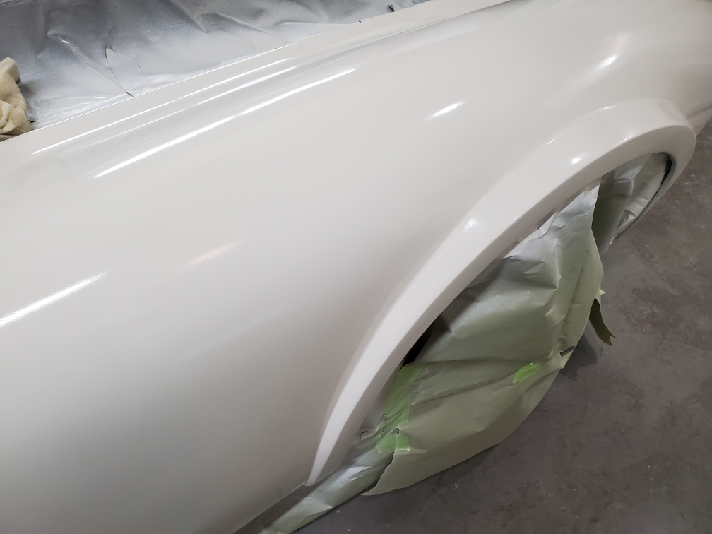

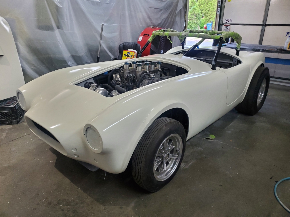

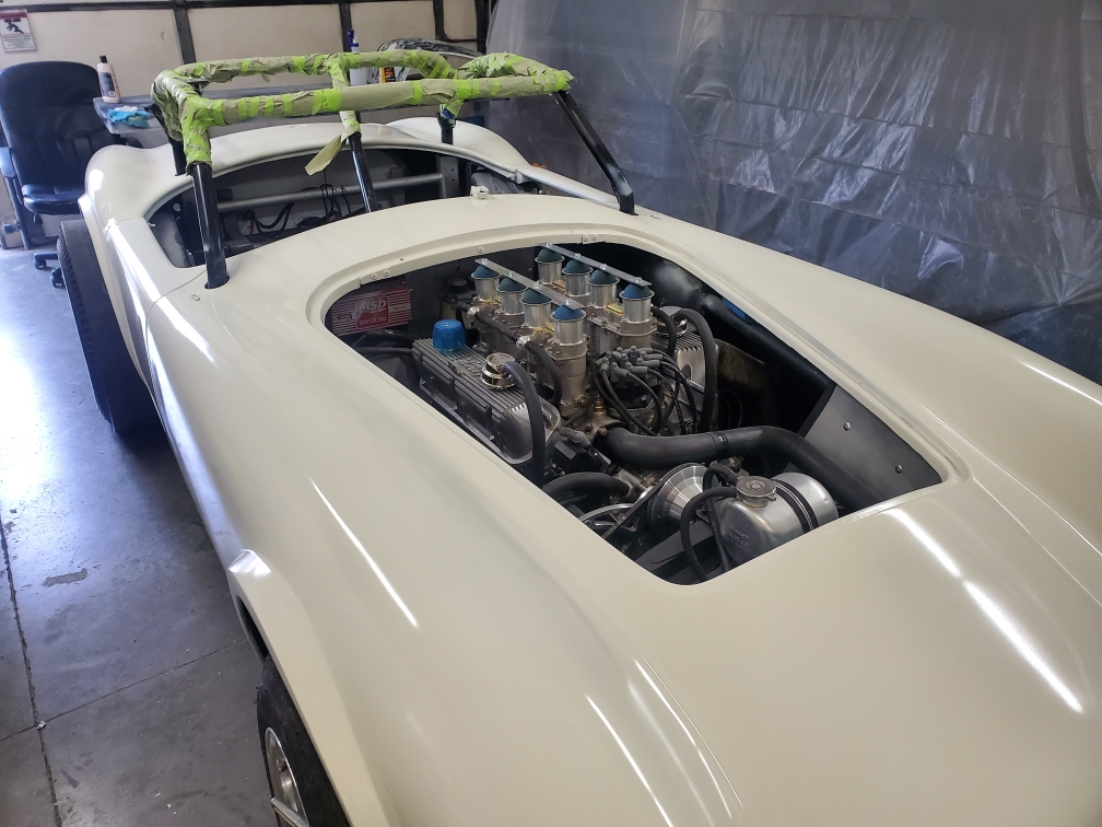

    You boys remember last night when I mentioned the creek rising? Well she got pretty deep around here today and I was getting fairly worried for a while. But we finally managed to pull it off and tonight the Cobra is a very nice shade of Wimbledon White...just as planned.

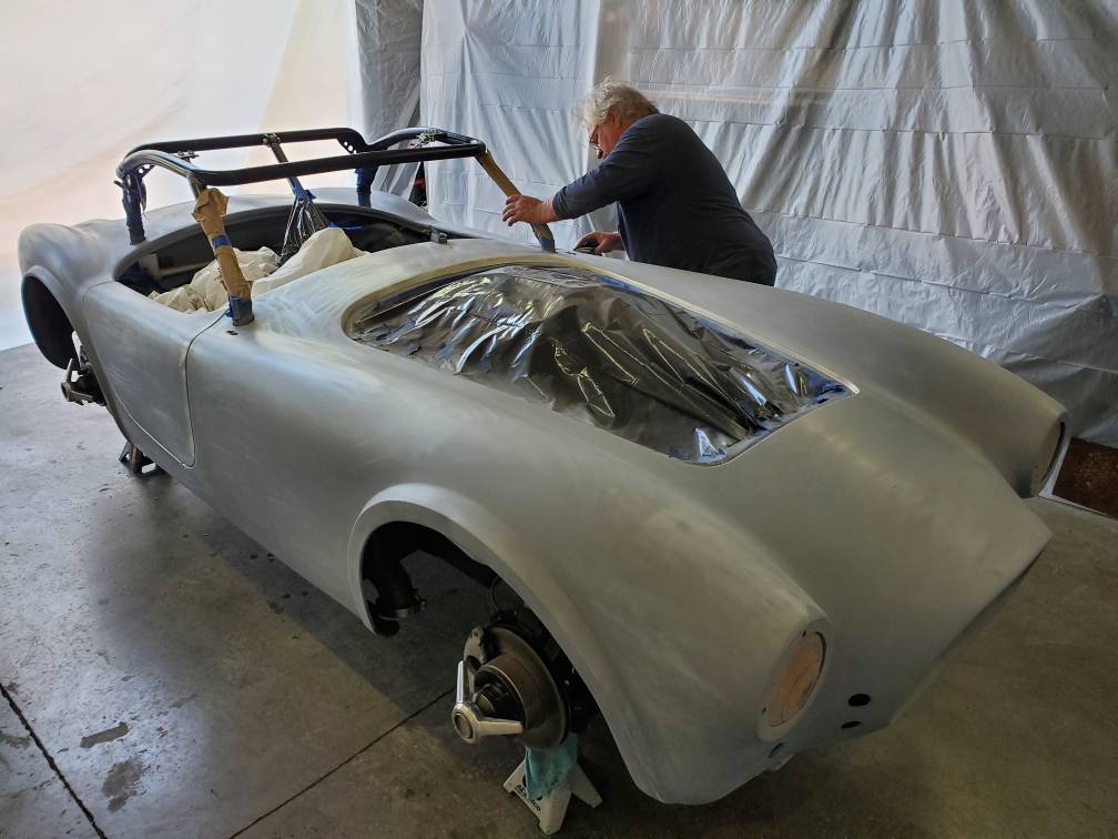

    We started off this morning with Dad wanting to make a few quick final touch ups to a body work areas. He said it might take him an hour on the outside. So my daughter and I started getting the shop ready. I had 25' rolls of plastic drop cloths that were 10' wide. We cleaned and swept the shop and then stapled the plastic to the wall on one side and the top of the lift on the other. We stretched a string across the back third of the shop from the wall to the lift and before we long we a very nice temporary paint booth well underway.
    We zipped tied more of the plastic to the garage door and then opened it up to about 9 feet and secured both sides to the plastic already in place. With the Cobra sitting just outside in the morning shade we waterdown and cleaned the floor really good. Then we put the big shop fan in the door blowing out and set about helping Dad. We had already decided to start with the trunk and hood. The trunk needed the inside or underside painted as well so that was the plan. Get the gun all adjusted and tested on the inside of the trunk then paint the outside of it and then hood and then the car.
    We had to work over the hood scoop quite a bit and in that process we lost several of the holes we used to poprivot the stupid thing to the hood. Last week using the few remaining holes and the inner aluminum hood panel, we carefully redrilled them. So I decided while Dad finished up his body work, I would go ahead and carefully reinstall the scoop. I have no idea what or how it happened but several of the holes did not line up not to mention I only had 2 rivots left in the box with .5" grip.
    No problem right, just hit the autoparts store real quick. Well believe it or not they didn't have any, nor did Lowes or the local farm and home store etc. So I had to go to Springfield to get some. By the time I got back Dad was ready to roll the car into our plastic booth. We decided to take a few minutes and get the hood ready so we could shoot it and trunk as planned. However it is still being a total pain in the backside. The rivots are not pulling down like they should. Not breaking when and how they should. I start to chalk it up to cheap rivots (which they were not!) until I thought of something...air pre***ure.
    Dad had been playing with the regulator on the Devilbiss dryer and his gun trying to get the right balance etc. AND that didn't leave me enough pressure for the rivot gun. It was a mess, we had to carefully drill out a bunch of half baked rivot attempts and start again. Of course in the process I screwed up the body work. Nothing serious but we would have to touch it up a bit and I am not happy at all about it. Suddenly in all this mayhem, there is loud a crash. We had bumped the table that we had been working on out under a tent. The trunk which was obviously, perilously perched on the other end of the same table fell off and actually bounced and did a sort of a cart wheel before coming to rest upside down on the driveway! What are you going do...right? Laugh or cry! LMAO!
    So for what Dad claims is about the 15th time, he starts working on the trunk again! While he is at that, my daughter and I wash down the Cobra really well, then push it in side, put it on jackstands and set bout removing the wheels. After that we began the a full on masking job of the entire car. I don't know how long that took but it was well into the afternoon before it was finally ready and we broke for a very late lunch.
    By about 5 p.m. we have not even tacked the car down but we are close. Dad gets suited up and I mix the paint and thinner and stir well. We have the 1.3 tip in the gun and pressure set at about 10 pounds or so and Dad shoots the underside of the trunk. It is hard to tell anything as it is mostly unfinished fibergl*** that will later be carpeted but it seems to go on pretty well. I asked him what he thought and said he was not sure, it felt pretty good so he decided to shoot the hood that was set up just to the right of the trunk. We promptly oranged peeled and pinholed the holy hell out it. LOL.
    After playing around a bit, I found the 1.3 tip in the 1.8 plastic container so you guessed it, the 1.8 was in the gun! So that will not work at all. After getting the correct tip in the gun and upping the air pressure a bit, we finally got it to spray nicely. It took the better part of day but the I am really happy with the results. Eitherway, she is Wimbledon White! AND I love it....
    We have a few minor over spay areas, nothing we didn't expect with such a swoopy car, not to mention having the roll cage in the way etc. But we have plenty of paint on it so should be no issue buffing it out a bit. It sure is good to see her one solid color again. It has been a long time coming. I am pretty excited to get her out in the sun tomorrow. Not sure if we will have any here but you never know.
    cactus1, kiwijeff, Sancho and 19 others like this.

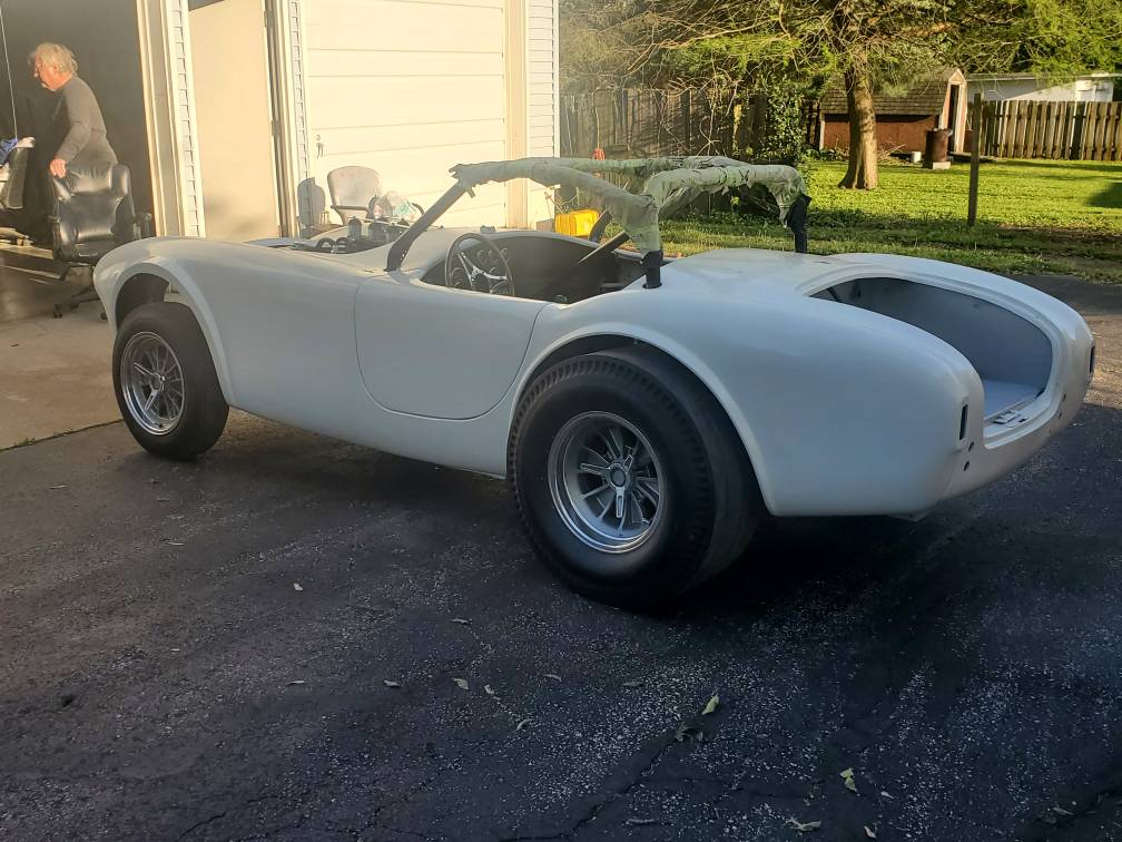

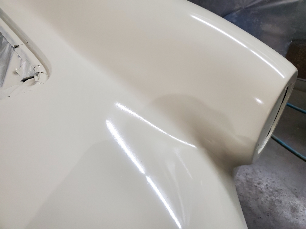

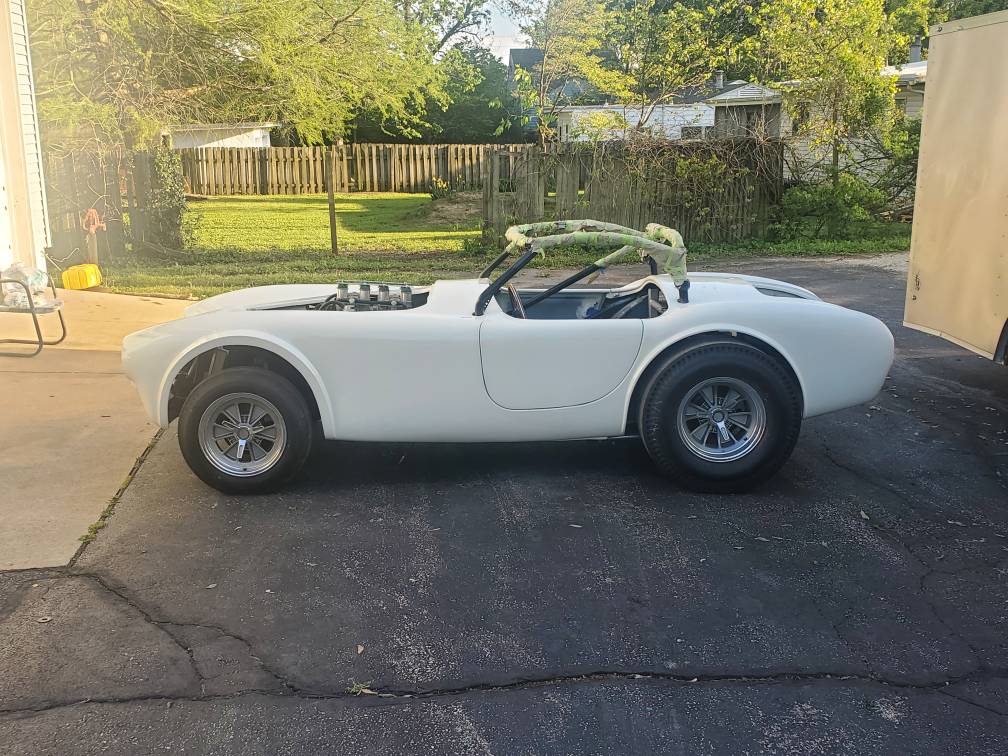

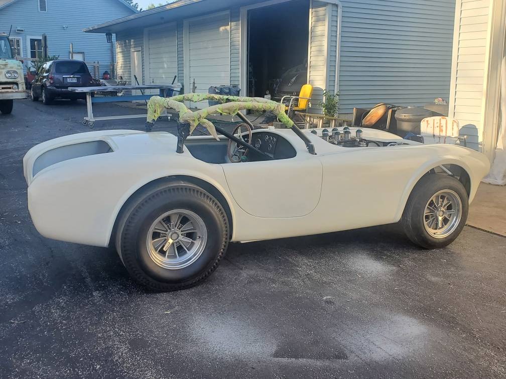

    Man I sure dig the Wimbledon White. It has always been one of my favorite colors. It is certainly a good feeling to have it one solid color again and on the ground. We caught a little sunshine yesterday. Since we did not bake it or anything we are going to let her set for the week and catch as much sun as Mother Nature will provide. Then hopefully by the weekend we can get back in there and do a bit of 1500 wet sanding and buffing etc.
    Dad did a killer job on the car, there is very little to no orange peel at all. But being such a swoopy car we have a bit of over spray here and there and of course we have some dust specs. We did a good job of cleaning the shop, hanging plastic and wetting the floor etc. to keep it to a minimum. But it is hard even in a killer spray booth to be 100 percent. I think we can make quick work of it and move on the next stage.

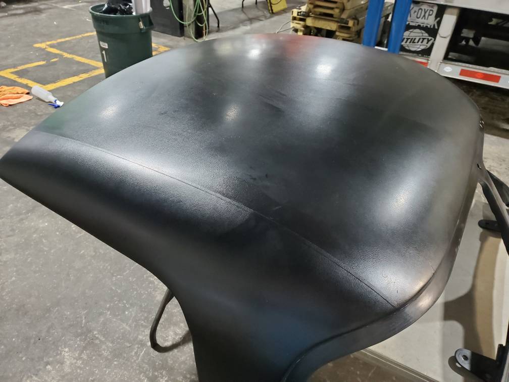

    Looks good, did you paint the top too?

    Nope it is finished as a black vinyl top.
