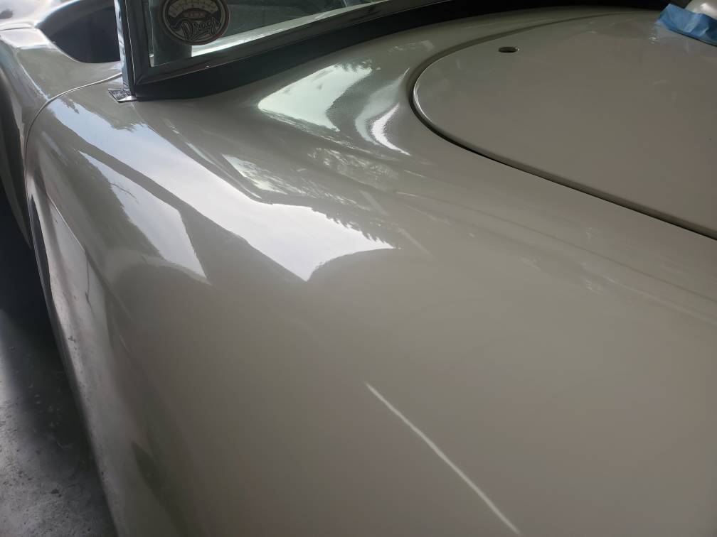

    Well we are back on the Cobra. We had a quick hiatus to work on my daughter's Riviera. The kind of work going on there (cutting, grinding and welding in new floor pans) jept the freshly painted Cobra in the corner and covered. Lol
    But this weekend we got the shop back in order. Today Dad started polishing the Wimbledon white. Of course he already knocked the paint down where needed with 2000 wet paper. Now he is starting with Meguires 105 compound.
    She is sure cleaning up nice. We are about start the re***embly process.

    Starting with 200 looks pretty good, must be some good compound. :)

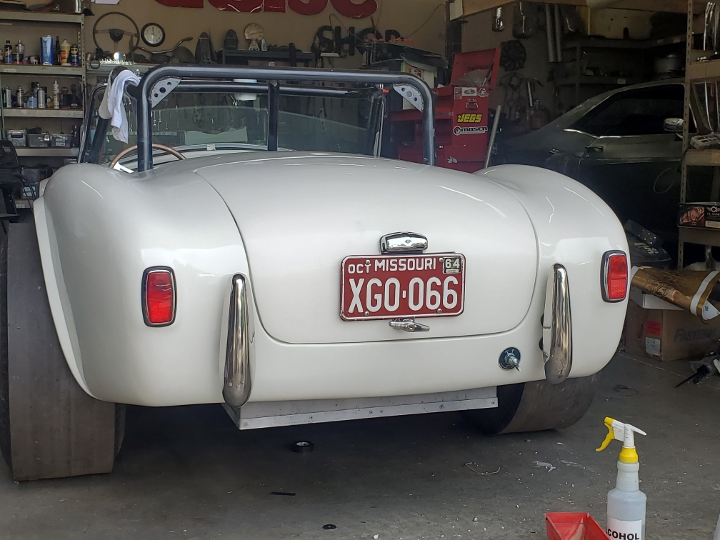

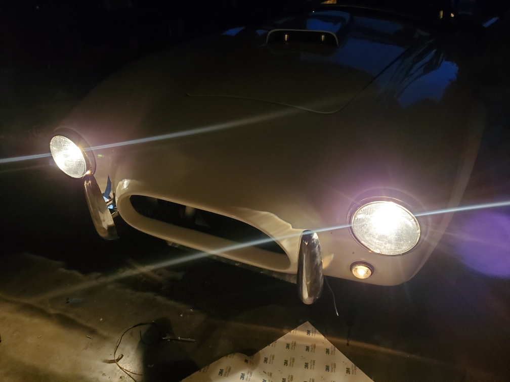

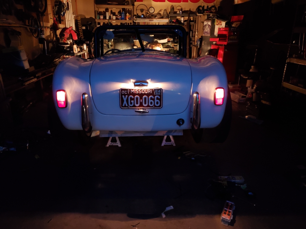

    We we got a lot accomplished today. We got all the lights back in and installed permantly now. We also rewired them all properly and cleaned up any loose ends etc. All the wiring is now nicely tucked away in mesh harness looms and mounted up and out of the way. We also got the bumperettes back on mounted firmly in place. It took a while to track down all the body grommets for them but I finally found them all etc.

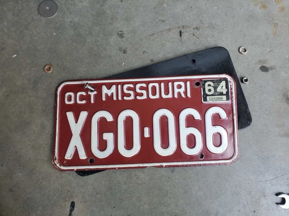

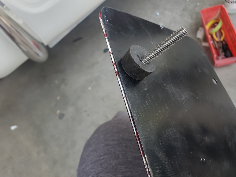

    Now the license plate holder and light was a different story. While it had been installed before we had never taken a look at how it actually got wired up. In typical "Prince-of darknes" Lucas protocol it had complicated internal soldering needs. But we managed to get it together and in place hower ever we had to drill hole in the trunk lid (yikes) for the wiring.
    My vintage plate is tweeked a bit, from nearly 60 years of laying about somewhere...LOL! To address the issue I created a reinforcement plate to mount it to before mounting to the holder. It worked really well. However after mounting it neither Dad nor I liked the angle. The original style bracket, which mounts the plate (plates) only at the top sort of pushed the bottom out a bit at an odd angle. We decided to utilize the bottom hole, put a rubber stopper on the back of the plates and mount it to the trunk.
    Yep you guessed it, two more holes in the heavily over worked trunk. Dad was sort of twitching as I marked and drilled the holes. Can you blame him....? LMAO!

    The stupid thing though, after all of that work the crazy Lucas lights work just as expected. Well at least close...I mean normally you would think flip the switch and nothing...Right? So take a look. They actually work, however they basically shoot light everywhere but the damn plate! LOL

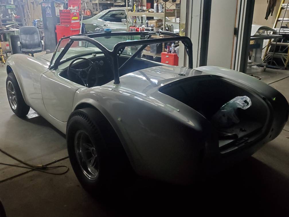

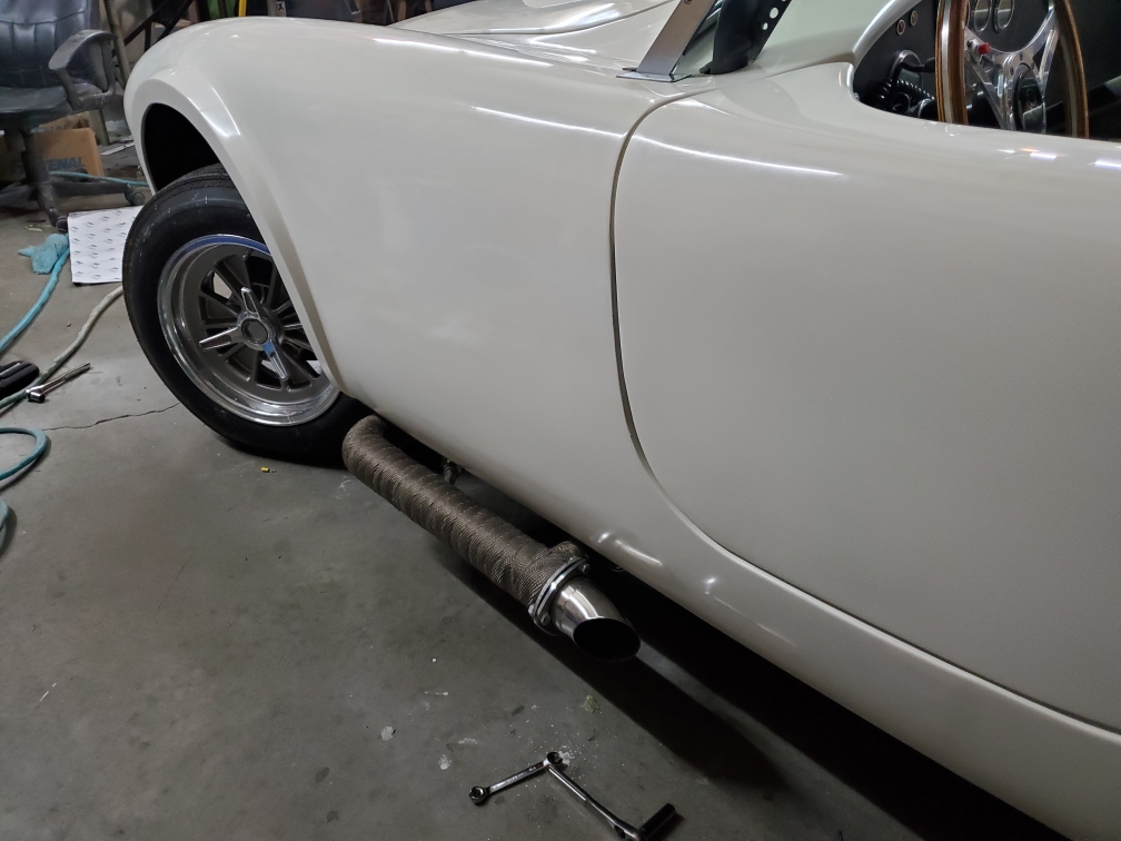

    Front end back together and wired as well.
    Headers back on as well.

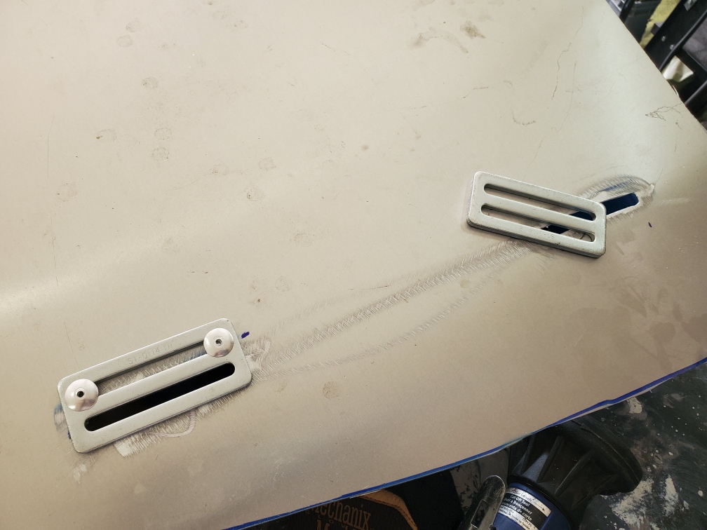

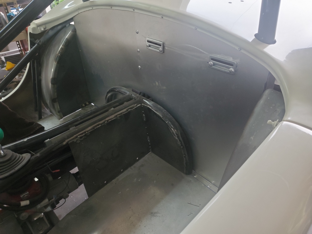

    After getting it all back together we sat about the real task for the day, finishing up the ****pit fire walls etc. I have been putting off doing the rear section but today was the day.
    I started with the p***enger side and after making a really good posterboard template, I cut it out of .040 aluminum and popriveted it in place. It looked really good. Then we flipped the pattern and it fit the driver's side like a glove. I went ahead and cut it out etc. However before could install it, we had to make some decisions on the seat belt harness mount.

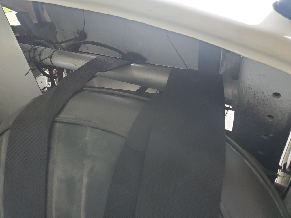

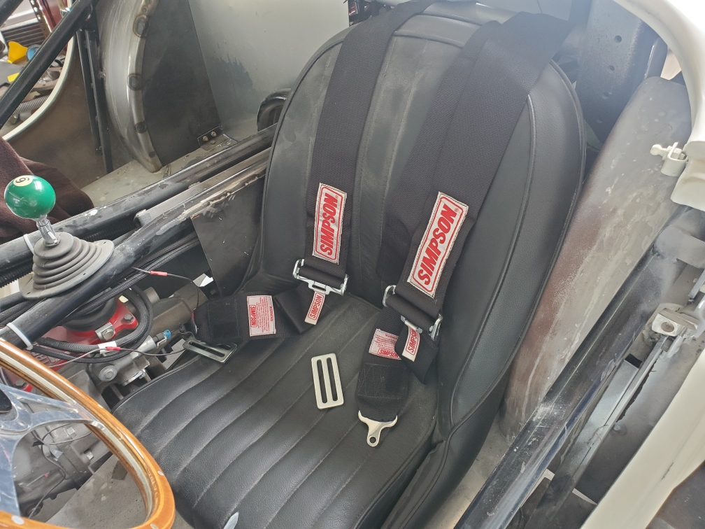

    Now a very long time ago, even before the body was on the car, we sat the seats in place and decided how high the should belts mount point would have to be.
    We placed a roll cage bar across the back between the two solid upright mounts. As you can see that is what the belts are laying over in the photos. With the driver's side seat in place before we moved forward with the rest of the rear firewall, we made sure those measurements still stood! And as you can see, they did.
    Just to be sure, I hopped in and tried them on for size. No issues, they are in the perfect spot.
    I did run through the gears real quick making sure I had full range of motion etc. Everything seems to fit just as planned.
    We looked around a bit for something to installer on the driver's side rear firewall to allow the belts to come through but that would not run the risk of fraying or wearing the belts over time. I had a few Simpson belt slip buckles laying about so we decided to use them. After marking and cutting the slits in the panel, we pop riveted them in place.
    Of course at some point it will all be covered in a loop carpet but for now, we can at least finish their installation. We have a few small corner area and trim pieces to install and of cours the trans tunnel but we should be able to knock that out tommorrw and get her all sealed up.
