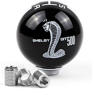

    Amazon.com.

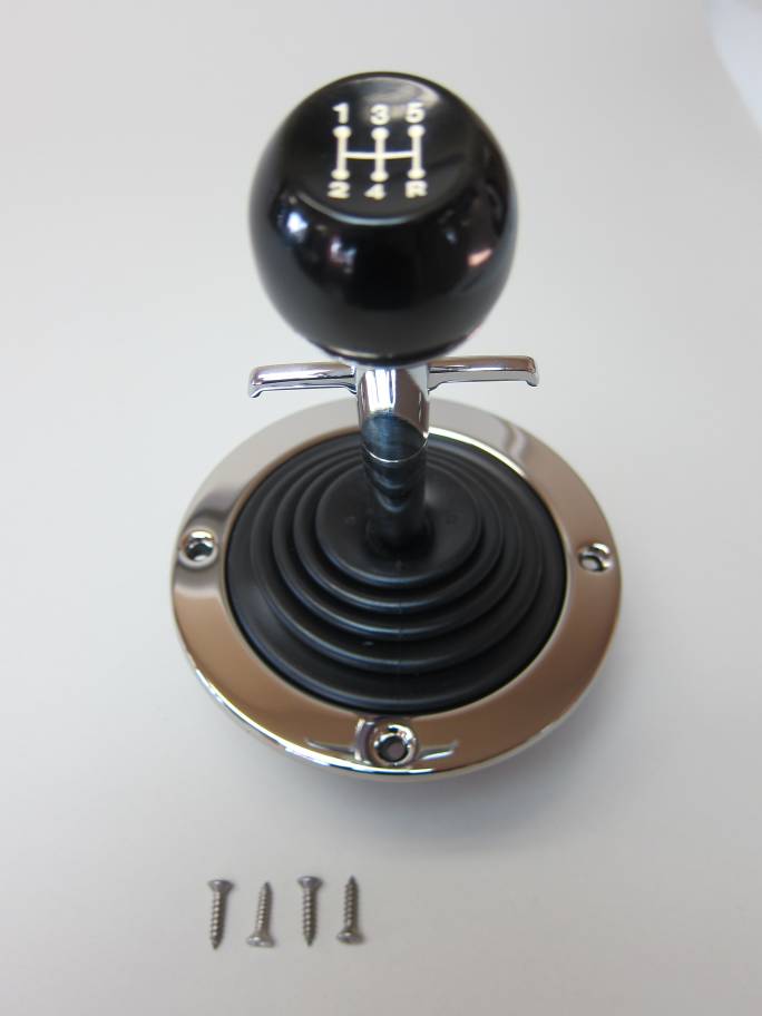

    While looking on Amazon I saw this one for you

    Which brings up that whole Cobra shifter difference thing.
    Not being up on all the minutia Cobrawise (original), and yes, I could just Google it but how much fun would that be.
    Question is why are some shifters short and straight and some are bent toward the dash (so odd), is it a small block versus big block deal? is it a T-10 versus toploader deal?
    Obviously the bent one was designed that way to simply put it in a comfortable location.
    So why does the straight one still satisfy that scenario on some cars?
    And by the way Randall, in my way of thinking, the obvious first thing a racer would have done back in the day would be to pitch the OEM shifter in favor of a Hurst unit, may have been because the Ford style shifter was a much better design than the equivalent ones that GM built.
    Also, were these standard Ford shifters with Cobra specific handles?

    Well the first gen small block cars had the straight levers simply because everything fit pretty well in the car. However when they slapped a BB in all hell broke loose in more than one way or place. Lol
    In the case of the shifter lever it shoved the transmission further back and suddenly the shifter location was not so comfortable. Unless of course you were a contortionist. It was an easy fix though. They just installed a mustang shifter bas-ack-wards. This had it arching toward the front and put the knob back in a workable position. Clever?

    This is the style of an original Cobra knob, but of course it was a 4 speed. I have one. But it just doesn't inspire me to grab it and pull hard. However I am gathering quite a nice collection of potential knobs. Lol!

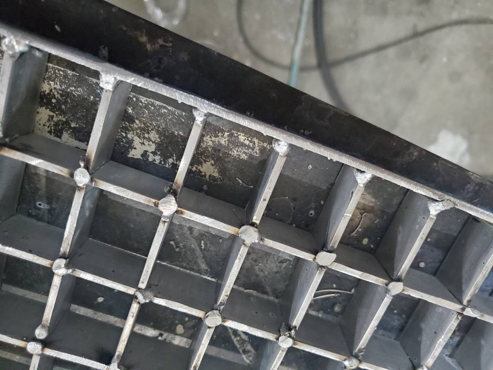

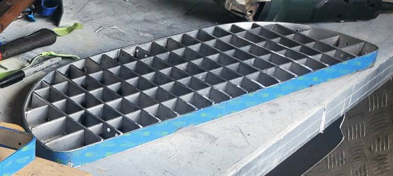

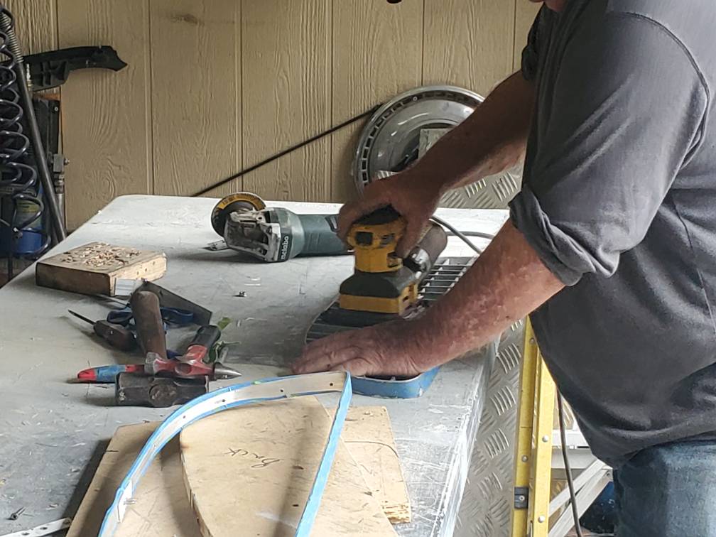

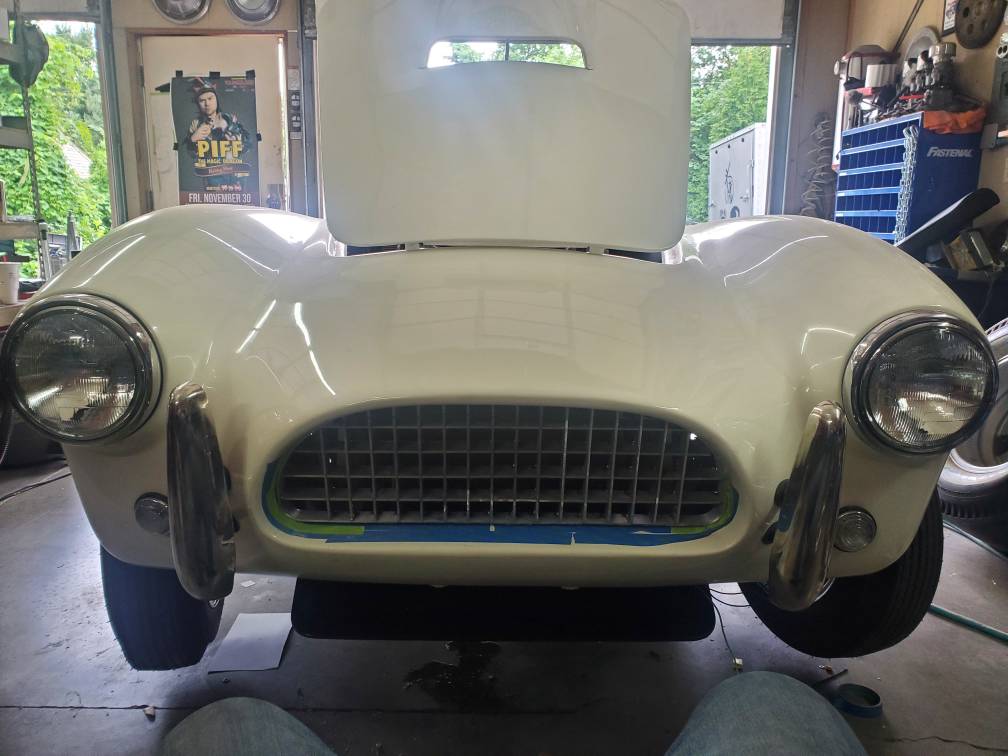

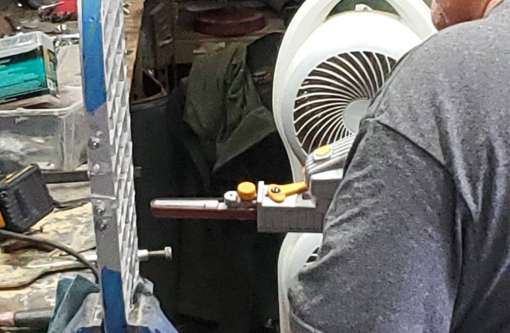

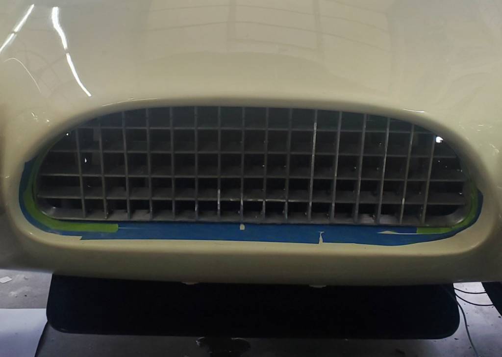

    Then we got totally distracted. Honestly it does not take much! This however, was a pretty cool diversion.
    For the past week Dad has been bound and determined to make an outer band (for lack of better term) for the grill. It really needed it to give it that finished look but I knew it would be a pain in the back side!
    You can see the aftermath of several attempts laying there on the table.
    A couple of days ago, I helped him get a really good poster board template of the opening. He used it to make a wooden buck (like the one above). Then he heated and pounded a 1" aluminum strip into submission around it. It was not only the general shape of the hole but then he also sort of chamfered it to the inside, just like the opening.
    After we confirmed it would fit the hole we laid it on my egg crate creation and marked it. We needed to take nearly a half inch off of it to fit inside. To keep it centered up and down, we took about 1/4 inch off the top and bottom of each of the vertical sections.
    After the initial cuts and re***embly, we carefully made small grinding edits one section at a time until the egg crate fit as perfectly as we could get it. Then a quick test fit to make sure we didn't change anything in the process.

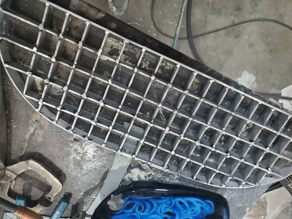

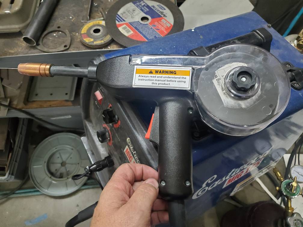

    Now. How to secure it. We still had the section blocks shown earlier but hated to use them. My welder came with a an aluminum spool gun. It has been in a box in the bottom of my tool box for 6 years.
    I have never tried it. We decided since we had come this far, why not do it right (or at least try). So we headed to town to snag a bit of pure Argon gas needed to weld aluminum. I installed the spool gun, watched a you tube video and fired it off.
    Thanks to several s****ped attempts from earlier in the week, I had plenty of the exact material to practice on.
    It took about 10 minutes or so of playing around before I told Dad to bring me the grill. I am not sure he was as confident as me. LMAO!
    We decided the safest way to go at it would be to flip it over and quickly hit every cross point with a shot from the spool gun. The the same thing where the egg crate section touch the outer ring. We got it all set up and I practiced a few times on the s****. When I had a good rhythm etc, I switched to grill and knocked them out.
    It is solid. All we have to do now is take a file to some of the insde corners where the weld spot was a bit too large. Easy breezy
    After I was finished, Dad took some 80 grit and quickly evened up or flattened the front of the grill. A couple of the vertical uprights moved a tiny bit during the weld up. No big deal, maybe a 1/16". The sander made quick work of it.
    It took some time but it is fairly bad*** looking! Just a nice little finishing touch!

    I have a spool gun sitting in a box somewhere that I have never used as well. Not sure I would take it to my grille 10 minutes in? Probaby though... only one life, right?!

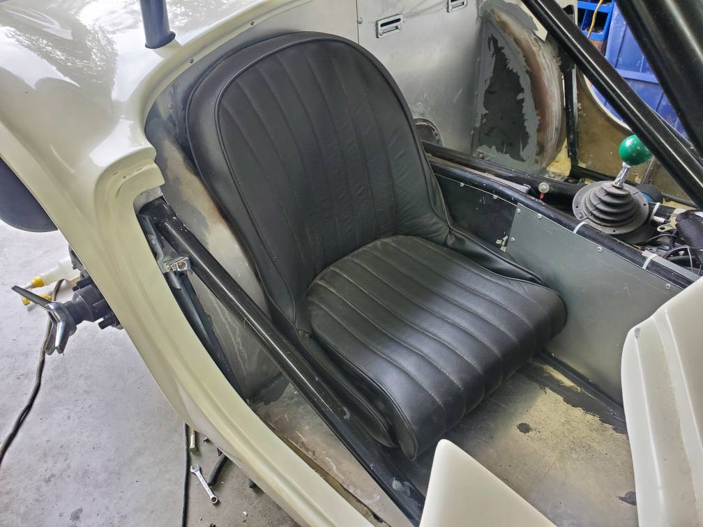

    Well all the sheet metal work is complete in the ****pit. This afternoon we set about trying to get the p***enger seat to fit.
    Not bad right? Well of course it required a little surgery!
    We had to take about 2" out of the the left side. YIKES!

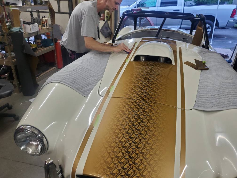

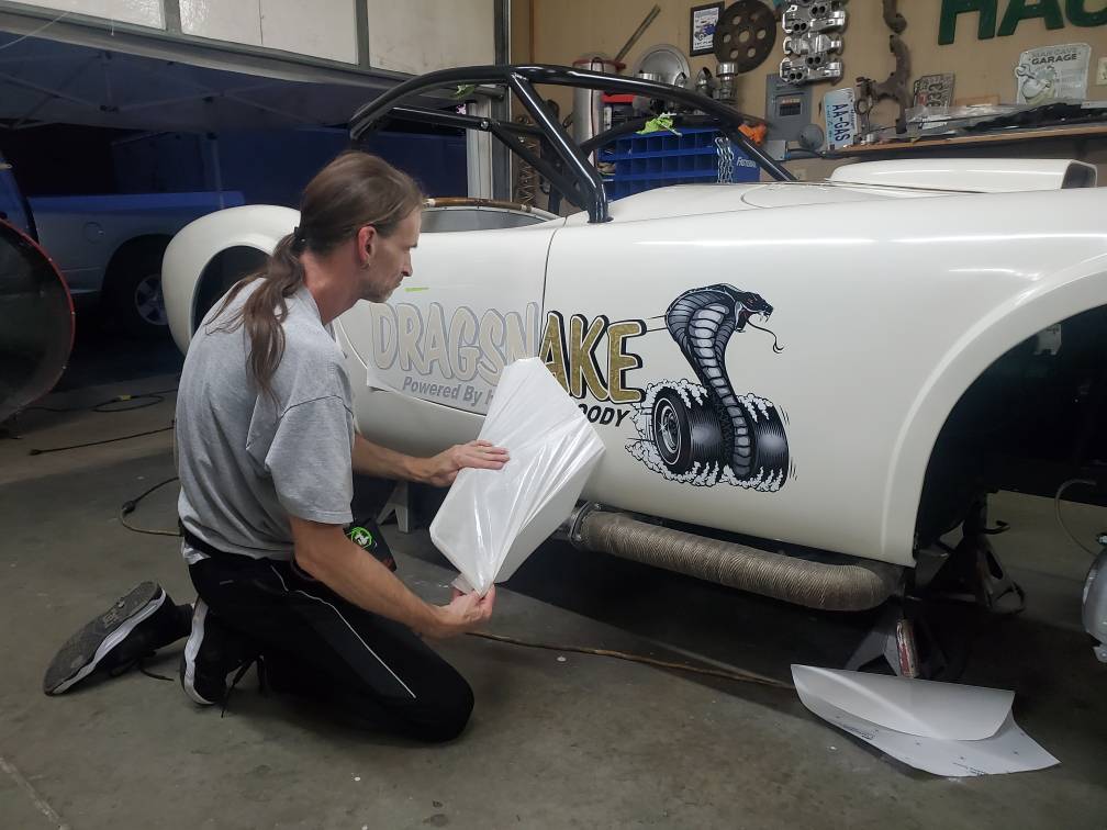

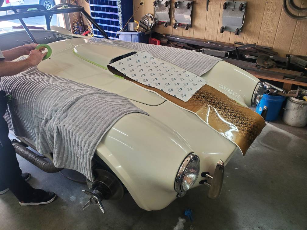

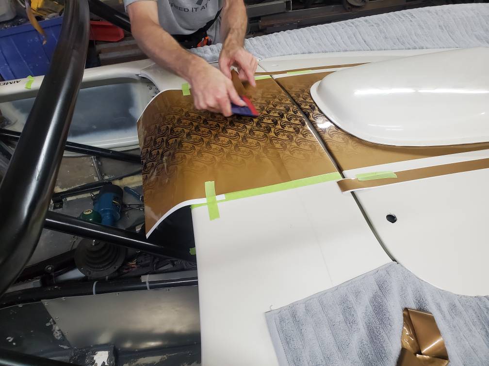

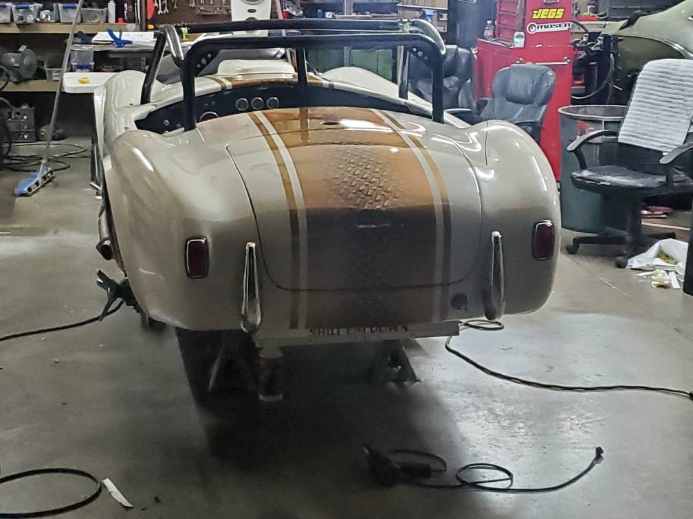

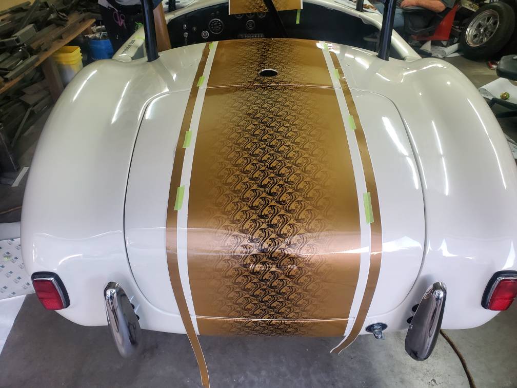

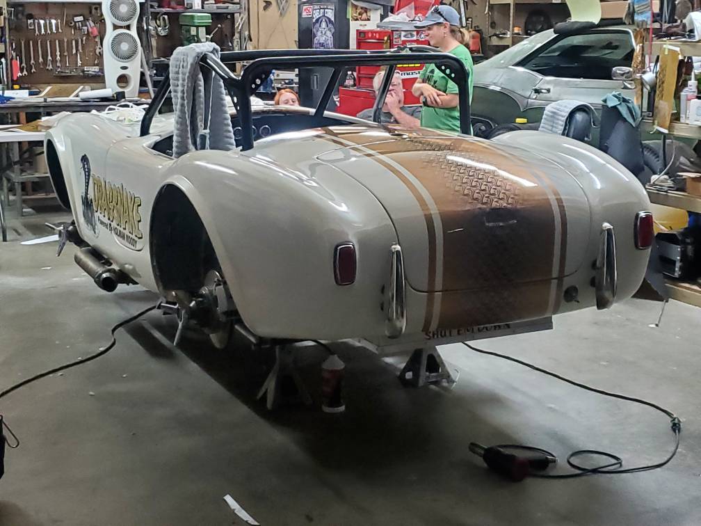

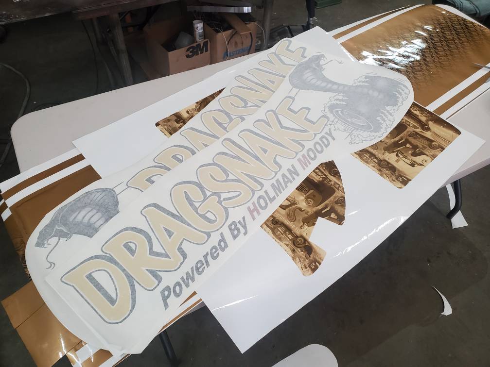

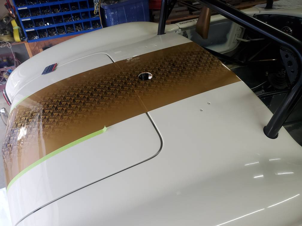

    Well boys and girls, tonight is graphics night. The grill is fired up and we are about to do it to it. As they say...
    We got an early start on it with a couple of small ones.
    Sent from my SM-G970U using The H.A.M.B. mobile app

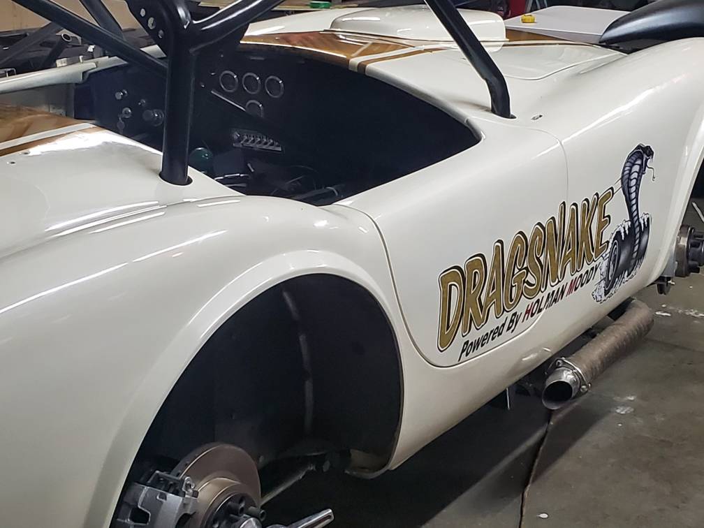

    Man I have to say, Dad and I just sat there in the driveway with silly grins on our faces for a long time! We would still be there but a couple of mosquitoes carried off my pickup so we decided we better get inside! Lol.

    Randall, your car looks awesome! The gold and white were an excellent choice and the graphics look great. What a great looking hot rod! I cannot wait to see this video of this beast at the track:cool:
