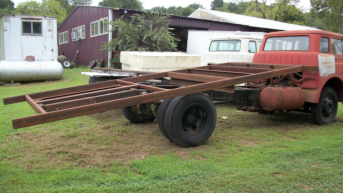

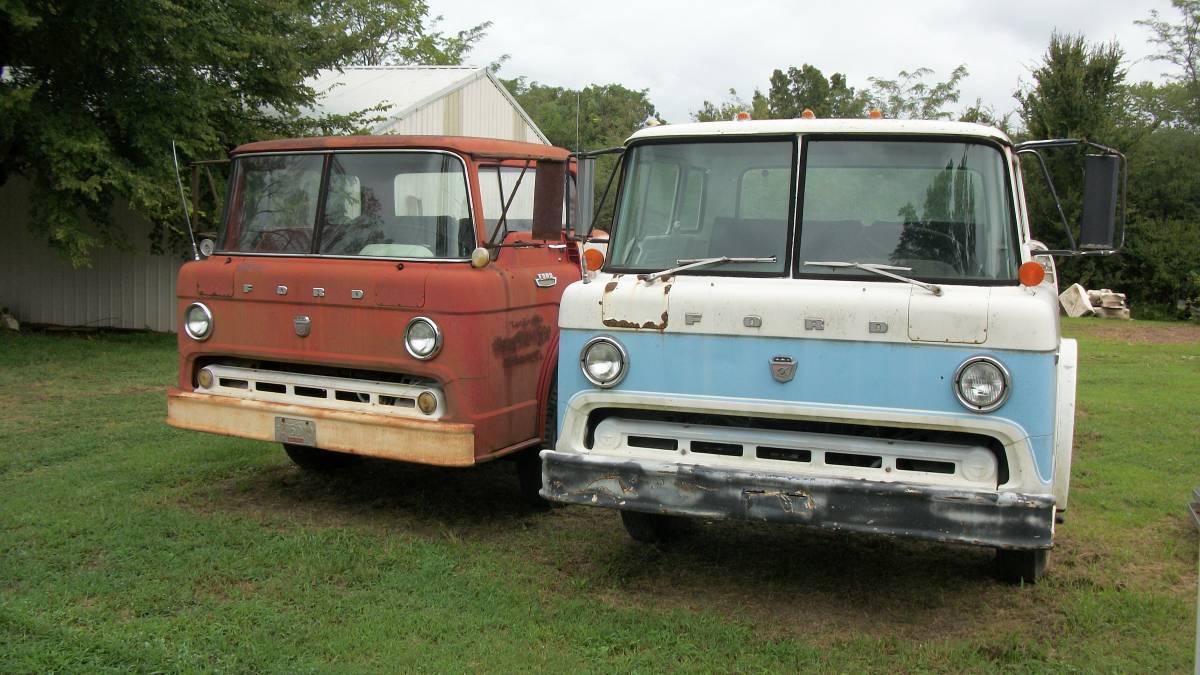

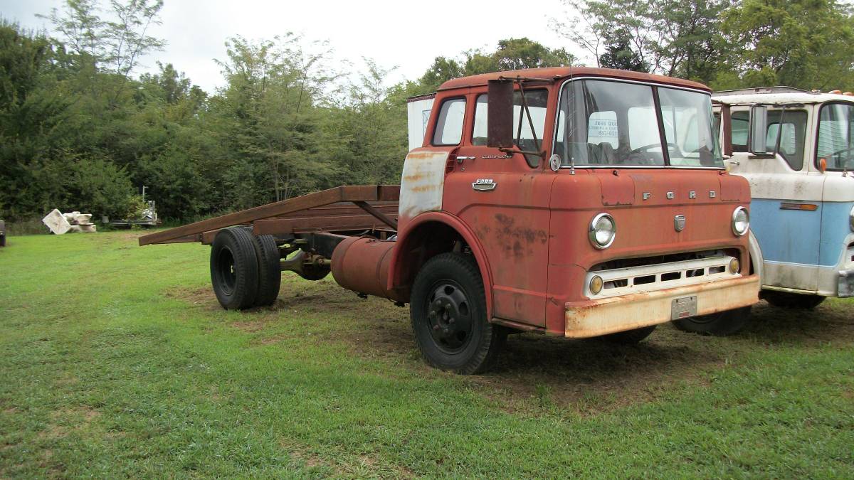

    Look what I found this morning on Craigslist...just about 40 minutes away!
    The 1964 Ford 600 hauler project above has new motor, rebuilt C6, and all new complete brakes. The other is parts truck and it runs as well. Would make a killer era correct hauler!

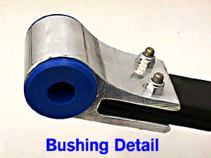

    Pretty good day on the parts hunting front. I had two great conversations with Spring companies: Flex-Form Composite Springs and Posies! I have been trying to talk to the guys at Eaton (as advised by several folks here on the HAMB and in my neighborhood as well...) but they don't want anything to do with my front suspension design etc. I am not sure if simply ***isting with one spring is beneath them or they are worried about liability & litigiousness! But either way they made it clear via email they would not able to ***ist. To be honest, I really didn't want their old 85 pound steel spring anyway...LOL!
    So the guys from Flex-Form were more than happy to discuss my application etc. I was pretty excited after talking with them as they sent me some pretty cool shots and specs of their custom made products. Including this very cool little bushing end that allows for old school shackle style mounting. Take about 4 weeks for custom springs but they said if I was in a hurry they would do what they could to speed the process up a bit. How about 60% weight savings front and rear
    Then no more than 5 minutes after hanging up with the Flex Guys, Posies returned my call from an email request I sent late last week. That guy was crazy knowledgeable about what I was trying to do and enthusiastic about the attempt. He said the early Triumph TR series car ran the same kind of set up as the early Cobra (Transverse Leaf Spring right to the upper spindle mount instead of an "A" arm. He said he saw no problem with my design but it would certainly need shackles as the round 1 Triumph and Cobra set up basically used the spindle as a shackle sweeping through the lower "A" arm during spring elongation. I am impressed. He said ods are the whole set up from the Triumph to the cobra was probably exactly the same (as most European sports car of the day tended to share technology. He said probably start with the Triumph spring and go from there!
