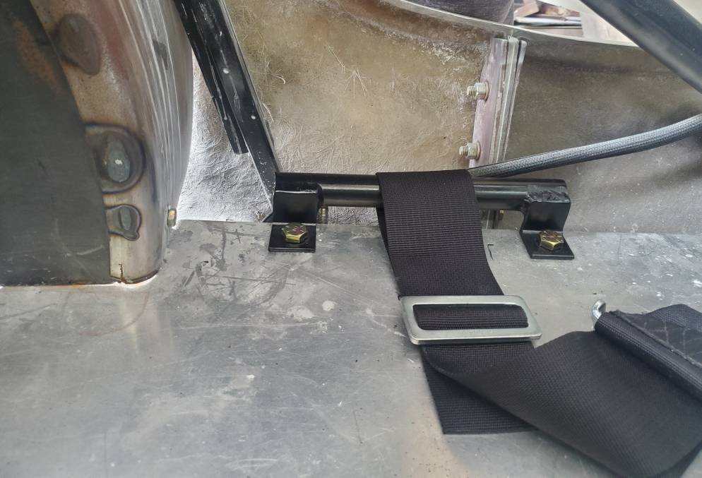

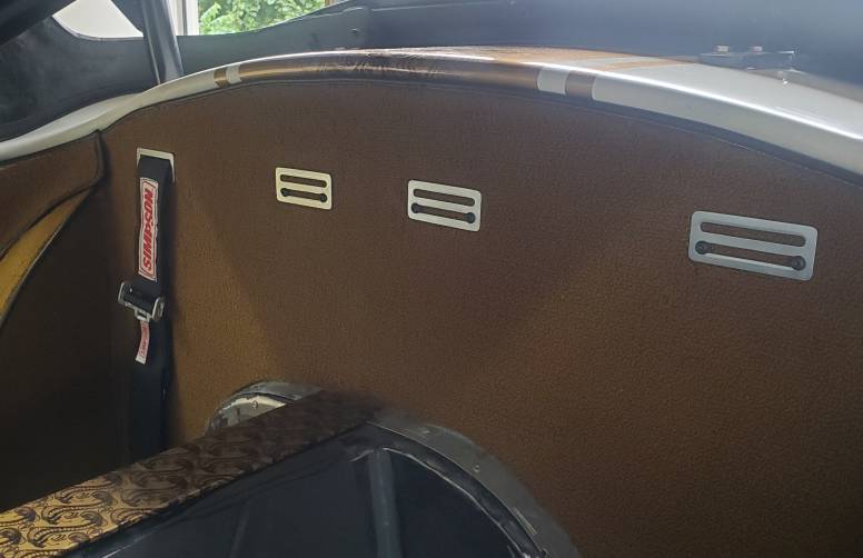

    So we are leisurely finishing the interior this weekend. The p***enger side is all but installed this morning. And the pieces with the binding look awesome!
    I was ready to install the rear firewall section for real when I decided at this point we really need to finish the safety harness on that side. Originally we were pushing pretty hard to get be ready to go the HAMB/SPAM Drags. I had planned to simple deal with p***enger side later.
    So we took a few minutes, placed, drilled and cut slits for the wrap around style belts to exit the ****pit and find the hidden roll cage cross bar. (Same as the driver's side shown earlier in this thread).
    Then we glued the carpet in and started installing entry plates etc.
    Using all the "extra" belt securing buckle plates we have to frame the entry points make for a very clean look.

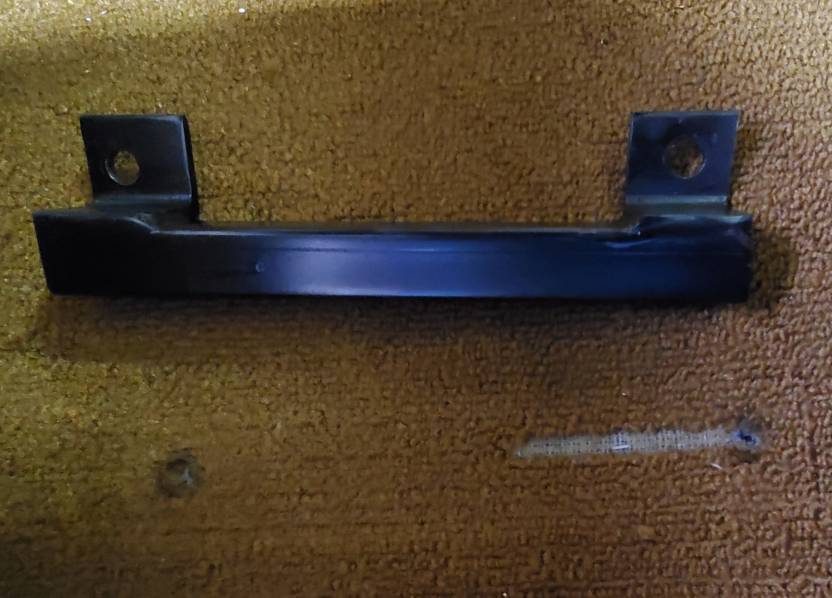

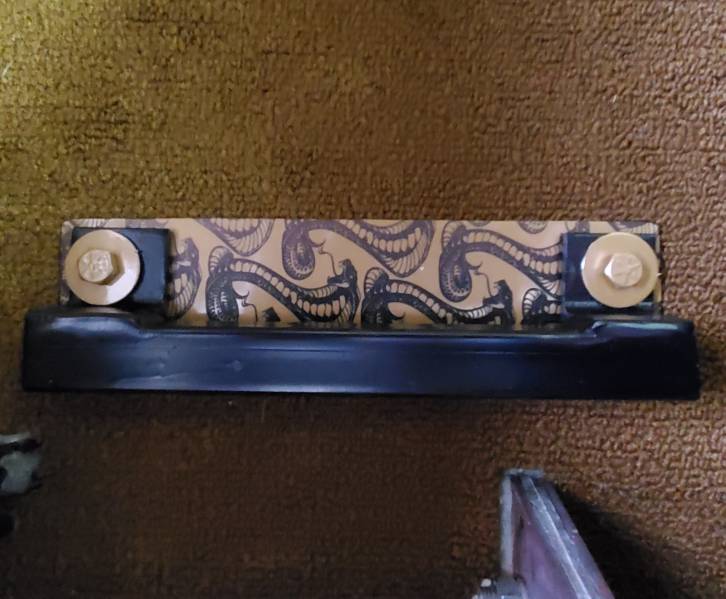

    I also jacked things up pretty good yesterday. To start with, I could not find any of the round tube I built the driver's side lap belt attachment apparatus with. Apparently I used the last few inches of it.
    Dad found some that would work but it was a bit smaller. My OCD simple would not allow me to do it. So I re-fabricated two knew ones that matched! Above photo shows the original top and one of the replacements out of square tubing below it.
    Now I only say that because here is where I stepped in it. These bars get installed on the floor just in front of the wells.
    Now the driver's side is ready to go but the p***enger side has not been drilled yet. The bars are designed with holes spaced to hit two of the ch***is outriggers.
    So I pulled the floor carpet back enough to expose this area. From below I drilled a pilot hole up through the ch***is and floor. Then from the top I drilled the 1/2" hole. Sat the apparatus in place and marked and drilled the rear hole.
    I pulled the carpet back in place and carefully cut openings for the holes with an exacto knife. Then I test fit it. The bolts went in and through but were a bit tight at the bottom, exiting the ch***is. So I removed them. Pulled the carpet back and went under with the drill to just wobble the holes a bit.
    Unbeknownst to me, the carpet had flopped back in place and the drill snagged a couple of strands and ****!
    So after much tool throwing and a quite a bit of cursing, LOL... I came up with this fix, since I have no more carpet!
    I have not decided if this is the final look but I had some of the stripe snake lace left over. I cut an aluminum plate that covers the run and wrapped it. I have one for both sides so they will match.

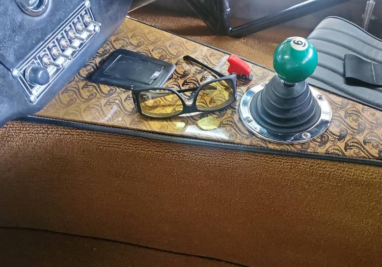

    Oh baby here is some killer inspiration! I finished installing the carpet on the driver's side floor and trans tunnel side.
    It looked nice. Clean anyway. Then I had an idea. Why not take the cool s***ched leather carpet binding and install it on the sides of the tunnel cover that sits on the carpet as it rolls under it?
    So I pulled it out really quick and installed the binding. I reinforced the back of it with black Gorilla duct tape.
    I put it back in place and WHAT a difference!
