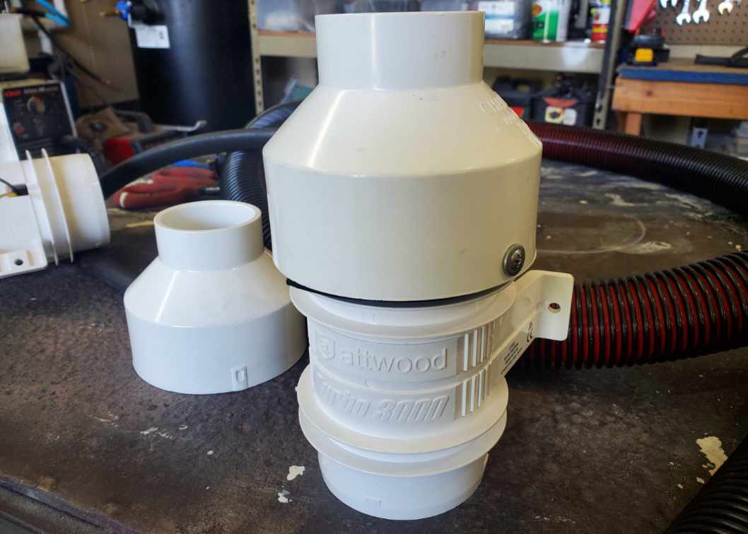

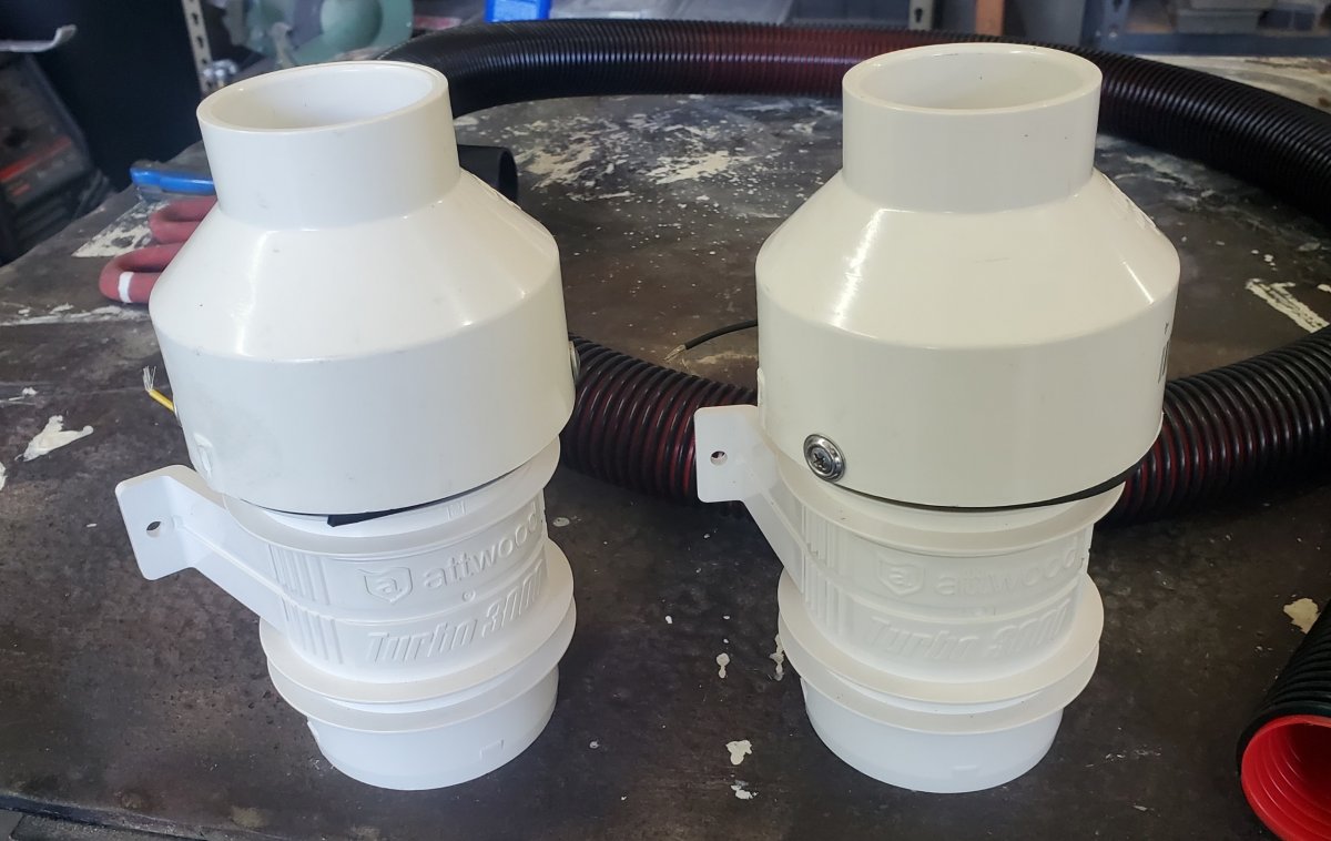

    Well the blower motors came in this week so this morning I decided to see if we could get them installed and functional.
    Before we started I headed to Lowes. I spent some time in the shop vac area but after looking at all the attachments etc. found very few parts outside of the hose itself that would help us. The only additional pieces I snagged were two 90 degree attachments. In their original application they helped vacuum a larger area, in my application I figure they will ***ist in making the turn at the corner and fan the air out a bit as well.

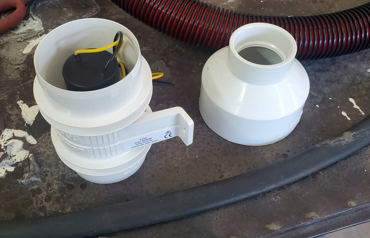

    I finally ended up in the plumbing section and started formulating a plan. The biggest issue was getting the 3" fans attached to a 1.5" hoses. The most obvious was simply a PVC reducer. I took one and tested it on the hose. It fit like a glove so I snagged a couple of them headed out.
    When I got home of course the 3" side of the reducer was designed for 3" ID pipe which has more like 3.5" OD etc. The then walled fan outlet was obviously a bit small. So I took some rubber weather stripping and wrapped it.
    After a couple of test fittings I found two full rounds made a near perfect gasket.
    After carefully working the reducer on the fan over the gasket (even though it was a very tight fit) I still drilled a couple of small holes and installed screws just to make sure it all stayed in place etc.
    I duplicated the process with the second unit and then we were ready to decide where and how to mount them.

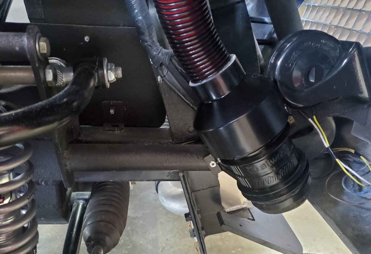

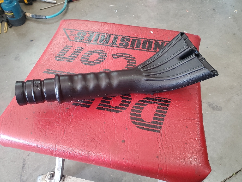

    I measured out the hose and cut it in half so I had 74" per side (more than enough). I layed on the floor for quite a while deciding exactly where to place them. We obviously wanted to make sure we were pulling clean fresh air etc. After finally deciding on both placement and how to mount them, I taped up the fan end and shot our new little blower systems black.

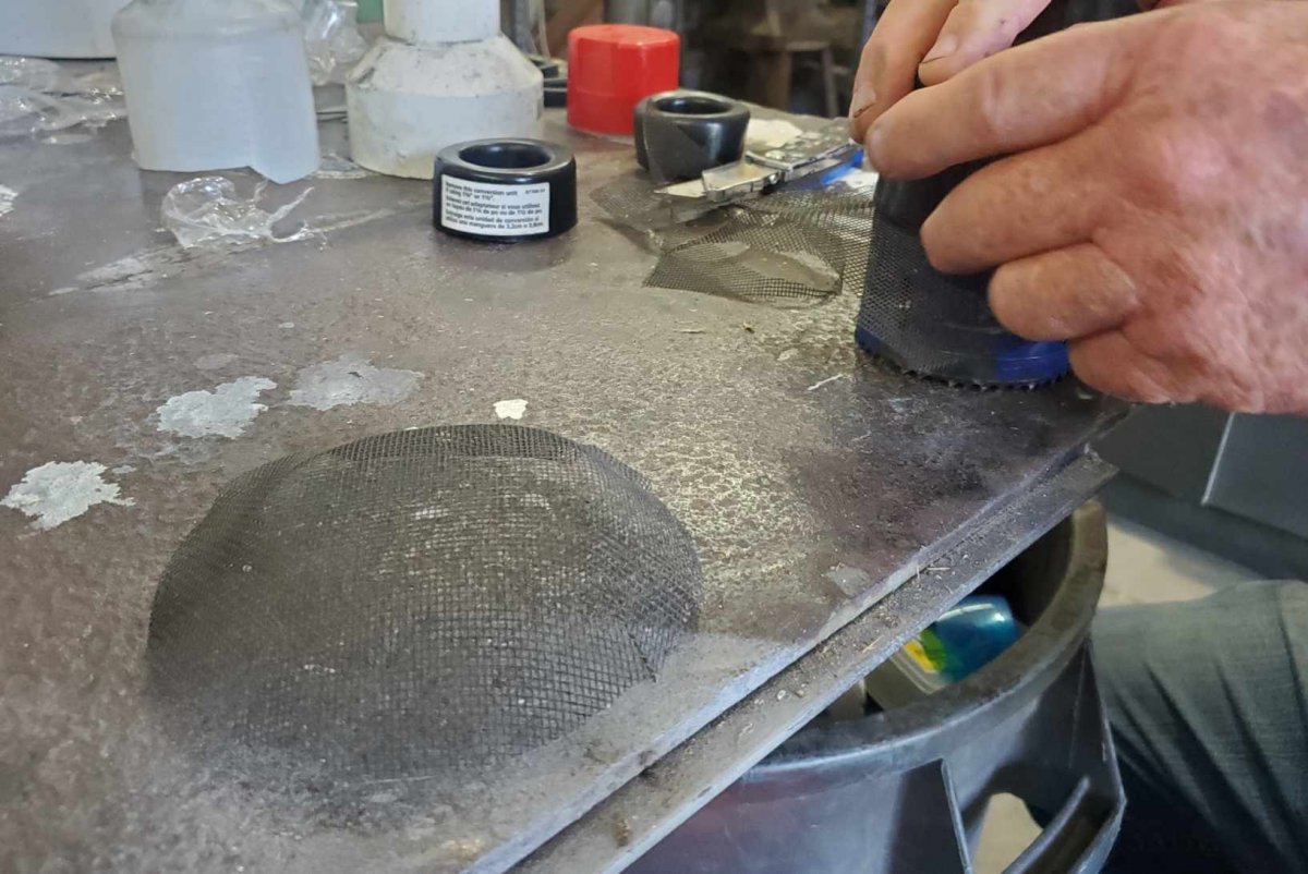

    While I was spraying them Dad took a 3" hole saw, some new black mesh screen we had laying around and roll of duck tape that just barely fit over the back edge (non tooth side LOL) and formed a couple of screens.
    With a zip tie, secured the screens in place and these little babies were ready to install.
    It is sort of hard to see the orientation but they are mounted near the sides of the radiator but angled down at about a 25 degree angle into the fresh air coming under the nose.
    We actually used the bracket I just fabricated a couple of weeks above for the horns on either side as the front mount point and pop riveted the rear. After they were both in place we ran and secured the tubing.
    As you can see our killer cool "special hardware" covers are in place and the 90 degree (angle not temperature LOL) attachment simple curves in around behind them. The air is spread across the devices and HOPEFULLY this will help them stay cool. At the very least, since these little blowers are embossed with TURBO 3000 I suppose I can say the car has twin turbos! RIGHT? LMAO!

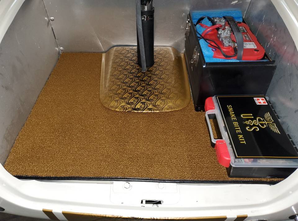

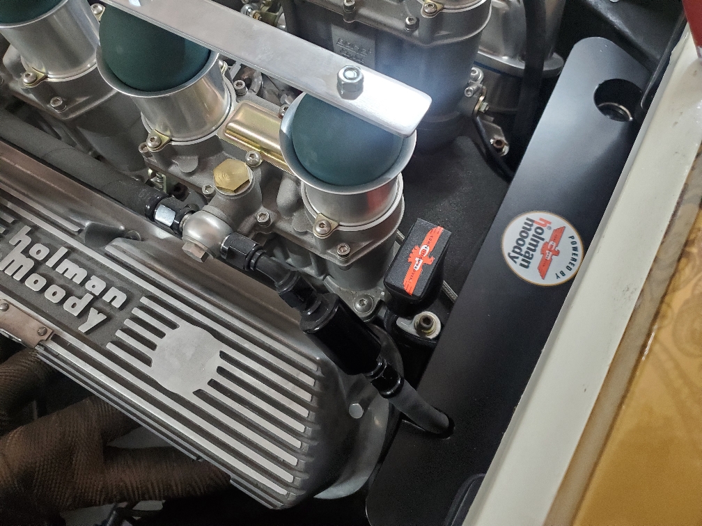

    Sort of a game of dominos today as since I was going to mount the louvred covers of our special firewall mounted devices I needed to install the lower plate as well that also hides tons of little HAMB sins. LMAO.
    It is a custom piece of polymetal (an 1/8" rigid substrate that we use all the time for flat signs). It fits perfectly behind the engine and covers the harness etc. It also has hole where you can see the fuel pressure gauge. It was supposed to have (and will have again) a custom Holman Moody production or firewall tag on it but I damaged it today. For now I just dropped a round decal in its place.
    It is extremely clean back there now as I s**** piece of Dynamat in front of the rear cover. It simply runs under the cover and onto the rear of the intake. It it basically just held in place by throttle cable on one side and wire to the alternator on the other. But it hides all the individual injector control harness ends etc. I am telling you, if you didn't know they were there, you wouldn't know they were there...if you know what I mean.
    I have not attached it yet, but that is where the VIN tag goes on the car, I have to find some smaller rivets.
    I am extremely happy with the engine compartment, it is very clean.
  27. loudbang
    Posts: 40,347
    Have you fired them up to see how LOUD they are yet? Some fans make a hell of a racket and vibrate quite a bit.
    Deuced Up!, Nostrebor and Thor1 like this.

    Do you have any concerns that your cooling fans will pick up and pump dust onto all of the electrical items you are trying to keep cool? I saw the screens to keep debris out, but you may want some sort of filter to cut down on dust.
    Just thinking out loud...
  30. Deuced Up!
    Joined: Feb 8, 2008
    Posts: 4,224
    Deuced Up!
    No not really. The two boxes in question there are sealed units. In fact both were designed to simply be placed on an engine compartment firewall etc. Having a little fresh, cooler air rolling across them will be a plus, a little dusty or not.
