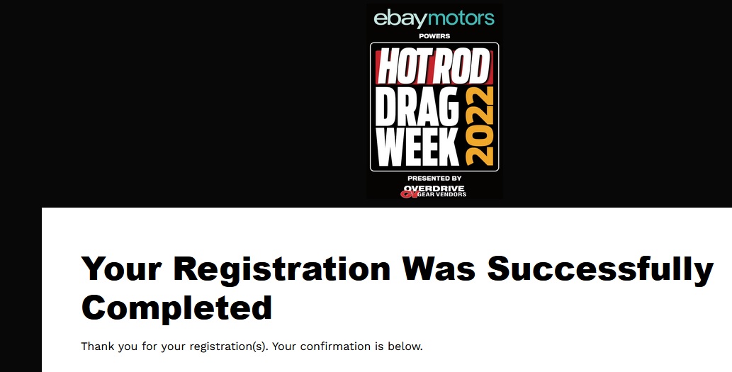

    Registration for Drag Week 2022 is now open for those who finished in the top 3 in their cl*** last year. I'm one of the lucky ones who was in a cl*** with only 3 cars, so my last place finish counts!
    Everyone else will probably get to sign up around March 5th, or something. They'll probably announce it ahead of time.

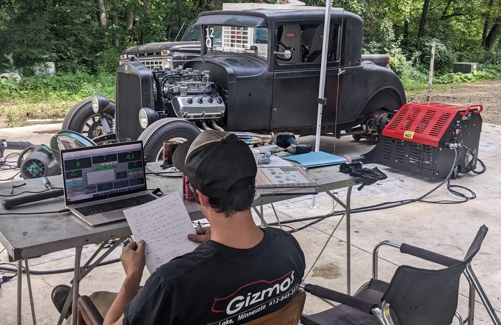

    The thrash for Drag Week 2022 has officially begun! After completing DW2021, the poor Hemicoupe has sat neglected for 11 months. I checked the valve springs, did a leak down test, pulled the tops off of all the carburetors and cleaned the needle and seat and checked the bowls for debris, put in new plugs, distributor cap and rotor, drained the fuel and flushed out the lines, added fresh gas and fired it up.
    Also, I figured out that the reason the car was going slower each day at drag week last year was because the throttle arms on the main cross shaft of the carb linkage were slipping on the shaft so I was getting a little bit less throttle each day. So my son Cam made me up some new throttle arms that are much wider where they clamp onto the cross shaft of the linkage and have two clamping screws on each instead of just one. I also knurled the shaft in the areas where the arms clamp on.
    The plan is to do some dyno testing and get the a/f ratio dialed in for each cylinder, learn where and what the peak HP is. Then dyno test a dual quad intake, and a short runner 8 carb Arias intake. Then make some test p***es at the track to work on dialing in the ch***is. Time is short, not sure how much I'll actually accomplish.
    We made 2 check out pulls today from 4000 to 6000 RPM, but there was a little bit of confusion between the driver and the dyno operator regarding when I should mat the gas pedal and when I should let off. Then I got a phone call about a family emergency so we had to quit for the day. Hopefully we'll be back dino testing pretty soon. Click on the link for a short video. PXL_20220827_183308297~2.jpg

    Nice dyno run, when can I bring my truck up? If I get my parts like I think I should most are here already, I will be putting my truck together Labor day weekend.
