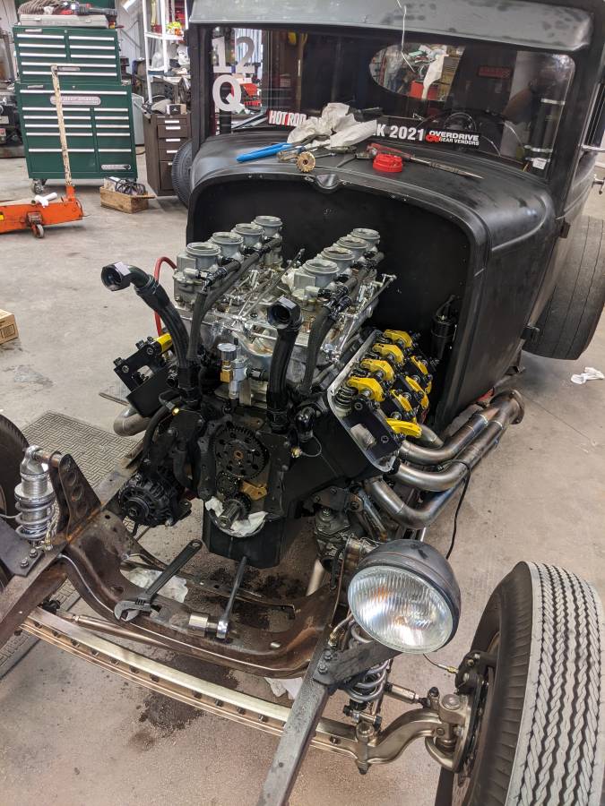

    Well, unfortunately the Hemi Coupe is out for Drag Week 2022.
    I looked at the pistons with a borescope thru the spark plug holes, and did not see anything wrong. Then I pulled the timing cover off and found the woodruff key that locates the cam gear on the cam was busted. I do not yet know what caused that. I put in a new key so I could turn the Hemi over enough to remove all the pushrods. I found a broken adjuster bolt on the #1 intake rocker. Then I did a leakdown test which revealed m***ive leakage, an indication that after the key sheared, the intake valves hit the pistons and bent.
    So I don't know if I'll get the 67 GTX F.A.S.T. Hemi 4 speed race car ready to race and bring that, or just stay home. The last time I drove the GTX race car was 2017, and it needs a clutch and some other stuff. There's not much time left to get ready.

    Sorry to read of your problems Joel but last Thursday you mentioned when you started the engine that it sneezed a couple of times, wouldn't this be when the key sheared?
