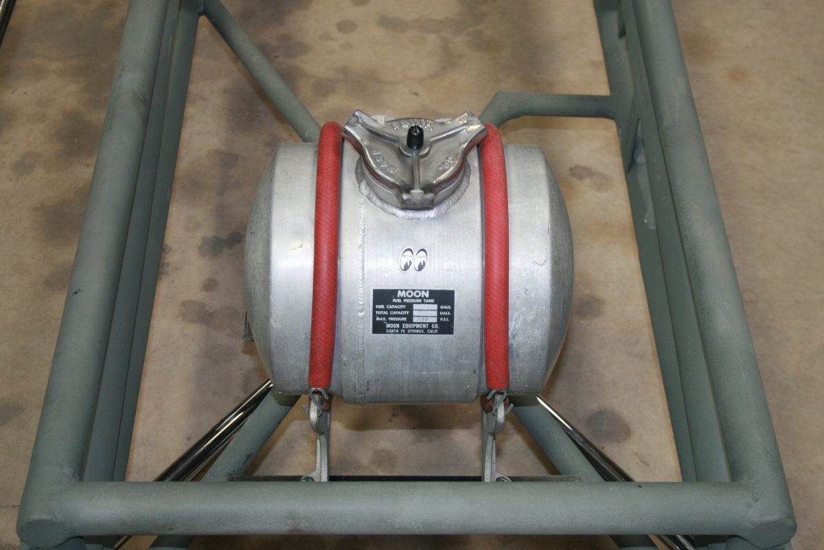

    After some time and searching I found the moon tank I was after. Moon makes an exact replica of this tank but I wanted an older one for the duller finish, and not the new look. It came with the original mounting brackets but aftermarket hold down spring straps. I did a lot of searching and p***ed on a few to get this one. It's a nice tank. IMG_2063.JPG

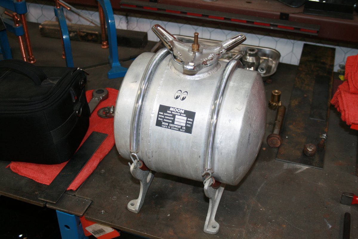

    I thought so. I didn't like the clear hose over the springs. The brackets have a red hose that is split to go over the brackets to cushion the tank when it's in place. I used old air hose that matched that color and used it in place of the clear. I think it looks better and kinda vintage. I changed the fuel cap, notice the spinners are cut down from the previous picture. Stay tuned for the cool history on this cap and other parts we found. IMG_2066.JPG

    Springs are a sick bird to NHRA had to go to clamps and ss strap better hold down and legal V8 insigna 01.jpg

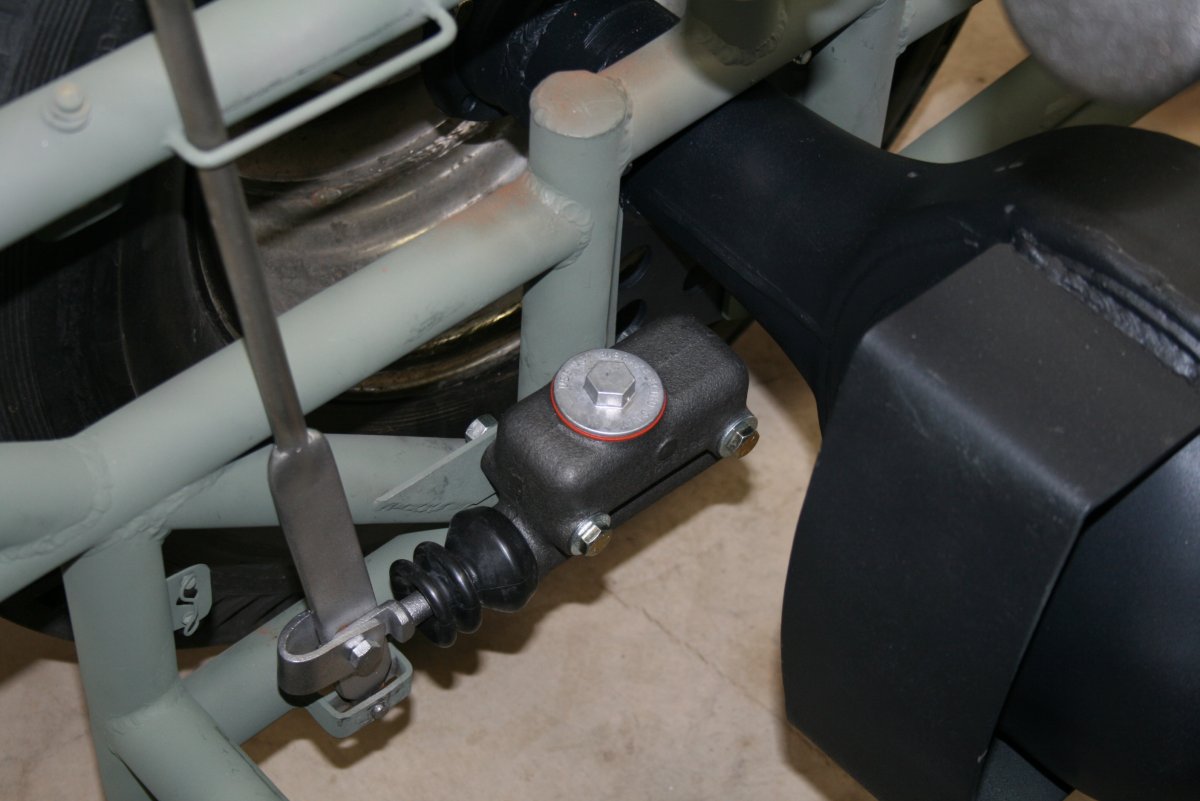

    Dode told me that they used early jeep master cylinders for their cars. They are the same from 1942-71. I got an NOS one it fit the original bracket perfect so did the plunger on the brake handle. We cleaned the brake handle and cleaned and painted the rearend. IMG_1863.JPG
