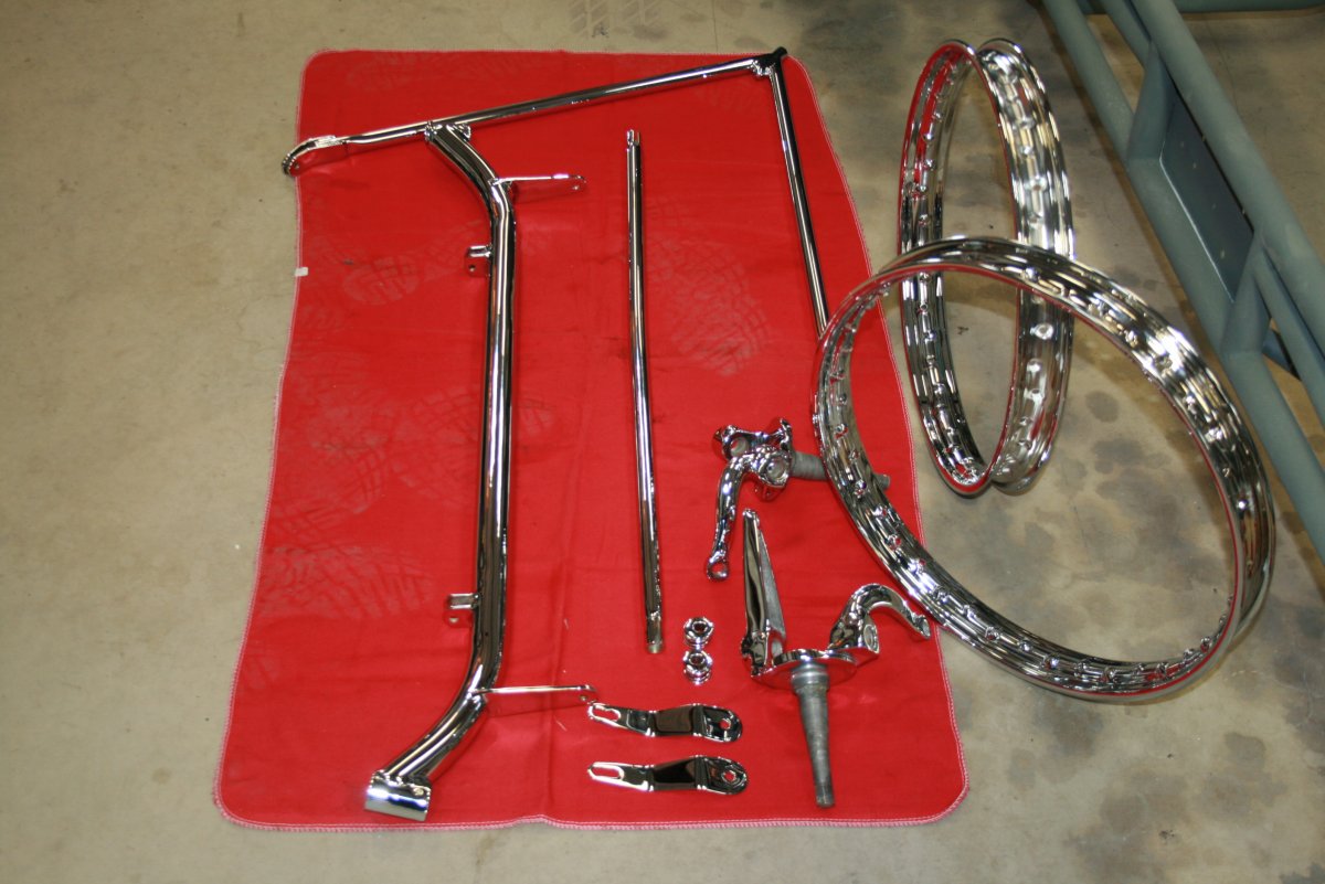

    Our parts came in from Speed Sport Chrome and the work was real nice. We had the original front rims rechromed even though the price of aftermarket rims was cheaper. The original front rims had "Made In England" stamped into them. IMG_2051.JPG

  2. 1947knuck
    Joined: Sep 4, 2011
    Posts: 5,458
    1947knuck
    The front end is together and mounted. IMG_2053.JPG John had new king pins left over from a build that we used.

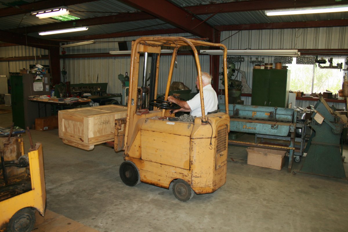

    John got the engine and heads completely stripped and magnafluxed and the Flamethrower distributor checked out on an old Sun machine, it needed the points adjusted. He modified a Govt. shipping crate to hold everything for the trip. I called Dode in advance to arrive on a time he expected. Dode and Jimmy Scott unloaded the parts with a fork lift Dode calls Smokey. IMG_2032.JPG IMG_2033.JPG

    We got the parts unloaded so Dode could look them over and left the crate with him to pick up when we went back for the engine. IMG_2034.JPG IMG_2035.JPG IMG_2036.JPG
