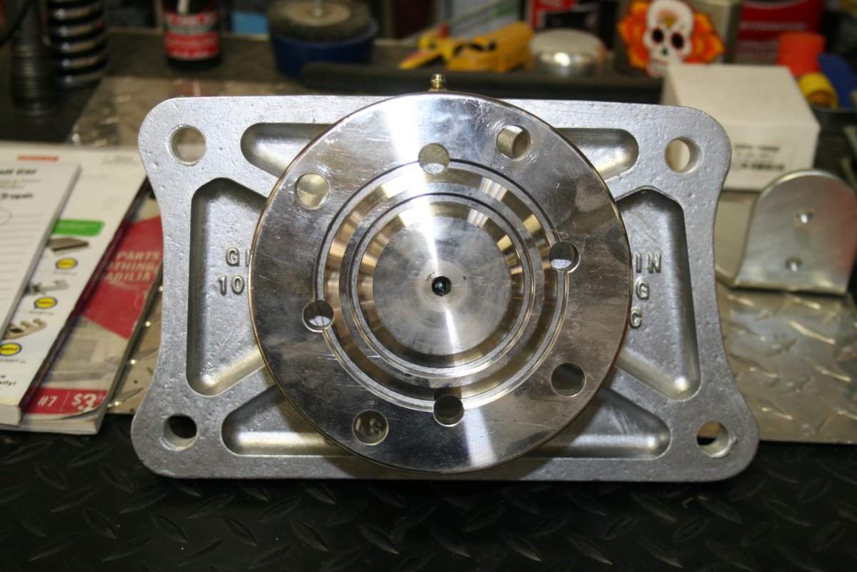

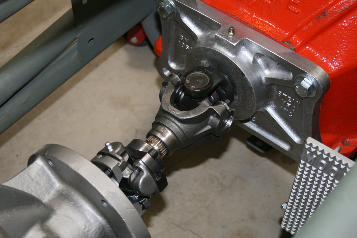

    We decided at this point to have the driveline built to line it up before bolting the engine mounts to the frame. I wanted to modify a PTO, I discussed my ideas with a company that builds driveshafts and decided on this. I had a PTO built with a hardened shaft and had the standard driveshaft face left on until everything was measured. IMG_2105.JPG IMG_2106.JPG

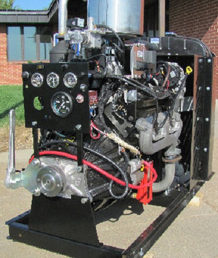

    I first saw one 30+ years ago on an irrigation engine, their used to engage and disengage the pump drive using a hand lever. It simplified the work for our direct drive. Here's a picture of an irrigation engine with a PTO. 7d195f_96f78738eed8474c9be37386f42646a6.jpg

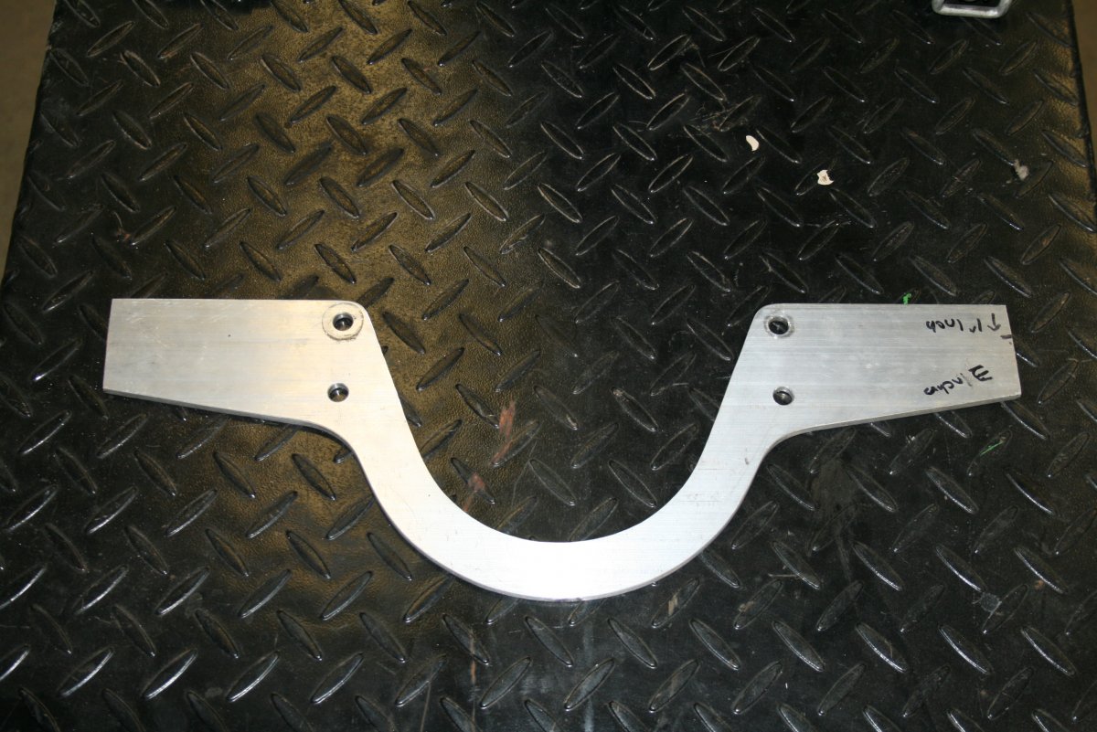

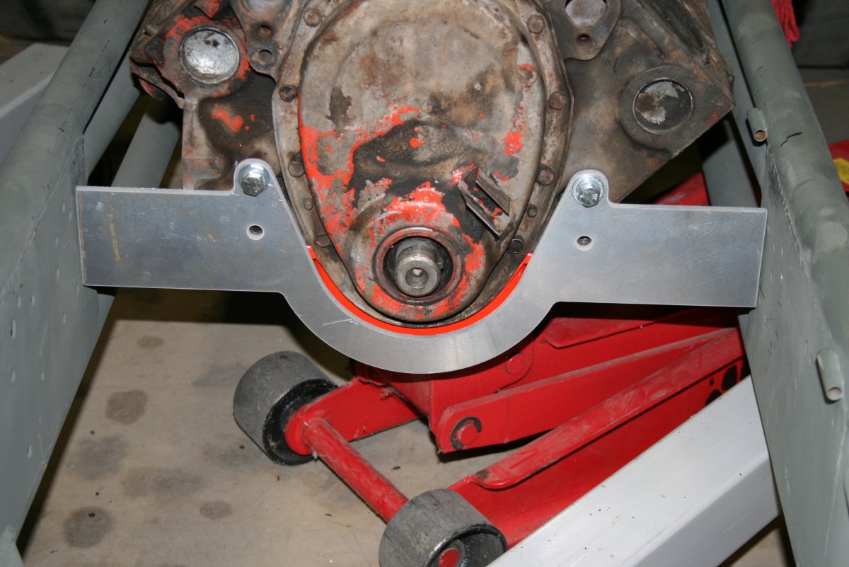

    While the PTO was being modified and the driveshaft built, we moved to the front engine mount. We were going to use what I suppose is a fairly standard front sbc mounting plate except the arms going to the frame were too high. We made a design using the standard plate as a partial pattern to build one with lower arms that better fit the frame. All we had left to do was tig the angled ends to finish the mounting plate. IMG_2110.JPG IMG_2111.JPG

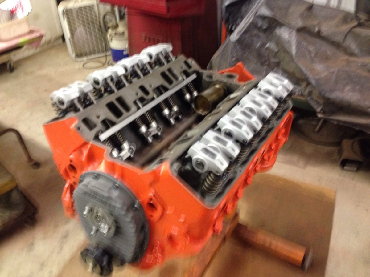

    While we were waiting for the driveshaft and PTO, Dode sent us a picture of his progress on the engine. The picture was taken by his friend and although it's blurry I thought I should still post it. I called Dode the same day and he told me everything was going good at his point, that the rockers were just sitting in place while he tried to work out a way to fit all this under the stock corvette valve covers. thumbnail_IMG_0348.jpg

    Better to bolt the plate to mounts on the frame itself, welding onto 6061 alu draws the heat treat down and you are dealing with a part thats loaded

    The Driveshaft builder called our parts were ready to pick up and check the fit. They machined the driveshaft side of the PTO to fit the yoke flush. Because of length restrictions the driveshaft at this point was basically a slip yoke. It was left that way so if we made any minor changes and it needed to be a little shorter or longer we could adjust it. Once the exact length was set they would weld a small diameter tube between the yokes keeping the slip joint in place. IMG_2112.JPG IMG_2113.JPG

    We explained how the engine plate was going to be used with the welder so he welded the ends on the plate using 4043 filler wire and then we had the piece heat-treated.
