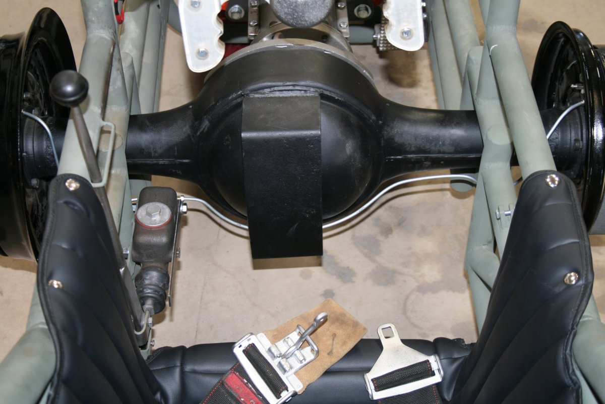

    Are you planning for rear end anti-rotation?

    Did you consider ujoint phasing?

    This picture of the frame shows where the rear end bolts in place. The rear ends mounting plates are welded on. When in place the rear ends mounting plates fit tight between the frame tubes and are on the inside of the frames mounting plates using 6 bolts on each side to secure it to the frame. There's no chance of rotation once its bolted in place. You can see the rear end in this picture standing on end with it's mounting plates. IMG_1995.JPG

    The driveshaft as pictured in an earlier post did not have the u-joints lined up as it was built to be. We had it off a number of times measuring and lining things up and had just slipped it back together. Both ends were marked when it was built and afterwards the difference between the front and rear u-joint when slipped together correctly was 0.2 degrees. The builder told me phasing specifications are it can be no more than plus or minus 3.0 degrees so ours was good to go just be sure when we ***embled it that we lined up his marks if we weren't going to have him weld a tube over it when we were finished.

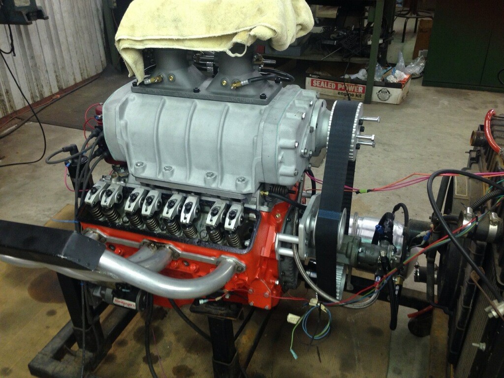

    Shortly after Dode had the blurry picture sent of our engine progress my son received this updated picture. Dodes friend was sending the pictures to my son's I-phone since I have an old flip phone. I called Dode after John got this picture and he told me the engine was going fine it just needed the belt tensioner and some other minor parts. I thought this picture was so cool. thumbnail_IMG_0356.jpg

    Well you have to share with us how did he get all of that stuff under those Corvette Valve Covers?

    I should have thought to send you the adaptor that I made when I was working on the latest cackle car build at my shop. It bolts to the front of the M/T third member and also has the same bolt pattern as a 9" Ford pinion support so that a standard line up bar can be used. Having a U jointed shaft will make alignment less critical in your case but it it here if you ever need it.

    John got this picture and a message to call just a few weeks after the last picture. Dode said the engine was ready, it had been test run several times, the final adjustments were checked and that it was a screamer. Dode ask what day and time I could be there, he wanted anyone that helped with the build to be able to be there if they could. thumbnail_imagejpeg_0.jpg
