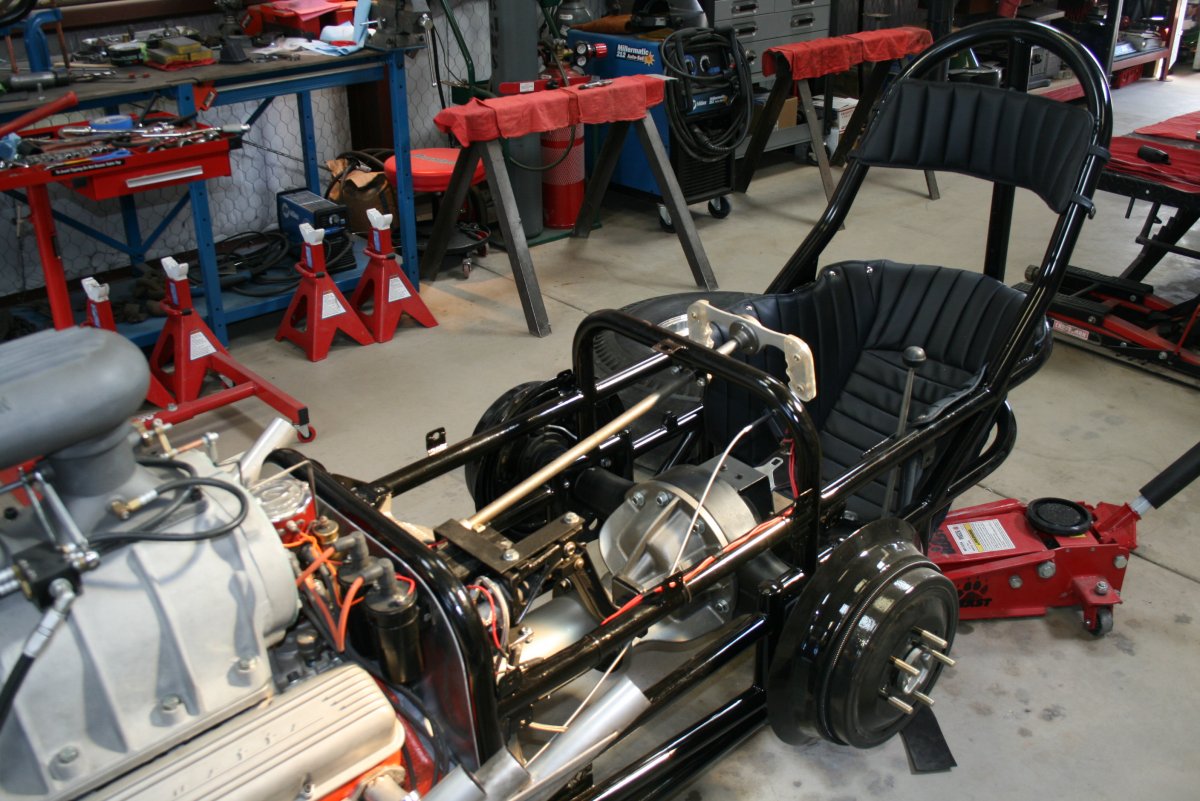

    Our plans for a painter fell apart, we discussed our options and decided my son John would paint it. Although he or I had never painted a car John has a new paint gun he'd bought years early and never used. We talked to several old time painters that told us both lacquer and enamel were used back then and it wasn't uncommon for some racers to paint their own cars in their garage. We set the frame on saw horses at our warehouse opened the garage door for ventilation and extra lighting, followed the mixing instructions for enamel then John sprayed some test panels to get a feel for painting. The frame was painted first, let dry for 24 hours then visually inspected for any corrections. It had some light areas that John went over and when finished it looked good. Painting a tube frame from all those angles was a trip but it turned out real nice. IMG_2194.JPG IMG_2195.JPG

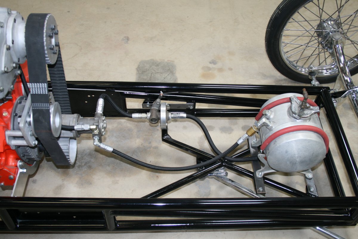

    With everything painted we ***embled the car minus the body panels until we had the throttle, clutch pedal, battery and driveshaft housing cover installed, along with the on-off switch wired and checked. IMG_2197.JPG 17190374_1299006200179176_1398468183921890288_n.jpg

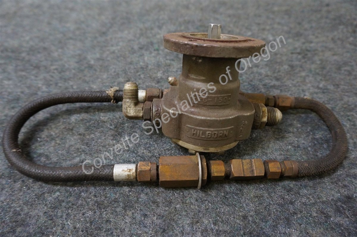

    I found this picture of a Hilborn pump with what looked liked the original fuel line. I called Hilborn and they told me this was the correct line and Redhorse Performance was the place to get the fuel line and fittings. I cleaned the new finish off the fittings to give them a natural finish and ***embled the hoses. s-l1600 (2).jpg IMG_2205.JPG

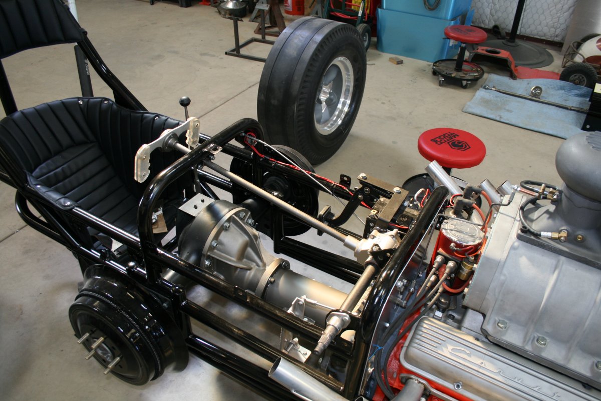

    We installed the driveshaft shield, battery, clutch and throttle linkage, checked for any final adjustments then mounted the coils and secured the firewall. We have the slicks off to ease installing the bottom body panels. IMG_2202.JPG IMG_2207.JPG IMG_2209.JPG

    What did you use to clean the fittings, I'm guessing they were painted? And what size lines are you running?

    The fittings as the came from REDHORSE PEFORMANCE had an anodized finish that resembled chrome. I used a real soft fine gl*** media to blast the fittings to their natural look, then used a wore out fine wire wheel to buff the newly cleaned look and dull it down, they came out alright. The size of the hose and fittings from the bottom of the Moon tank to the Enderle fuel filter/shutoff and up to the Hilborn pump is 08. The lines and fittings from the pump to the injector and the one back to the tank are 06.

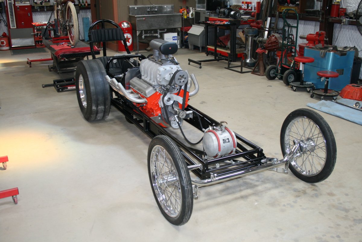

    With everything in place and adjusted we installed the body panels. Check out how the top body panel fits around the steering shaft. John measured, marked and cut the hole before painting it, it came out perfect. IMG_2216.JPG IMG_2218.JPG
