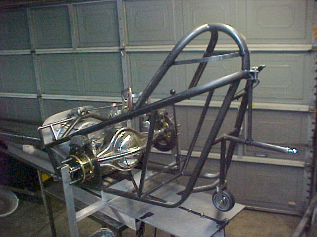

  20. budssuperpro
    Joined: Jul 30, 2008
    Posts: 391
    budssuperpro
    Here is some pics of my Front motor cars, car one is a 5 point and the other is 6 point
    I built the 5 point in 1990 and the 6 point about 3 years ago.
    I have a copy of the sfi Quality ***urance Specifications manual if I can help you at all
    The 5 point was a certed ch***is but I won't spend the money to cert the 6 point I built it out of 4130 and overkill on some of the tubing with .065 wall like the uprights. the sfi sticker won't keep me from getting hurt only being stupid at the wheel will,Don't let the wrong Head do your driving for you if you get my point.
    Good Luck
    Bud
    so build it safe, I try to put my personnel touch in it that makes it one of a kind look close and you will see what I mean. no one builds anything on my car but me
    thats just the way I am a Retired Boing Quality Engineer
