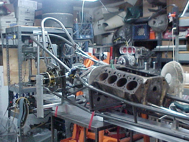

    nice 10-11 second ( maybe 9 ) old style dragster suits my needs just right,,of course the whole idea is to go FAST,,but I know I would'nt feel comfortable or safe in one of the older cars at some insane speed...
    Think alot of times Dragster gets lost in the meaning and the years of evolution
    There are limitations too all frame engine combinations,,I think know that and knowing when to not cross that line so to speak makes all the difference in teh world
    also look at it,,in the evolution of teh whole thing the frames got thinner and the motors bigger and or more of them,,which had many fatal flaws and hence a pressing need for stricter rules and safety features
    This frame is 3 inch OD main tubes and most of the rest 1 3/4 od,,using a proper motor this car should still be considered safe
    How anything like this was allowed to run I have no idea ??
