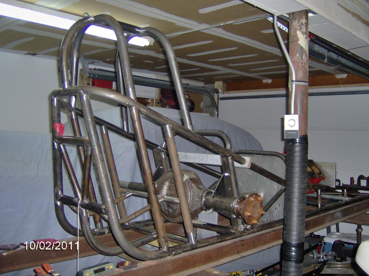

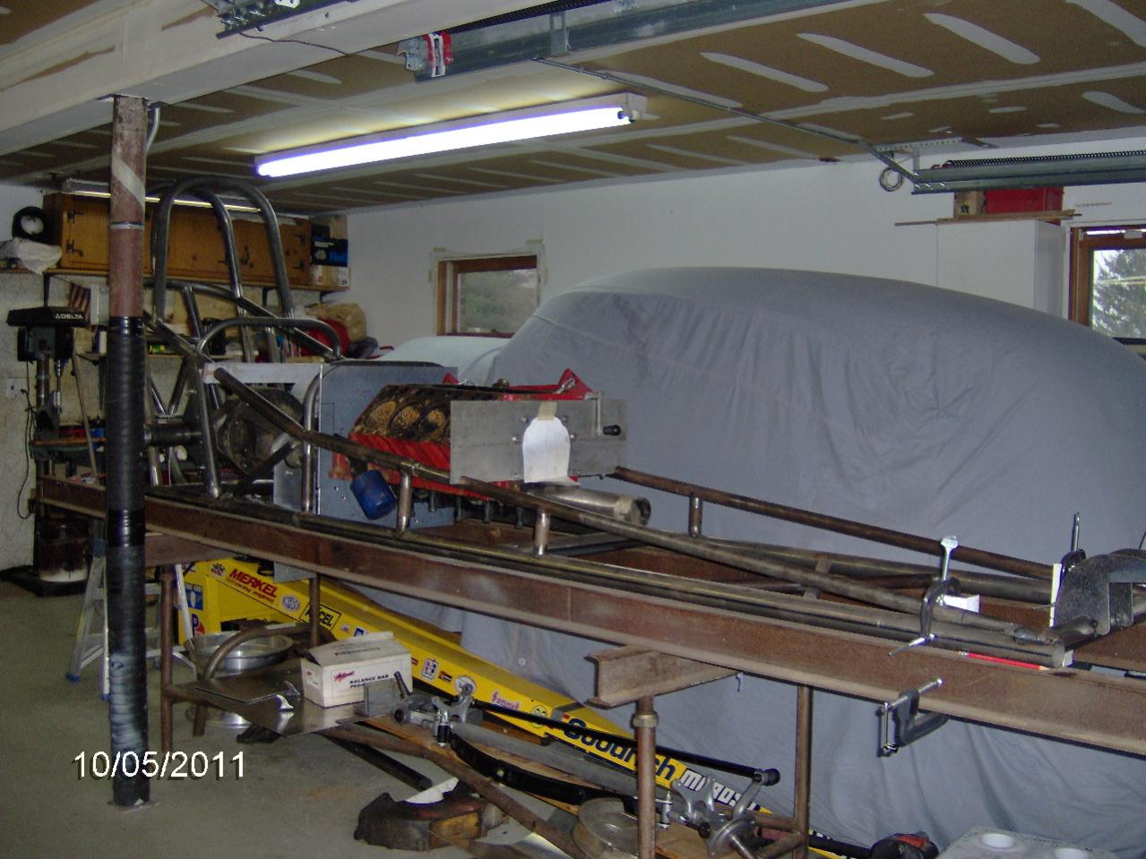

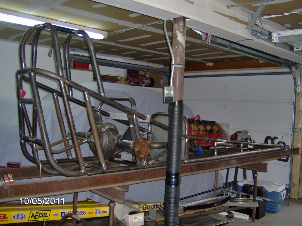

    sure here are a few of the ch***is alone
  15. Koz
    Joined: May 5, 2008
    Posts: 2,786
    Koz
    Lots of changes there! I know you can't run anything without a double hoop anymore. I need to take some pics of mine which is built pretty much exactly like the plans show.
  16. Koz
    Joined: May 5, 2008
    Posts: 2,786
    Koz
  17. Dustin0330
    Joined: Jun 9, 2009
    Posts: 16
    Dustin0330
    from Georgia
    I would love to see a few pics! I'll definitely have to change the whole design but Im looking to keep the dimensions the same. I plan on using a Cadillac 331 engine 39 Ford 3 speed trans and Olds rear in the ch***is built exactly like the blueprint.
