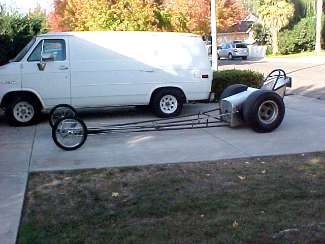

    Roo, I have a question. Is the lower / bottom frame rail/tube required to be one piece front to back to get a 7.50 cert. Or can I go from REC tube to round tube behind the rear end. I really don't plan on getting in the 9's but ya never know! Please excuse my crude drawings:D Rocky
  6. rooman
    Joined: Sep 20, 2006
    Posts: 4,045

    Rocky,
    the drawings are actually pretty cool. The SFI 2.4 spec calls for a minimum lower rail diameter and wall thickness and that extends only to just ahead of the mid plate--the rest of the car is up to the builder. That said, trying to effectively splice the rectangular rail to the round may cause some problems. I normally build all my cars to the SFI 2.2 spec so let me investigate a little further and get back to you.

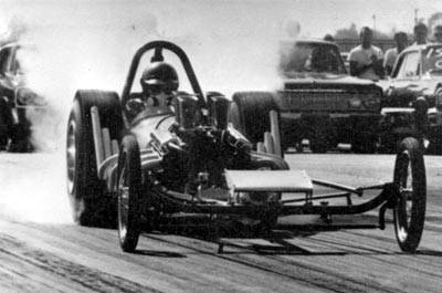

    I used to own this car:( It was raced as a Jr Fuel by Rance McDaniels, I put my little Ford in it and bracket raced it for a while. Sold it like a dumb a$$ young kid that I was, would love to find it but I guess I'll build one.

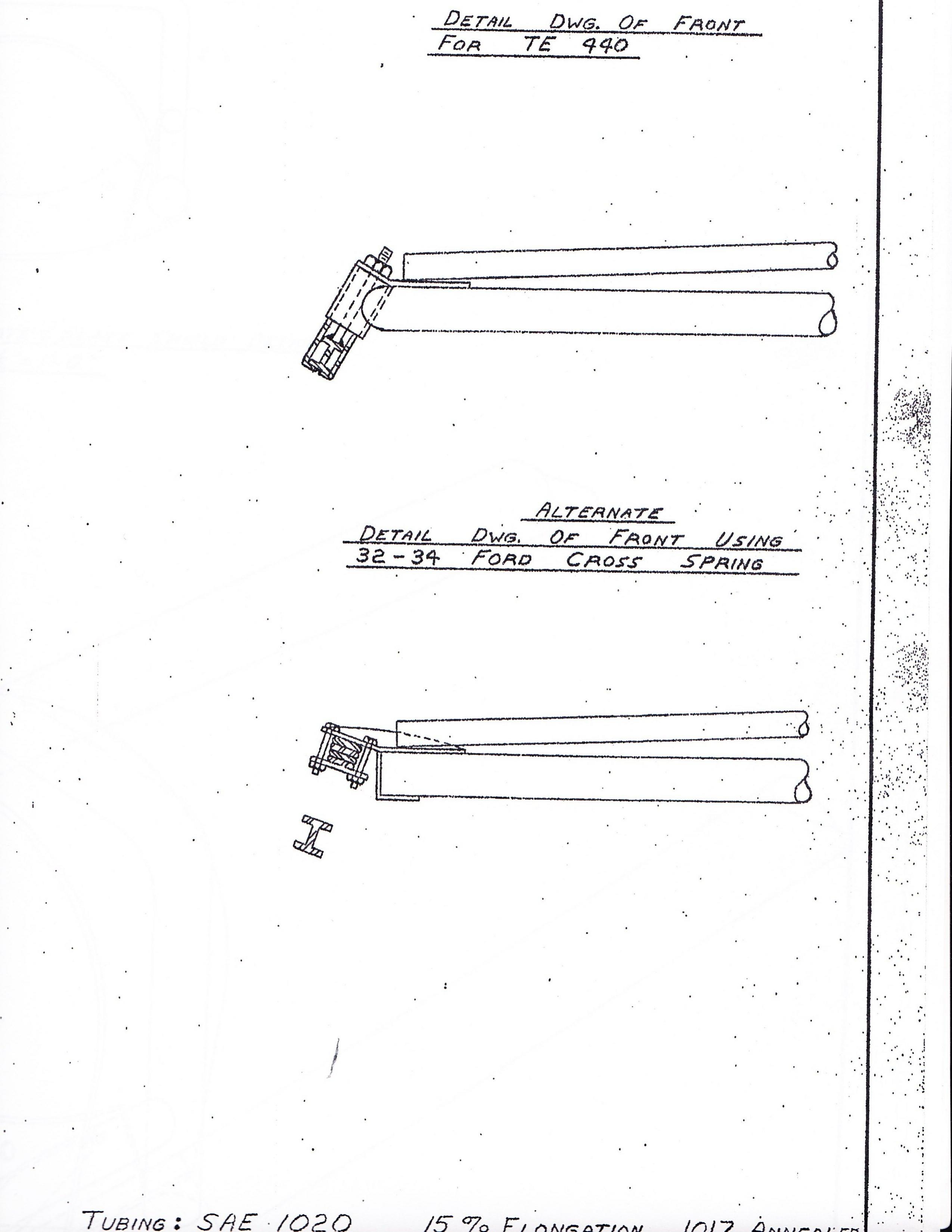

    The early version TE-440

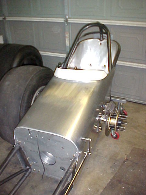

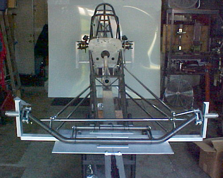

    Roman I want to build a 225" car the thing that I worry about is how to figure the sag in the middle how much arch to put in it is it just trial and error. Also how did you do the very front of your rails where the axle attaches. Iv'e built a few door slamers this will be the first skinny car.

    I had a TE-440 with this front end, but the local tracks and NHRA banned it for some reason...so I welded a spring perch to the top of the front tube and mounted a Culbert straight axle and mated it with the original radius rods, set it at around 20 degrees caster, worked well with an unblown Ardun.
  22. riceman
    Joined: Oct 8, 2006
    Posts: 743
    riceman
    Here is afew from my files on Rance. Bob Berry and Rance raced it. 2 differrent cars

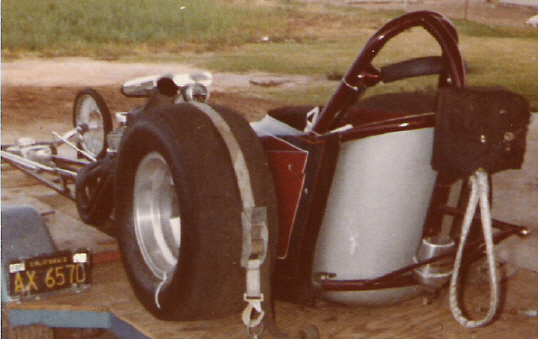

  24. Toymaker
    Joined: Mar 26, 2006
    Posts: 3,924
    Toymaker
    from Fresno,CA
    The 2nd photo racing Kaplan I believe is my car:(. I found the photo on WDIFL a while back and my heart sank! I still have the brake Handle and very cool wood wing off the car to remind me how stupid I was. Rocky
  25. rooman
    Posts: 4,045
    rooman

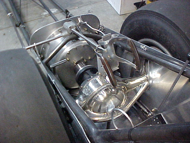

    I run a solid mount axle on most of my cars (although the one on the jig and the next one are both torsion bar deals). I use a piece of streamline tubing between the top and bottom rails to mount a saddle and bolt the axle to that.
    The photo should give you an idea of how I do it. The axle is bushed and there are bosses on the saddle where it all bolts together. This is Brendan Murry's T/F car with a removeable front clip so that it will fit his trailer.
    The arch in the frame is as you suggested, a matter of having built a few of these cars and knowing what is needed as per engine weight and position.
    Roo
  26. Larry G.
    Joined: May 3, 2008
    Posts: 22
    Larry G.
    Thanks Roo I never thought about using streamline tube there do you offset the wheelbase. I looked at a Boulton car Troys old car if I remember right he welded the axle to the ch***is I didn't like that dumb things happen and it would be a pain to change an axle.
  27. rooman
    Posts: 4,045
    rooman
    Larry,
    I usually don't stagger the front wheels but it is fairly simple to lay one side of the axle back a little if that is required--just roll it in the bender a little when doing the second bend.
    The removable axle is nice if you want to plate it and it is also easy to replace in the case of an incident. Jim Gravitt stood his kid's car on the chute pack at Havana and then dropped it hard. I just bent up a new axle, bushed it to match the old one and it bolted right up.
    Roo
