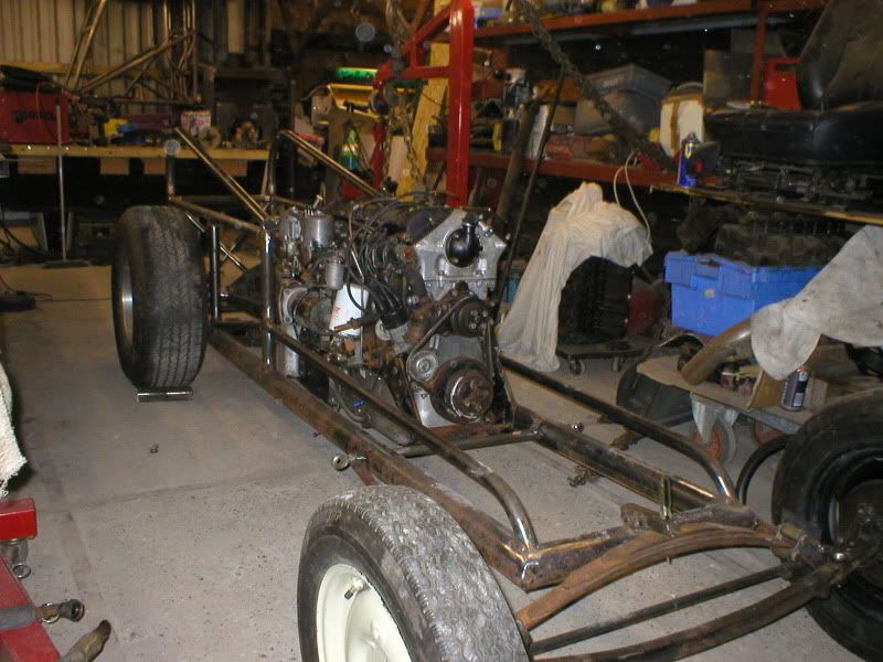

  28. 296moon
    Joined: Oct 24, 2007
    Posts: 654
    296moon
    from england
    Heres my effort, built from plans in my head and parts that I had, probly wont go quick but should be fun [​IMG] [​IMG]
  29. I like the Jag engine. :D There are others on here using them.;)
