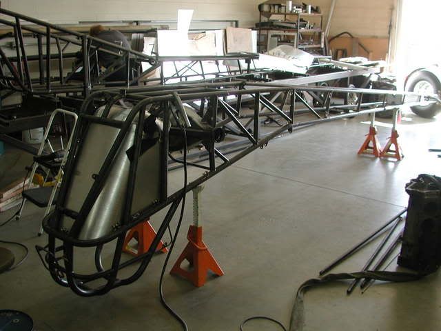

    These frames are not totally retro but about as close as you can get and p*** the current certs. As shown they will cert to 6.0 and with the addition of diagonals in the rear axle bay they are good for as fast as you can go. Moving the bottom of the front cage hoop forward as per Conder's Pete Ogden built cars would make them look a little more old school too.
    Roo
    This is a 200" wheelbase frame that we did a couple of years ago. The six point flat top cage is the only thing that spoils it appearance wise. The frame on the jig in the background is a shorty 185" unit.
    The car in the foreground is one of mine (Mark Vaught) and the other is Mike and Troy Coker's Boulton ch***is. The red car in the background is my 1970 Don Long[​IMG]
    The kidney bars below the shoulder hoop ***ure that it will p*** tech and in this car provide a mounting point for the wheelie bars as well.
    Too much electronic **** but at least the basic frame looks suitably retro and will certify. I have an Autocad drawing of this car if anyone is interested or we can build anything from a welded frame to a complete roller.
    Wishbone front ends may be lighter but we like the retro look of an axle.

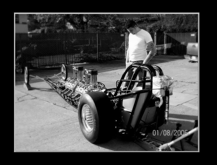

  19. BAD *** POST!!!!!!1 Hopefully one day I will have one of these. Hey I got an idea, anyone want to trade a rolling ch***is for a 40 merc? see my ad in the cars for sale.

    This has to be the coolest photo I've seen in a long while. thanks for posting it on this great thread. Is this dragster the one I've seen at Flathead Jack's?
