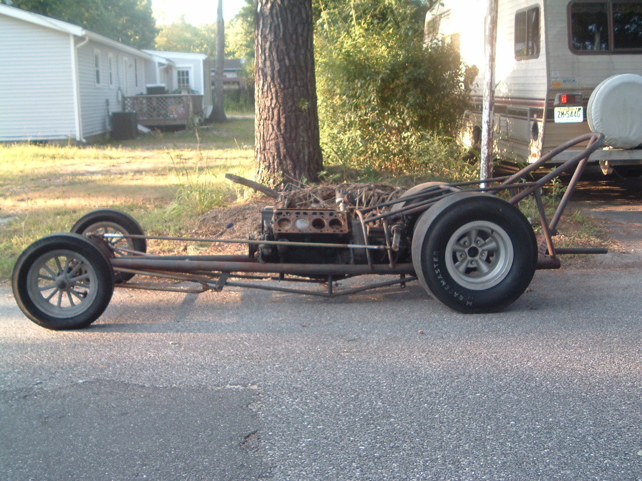

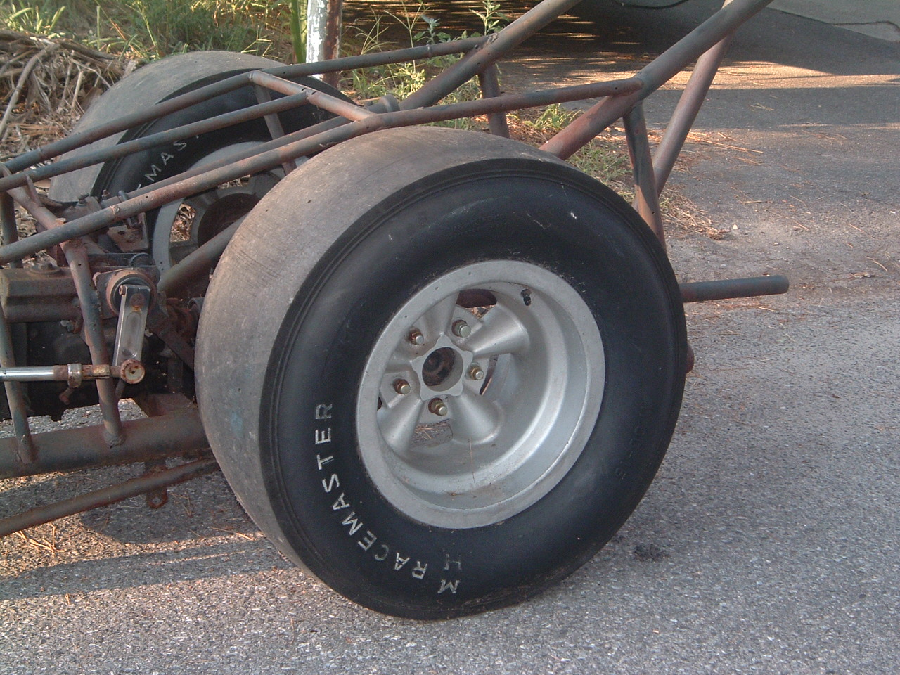

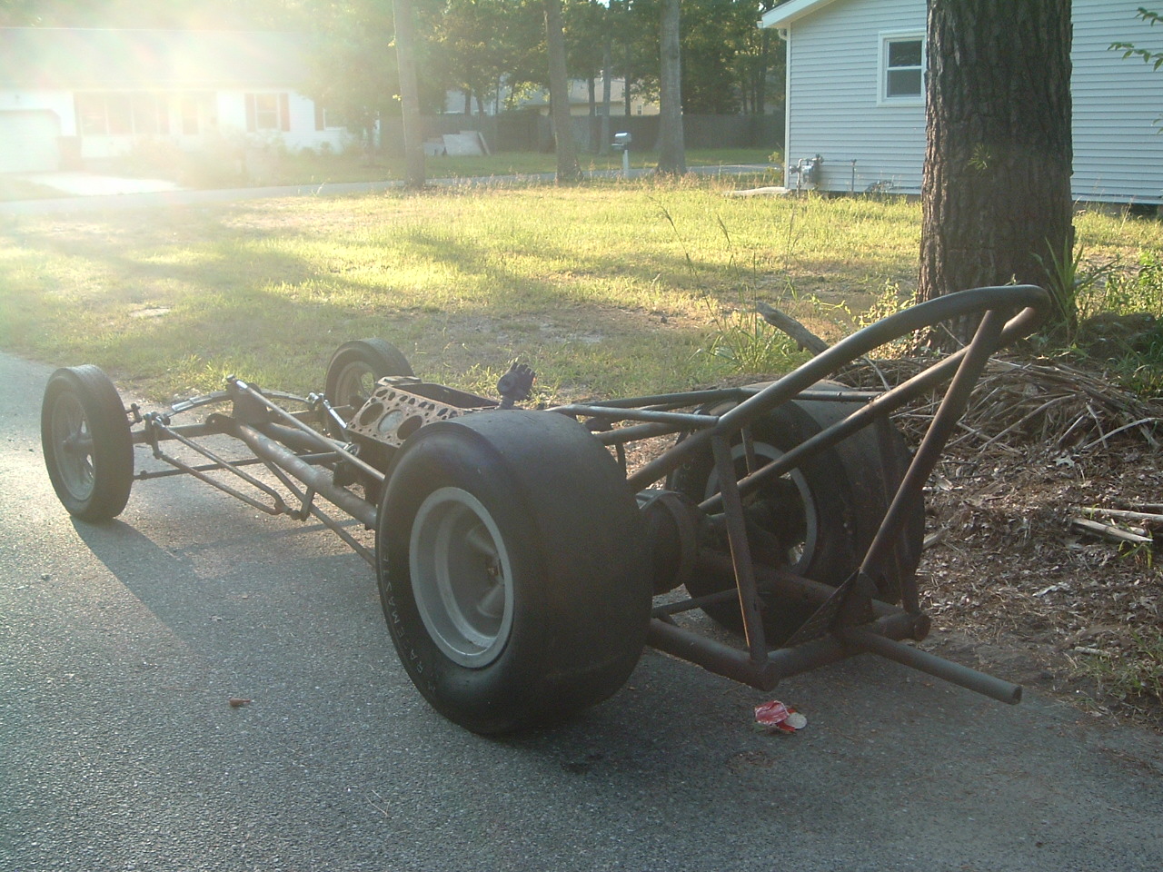

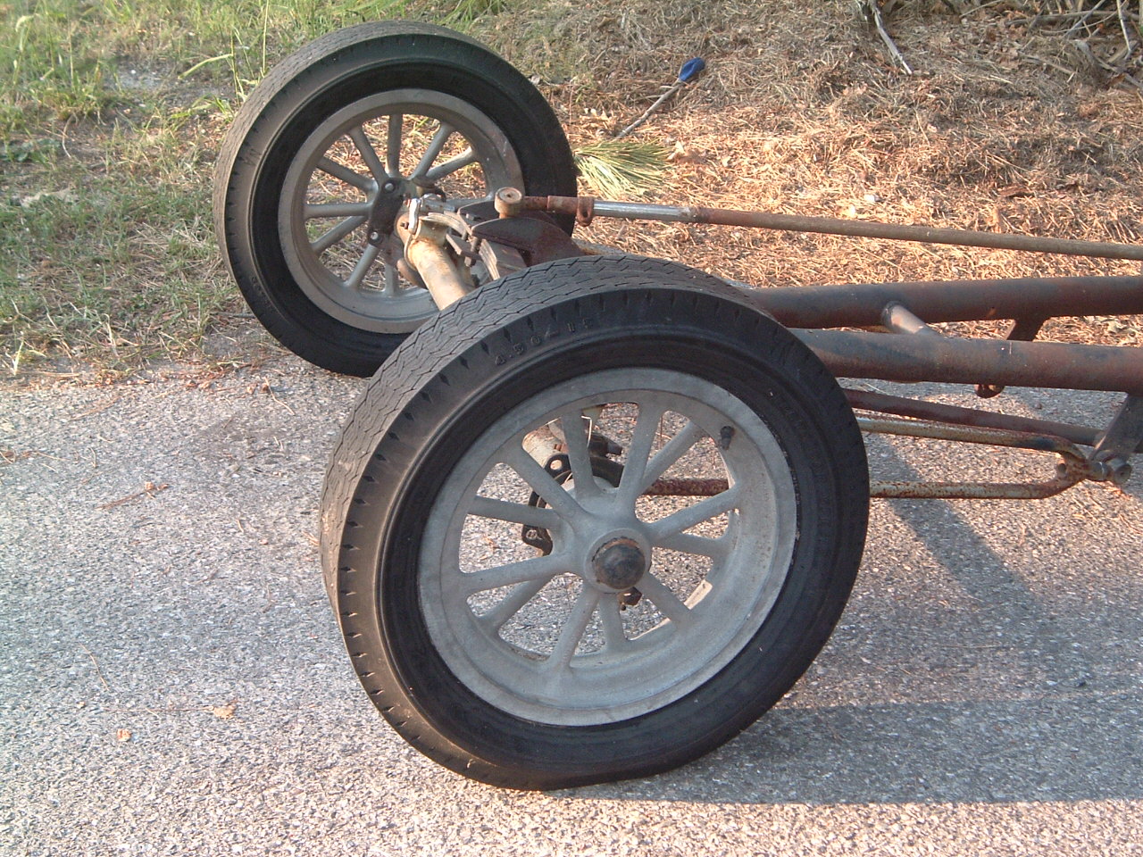

    My Ch***is Research K-88 frame was brazed.
  7. rd martin
    Joined: Nov 14, 2006
    Posts: 2,469
    rd martin
    from indiana
    wow, never saw that before? got ant pics?
  8. C/Gas55
    Joined: Mar 21, 2006
    Posts: 133
    C/Gas55

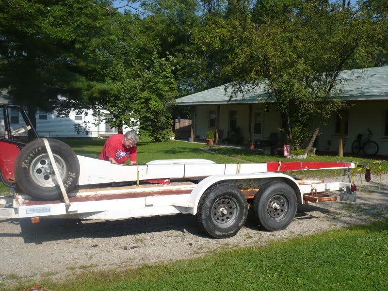

    Here's pix of that when it came out of my neighbor's back yard. Too Kool!!

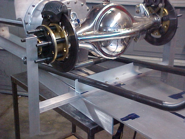

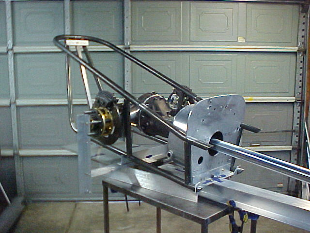

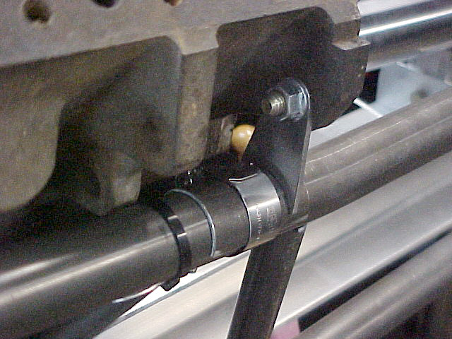

    Here are a few pictures while I was building my Woody ch***is. I had the whole ch***is ***embled on the jig with plastic zip ties and the it was tacked together. I hack sawed all the tubing and fish mouth all the tubing on a belt sander.
