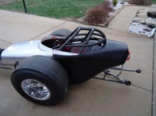

    Those are the M&H 16-12 tire on a 12" rim.

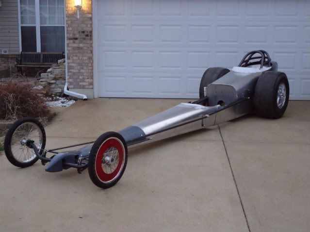

    King, Your builds with the laid back hoops look *****in. If you have to meet NHRA specs, you are doing it with the right look. Love it man. Some cool FED's there.

    Garsh dammit those wheels are sweet.:eek:......that low cage really makes the car. Great work KING.

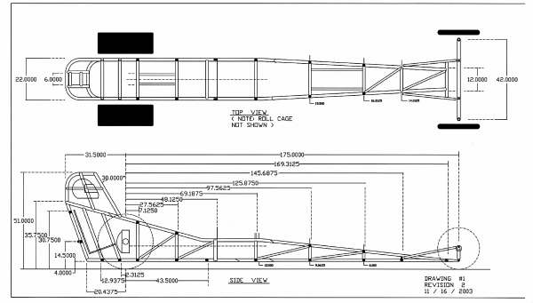

    does anyone have pictures of the ch***is from Dave tuttle (200inch)
    i like to see some pictures of it because i did buy a drawing (Dave tuttle)

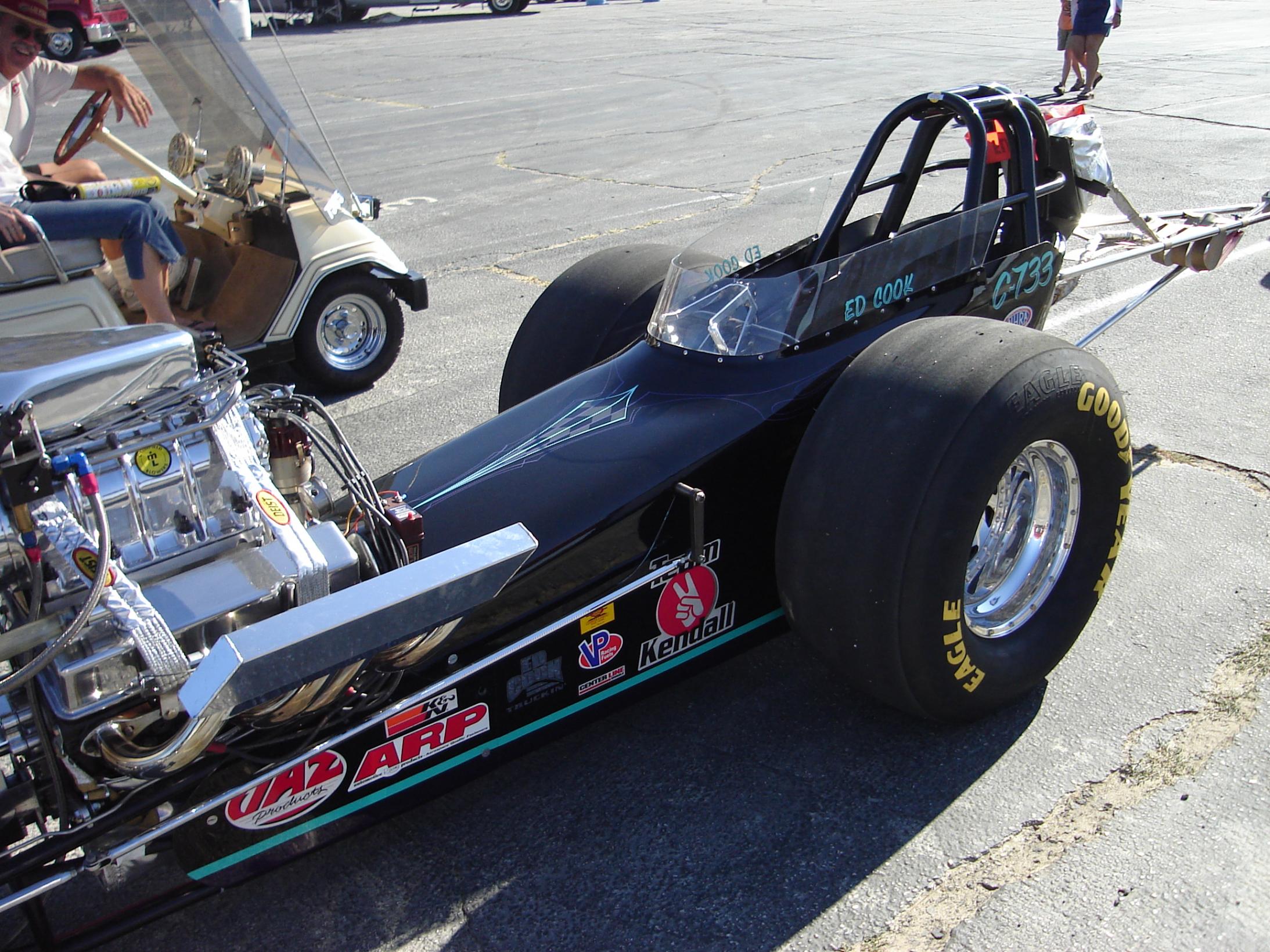

    I have been looking at FED ch***is for a long time with plans on building one in the near future. Personally the looks of a single hoop cage can't be beat. But as cars got faster and people started getting hurt because their head was not fully protected the double hoop was implemented. Now I think KING's laid back double is about as cool as a double can look and still meet Safety Requirements.
    Following are some of the FED pictures that I've collected, mainly to see how different builders set their cage hoops. My personal favorite for a new version is Thad's FED that was built by a shop in Louisianna.

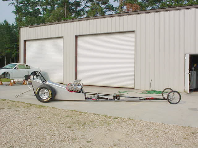

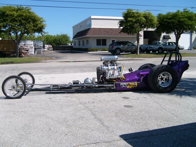

    A few different styles
  22. superchargedill
    Joined: Apr 5, 2010
    Posts: 226
    superchargedill
    Some guys like the more straight up hoops, and some like the squared off hoops. My favorites are low, round and laid back.

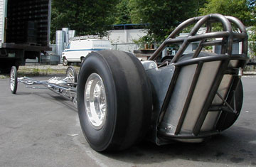

  25. superchargedill
    Joined: Apr 5, 2010
    Posts: 226
    superchargedill
    I believe the second picture is of the ch***is' that outfit on racing junk sells pretty cheap. I just don't care for the way they attach their front axle, but they do have a *****in fibergl*** chute pack body.

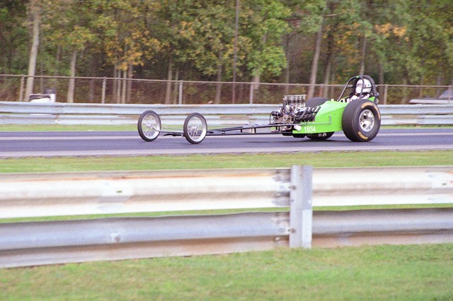

    Here's a couple of pictures of a car that runs a transmission. You can see where the engine is set much further forward eliminating the need to tilt the rear of the engine up to couple with the rear end.

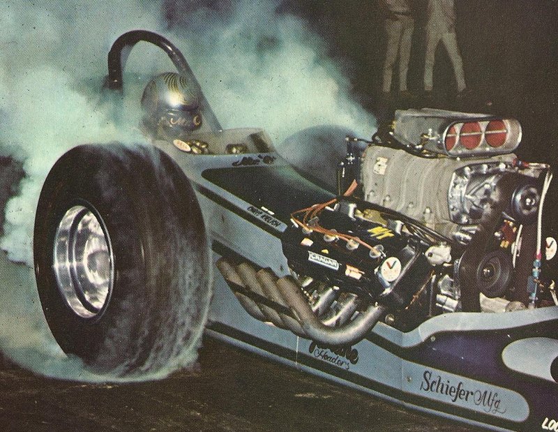

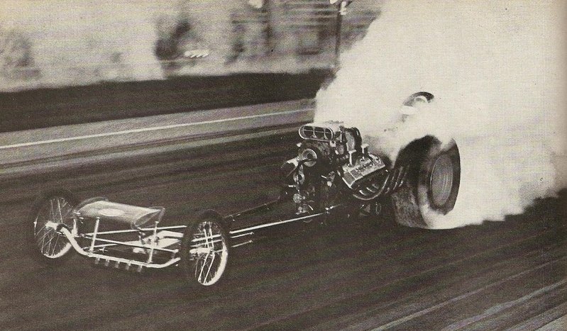

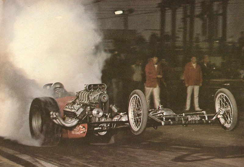

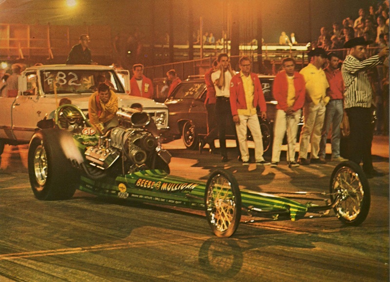

    superchargedill

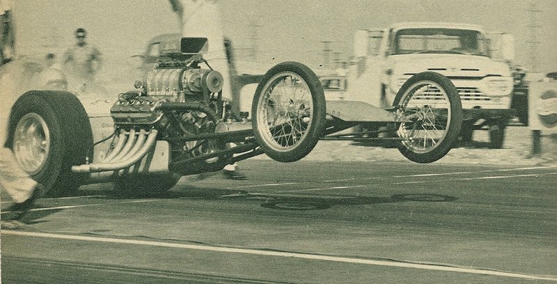

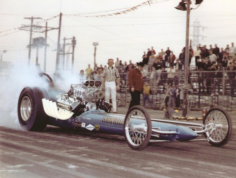

    These all more than likely just used a clutch with a direct coupler to the rear end. No driveshaft. Some of them set the engine so close to the rear end they had to shave the 2 rear exhaust tubes to clear the tires.
    Steve Barcak who runs the Apple Crate, Pontiac Heaven FED has a wealth of knowledge regarding old and new FED's and has taught me a lot on the subject.

  30. Tom S. in Tn.
    Joined: Jan 16, 2011
    Posts: 1,108
    Tom S. in Tn.
    Old dogs and new tricks I suppose.
    I ***ume these cars today are not clutch cars but rather use a converter. That could explain smaller tires perhaps.
    I never had a high gear car, ours used clutchflites. Our tires were 12 to 16" X 32 or 33" on 16" wheels. Our last car had gone to 15" Halibrands by 1975 though.
    I can not recall how far out the motors were, but we still maintained several degrees of rake in an effort to add load to the front end at speed, plane the car out, and gain stability in the lights.
    Even the rear motored car we had in later years maintained the same specs in the back half as the conventional cars did, including rake and etc. Just a car wider in front of the motor for the driver and nothing behind the rear axle like a **** pit. In fact, the first rear motor car I actually saw was an old conventional car that had been converted.
    Some of the beveled exhaust on #7 & 8 you see used to be done to clear away tire smoke. I often wonder if a lot of folk today don't realize the pics they see prior to the 70's where the car is smoked in is not a burnout, but rather the actual run.
