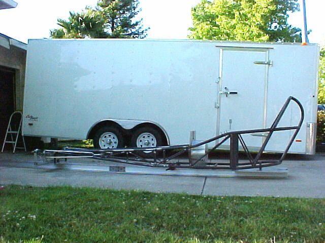

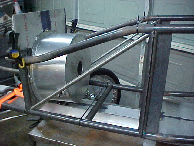

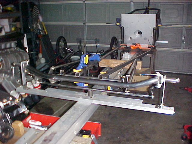

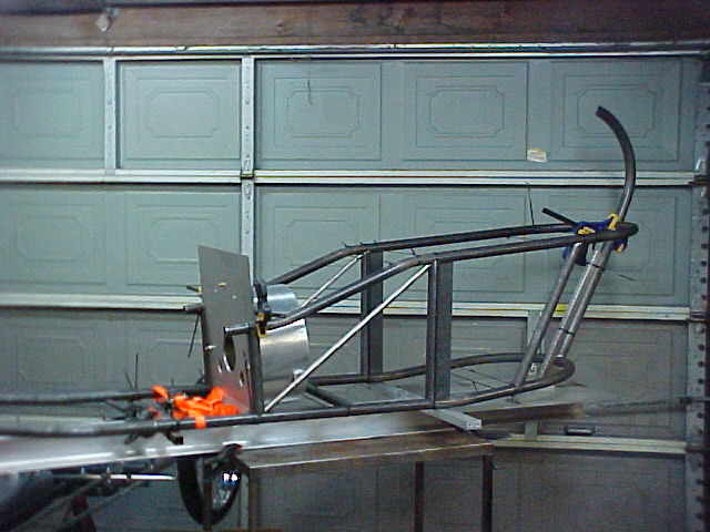

    Here are a few pictures of the 1962 Kent Fuller 112'' wheelbase ch***is for the Masters & Richter recreation. Kent provided front end parts from the original patterns he used back in 1962 and made the front axle.

    The motor angle is 5 degrees down and 24'' from the motorplate to the centerline of the rearaxle.
    The Fixture Jig is 2 pcs, 4'' I-beam with a 5/16 center web,2 pieces 8 ft long, 1 x 2'' x 48''(F) and 30''(R) long rect bar for axle locaters, 3/8 x 6 x 24''(F) and 3/8 x 24 x 30''(R) plates for front and rear ch***is support.
    You could clamp this altogther, but I bolted it altogther with 3/8-16 Nuts and Bolts. I made clamping plates to bolt together the two lengths of I-beam out of 1/4 plate, 5 bolts on each side and the full width of the center beam. The long edges of the clamping plates are radius to match the inside center beam to keep the 2 piece in alignment.
    The vertical axle locaters are made from 1/4 x 2.00 x 9.000 and 1/4 x 4 x 16 Rect Bar. 1/8 x 1 3/4 Steel Angle 2'' long are used to attach the vertical plates.
    All the materials are 6061-T6 Aluminum except as noted, The 4'' I-beam bottom is ground level starting point. With the ch***is supporting all the added weight you will be surprised what you end up with. My Woody Fueler has 2 3/4'' ground clearence at 1200 pounds.

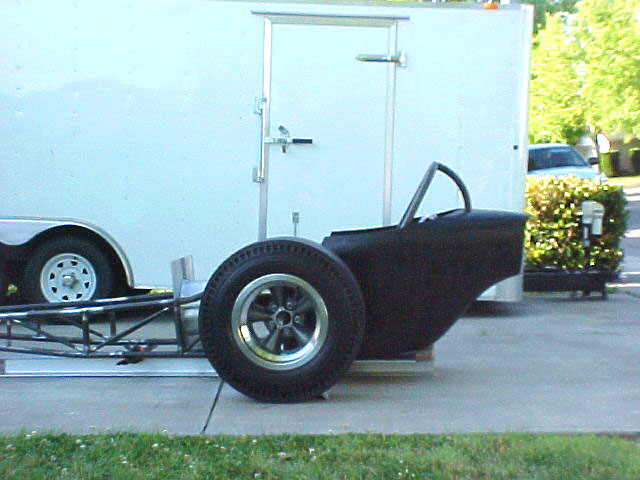

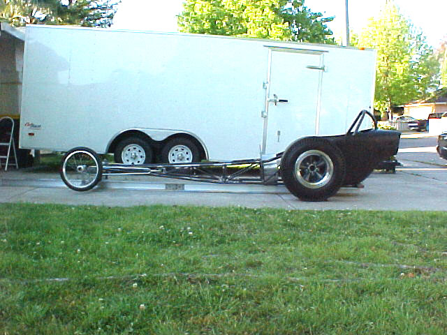

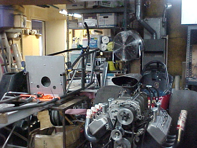

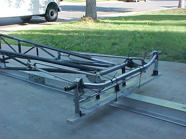

    Here is the latest one off my jig. 225" wheelbase for a late hemi NT/F with as much of an original look as I can do and have it comply with the rules. Took these pix yesterday to send to the owner. The front wheels are borrowed from my Don Long resto project which is actually sitting on the jig at the moment.

    Very nice, I was wondering if the ch***is in the jig was for the funny car you aquired. Your making fantastic progress on this car. Scott has been sending me your updates.
    You should start a threat on each of the builds so we can follow along. The Don Long ch***is that Roo Man has on the jig has some history to it.
    It is the 1970 Soapy Sales fueler that Steve Carbone drove in Australia. That car was originally the Mr. Lucky that was pictured on the cover of the January 1970 issue of Hot Rod with a 426 Pink Elephant and Kelly Brown's name on the cowl. It never ran in that form and actually made its first run in Australia with one of Huff's 392 bullets in the frame. He acquired the car from the Dustman brothers from northern Ohio and has slowly been collecting parts to restore it. On his dragster wish list are a Powers & Reilly reverser and a M/T mag third member for an 8 3/4 Chrysler rear.

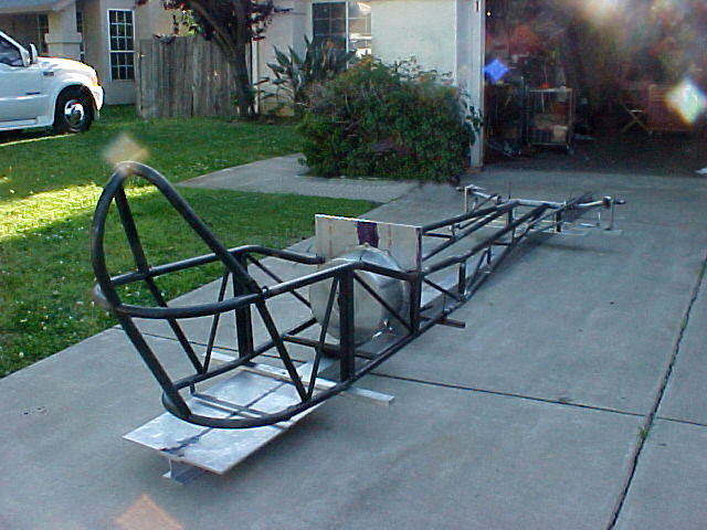

    Hi Roo:
    Excellent work as always.
    Say 2 questions if you don't mind.
    One is where do you get the CF **** Bucket from?? How much?

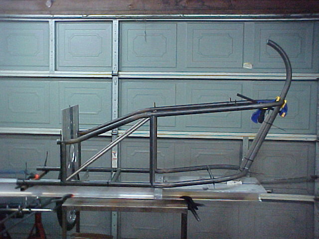

    Secondly is the joints you have in front of the MP. You have the upright teed into a doubler. Is this floating on the Jig till you Rosebud the doubler into the main rail?? As in you fixture them all in place then weld it up.
    I was admiring your work on Glenns car. Stared at this for a second thinking how you did this. Its an excellent idea . I have helped on my friends (Matt) dragsters and seen some other cars were the joint is just welded to the single tube.
    Always and I mean always have seen the car break in this area at some point in time or place.

    My buddy Craig Striegle (Carbon Guy here on the HAMB) makes the seat base for me and I am not sure exactly how much they cost as we trade out with me making molds for him (along with the occasional part for his 27 T coupe). It is designed for 18" centerline spacing on the lower rails and is flexible to suit just about any upper rail width. If you want one I will get a price for you. I actually need to do that soon anyway as it will be part of the components list for my new Vintage Racing Supply business when it gets up and running later this year.
    I started doing the sleeve deal for the very reason that you cite. When I lay out the front half of the car I space the sleeves to suit the upright placement and tack them at the rosette location. Once the uprights are tacked in place I then weld everything up, doing a little at each junction and moving around to avoid having the frame pull.

    Here are some progress pictures of the 1961 Kent Fuller ch***is tacked together and doing some fitting..what FUN ! The tail section is from Brian Fox, Ch***is King, thanks.
