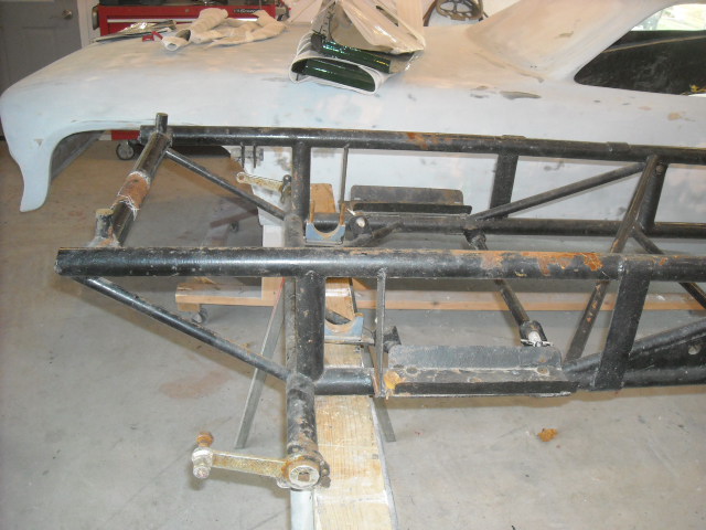

    I know this isn't a dragster ch***is but you guys always amaze me on what you know, this is a ch***is i got with a funny car I'm restoreing ,i have to update it and at the same time try to make it look close to the orignal ,but I also don't want to butcher up a piece of history,i can always get another ch***is, ,a buddy of mine thought it might be a Palamides ch***is by the axle out in front of the main frame work ,it's 118 inch wheelbase any thoughts/ Tim Jones

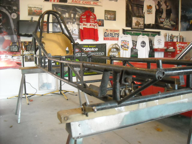

    Can anyone help us identify this FED frame?
    As you might see, the rear axel housing is what hold the frame together.
    There are some of the same solutions as the Dragmaster frames?
    Upper tube has the same size from back all the way to the front end torsion tube:confused:!
    We would be glad to know approx this was build, and by who?
    We like to know tis before making the ch***is mods.

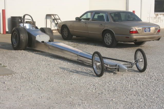

    Sorry that you can't see much of the ch***is now but here is Ernie Broughton's Commanche re-pop just before I put it in the trailer to deliver it. Look for it in paint at the NHRR at Bowling Green in a couple of weeks.
    Roo

    roseville carl
    Damn Roo that is absolutly beautiful!!!!!!!

    Just yesterday, Ross Blasingame and I were talking about the Freedom Machine car. Then Ross started telling me all about the car that Rooman did the body on posted above. That body looks beautiful. Nice job.

    Outstanding job Rooman:)
    Are those rear tires new?

    Great work Rooman , if you put these cars side by side it would be tough to tell what one was built in the 60's, Tim Jones

    They are so old that if Ernie does a burnout with them there most likely will be more sparks than smoke (G)
