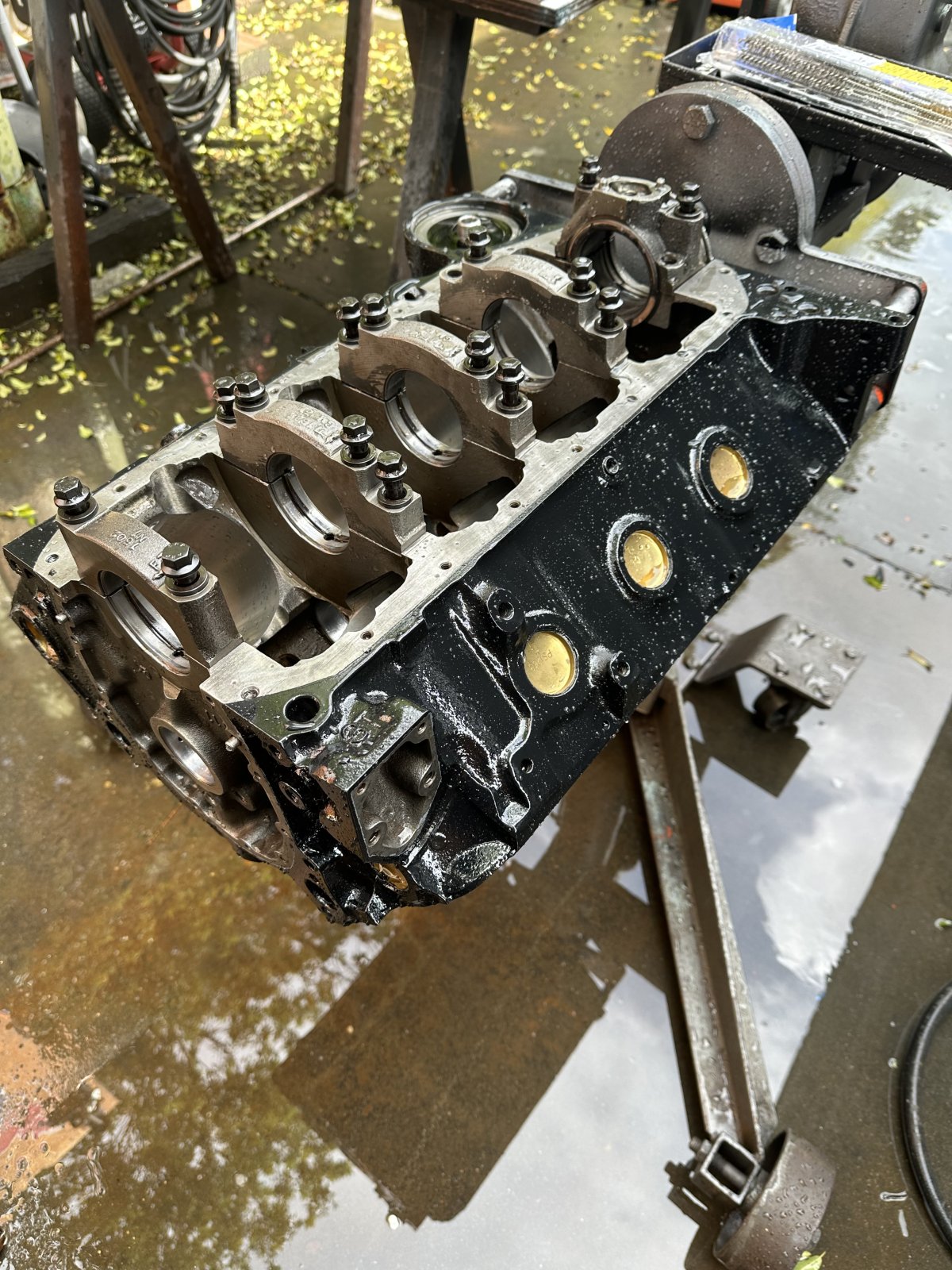

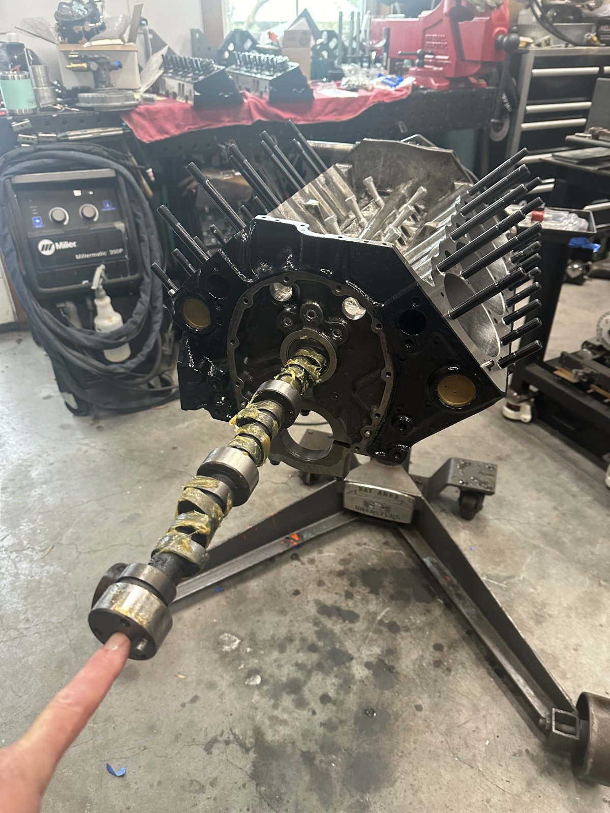

    I haven't scrolled through the threads, but I think I mentioned that when we pulled the 327 I had intended to use apart it was worn beyond belief. That is came out of a running bomber stock surprised the heck out of me.
    A good pal who raced nostalgia Jr. Fuel back in the early 90s and was helping me with the 327 called in some favors with his ex -racer friends and asked them to scour their shelves for parts to give me the good guy deal on stuff.
    So the engine that is coming together is WAY zootier than my original intentions for the car. It's now a 400 block with 4-bolt mains and .030 overbore for the ubiquitous 406 cu in combo.
    I will still have the small Schneider cam and the TrickFlow camel hump street rod heads, but now it has Howard's aluminum rods and higher compression Venolia pistons. With the TrickFlow heads, we're figuring about 12.6:1 compression. This has a forged crank like the 327, but the one in the small journal 327 was a stock GM deal. The rotating ***embly is being balanced right now but hopefully it will get screwed together this weekend. I know it is more engine that I had planned on, and I'm sure we'll be up on HP than I would have made with the little engine - so I'm guessing it will no longer be the upper mid-9 second ET car I was planning on. A bit more of a steeper learning curve on the driving end, but good problems to have I suppose. Should still be pretty reliable since we're not really leaning on the engine all that much. Offhand I'd guess we'll be sniffing low 9's/high 8's.
    Here are some random photos from the engine stuff the last couple months. The aluminum rods, are cool, but a TON of work with machining for side clearance and working on the block to add clearance and such. 362965714_10230361075075920_8714103626194732657_n.jpg 363954477_1358691891660841_7129264003487627090_n.jpg 423944072_355731017289178_7804765897085886987_n.jpg 423944072_770299747874038_4550600828866199276_n.jpg 428336257_2835977649890270_1213115393597941167_n.jpg 428413354_1178331866488621_3455433971661082484_n.jpg

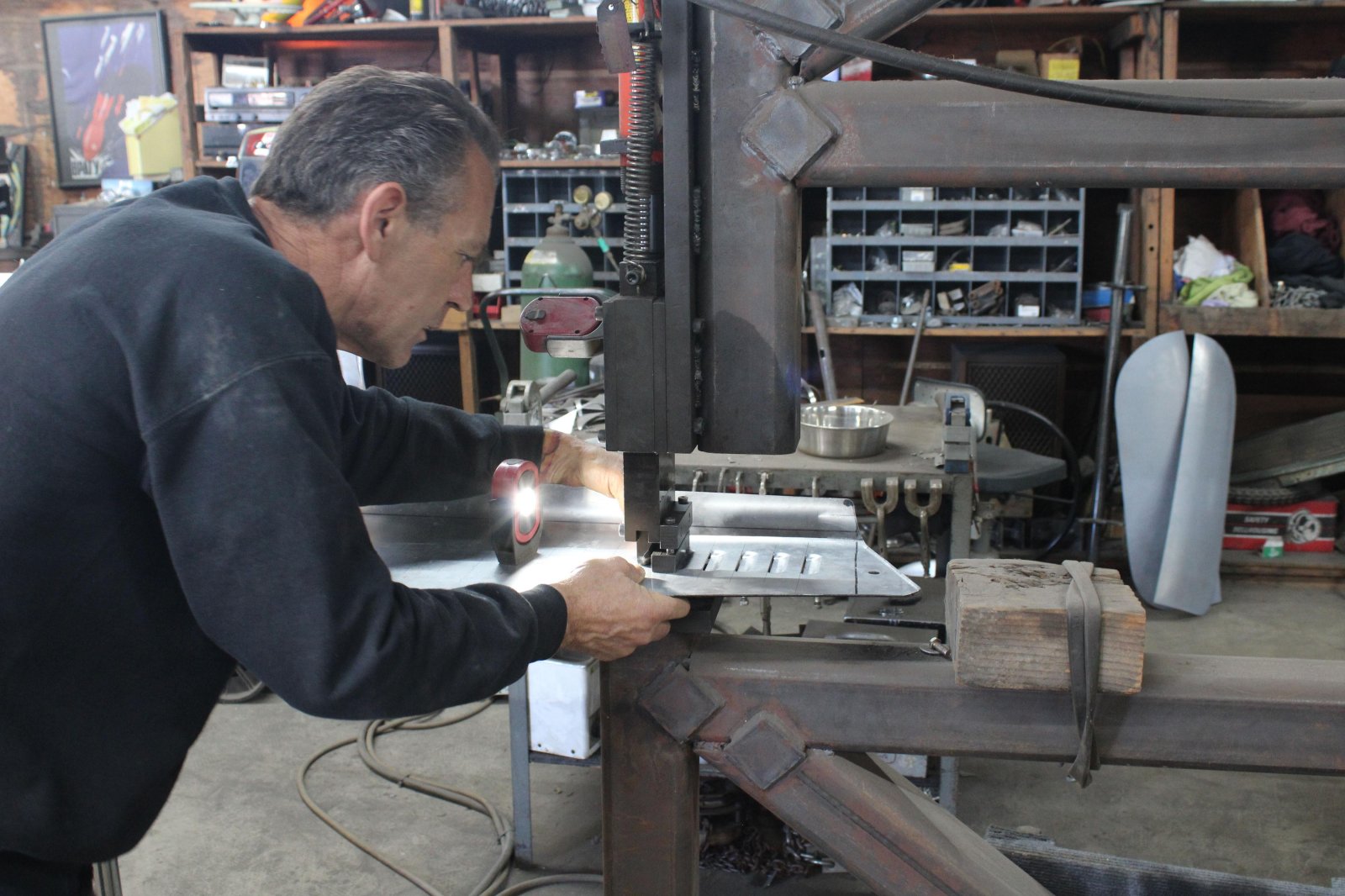

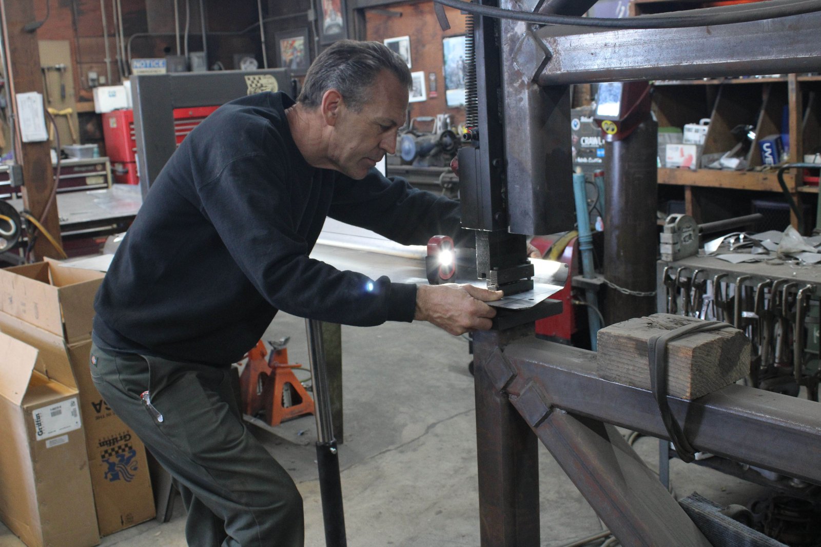

    Also with the dragster being named "Rocinante" ( the name of Don Quixote's horse) in honor of master dragster body builder Tom Hanna, I designed and created an emblem that is a nod to his old logo. This will go on the cowl of the car so from 5 feet it looks like a Hanna emblem, but when you get up close you can see the difference. 411160948_10227938189974082_3669650507555917888_n.jpg

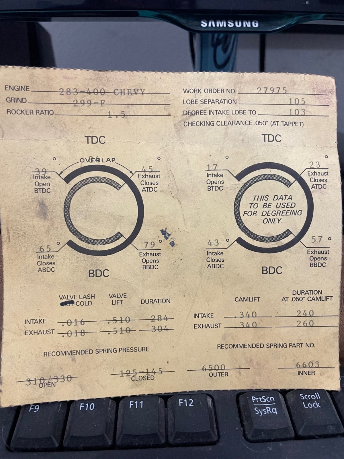

  10. That cam appears to be a hydraulic flat tappet cam - am I correct? You could probably use a lot more cam, but getting the car going down the track and having some "seat time" will be most important. You can always "go bigger" later on! I'd love to see you with a mechanical roller - with a lot more lift and a bit more duration. LOL

  11. Marty Strode
    Joined: Apr 28, 2011
    Posts: 9,850
    Marty Strode
    I wouldn't have looked the card over close enough to see it's hydraulic, good catch. Mine is a 299 F, for flat tappet.

  12. voxnut
    Joined: Oct 30, 2008
    Posts: 304
    voxnut
    from sacramento
    That is correct! Again, I followed what my buddy Gene was doing. He laughed about running a hydraulic cam in it, but he went as fast and quick as he wanted to and didn't have to run the valves every few runs.
    If I were racing seriously, I'd totally go all zooty with the cam, but the deal with this is to look 1960s, have a blast running it for fun and not breaking any parts. It's a hot rod more than a race car. If I lose more brains than I already have, I know I can put a new cam in it and lean on the combo more. I have Crower roller rockers and girdle uptop on the heads, so it will take it. Then again, if I lose more brains, I'll probably swap out the stack injectors for a 6-71 and 4 hole Hilborn... :)

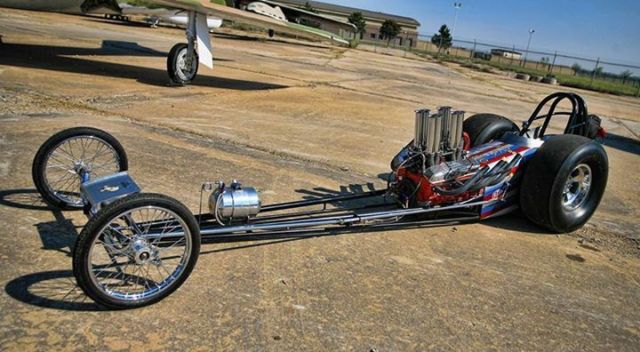

    IMG_4137.png Well I for one have been following along and if you were looking into the hamb drags you would definitely be interested in the drag race I help put on its called the midway drags at mid America dragway in ark city Kansas june 7-8 2024 if you look it up on the Ol interweb you will find all kinds of info you are definitely invited to come and race your car I am planning on goin to rhe estranged car club drag race in toutle Washington in August I would love to make it back for eagle field but not sure I can make that happen this year your car will be way faster than mine but I promise the blown Flatcad in my car will definitely surprise you I dig your car and hope to see you at the track here is a pic of mine from last year

    Our event is not about how fast you can go though we like that too but the long Smokey burnouts wheelstands and dry hops are what the crowd loves and that my friend is what it’s about for us we put a show and that’s how we do it the meltdown drags and for that matter the hamb drags didn’t get to be a huge success by having the fastest cars in the world it was a show and they successfully made that happen we only hope to get to that point

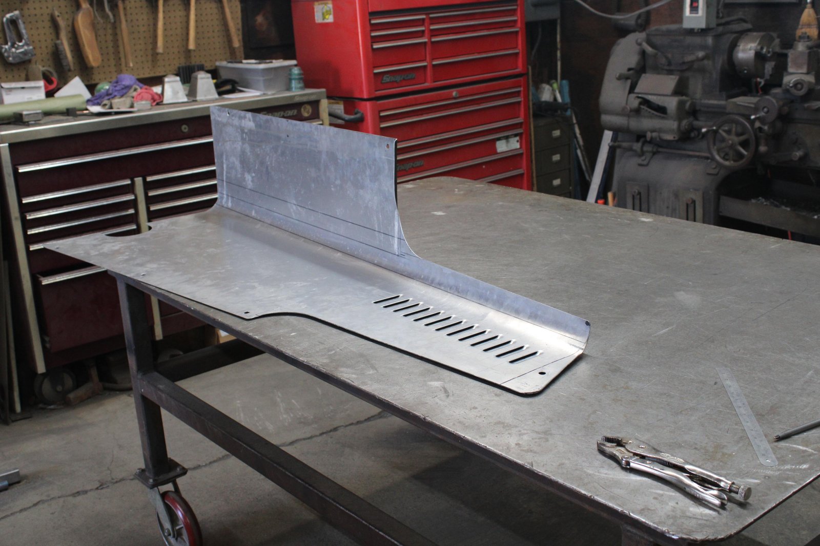

    The latest status - just had louvers punched by Matt Seret yesterday so the body is officially done. I'm down to those seemingly endless half-hour jobs. I'll scuff and put another coat of black sealer on the body this weekend and then it will stay in that state until the mechanical stuff is all done.
    The latest puzzle to solve is figuring out cooler lines on the trans with the NHRA required, SFI stickered trans shield in place. You'd think they'd design them to keep the cooler outlets uncovered, but no. The best answer would be something like a Deadenbear case, but if could afford that, I'd rather spend the money on a clutch setup and run the car the way god intended.
    After that, it is wiring the mag switch and the starter circuit, bleeding the brakes, fluid in the trans, oil in the rear, checking the Hilborn setup with centering the ****erflies and making sure they all close the same, then doing leakdown. T******* the ignition wires to the correct length and checking the timing. I also need to figure out the best place to hide a 5lb fire bottle - in the tail or under the cowl. I'm going to hold off on buying new belts until just before we start running the car, hopefully doing shakedown runs in the spring.
    But the hope is to fire it up for the first time sometime next month to break the cam in.
