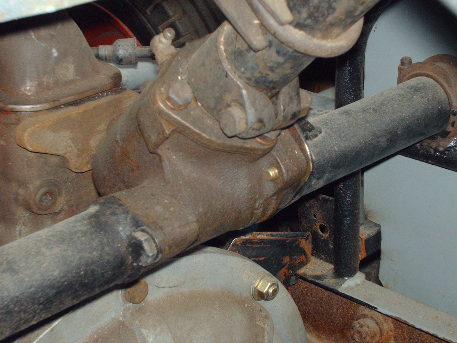

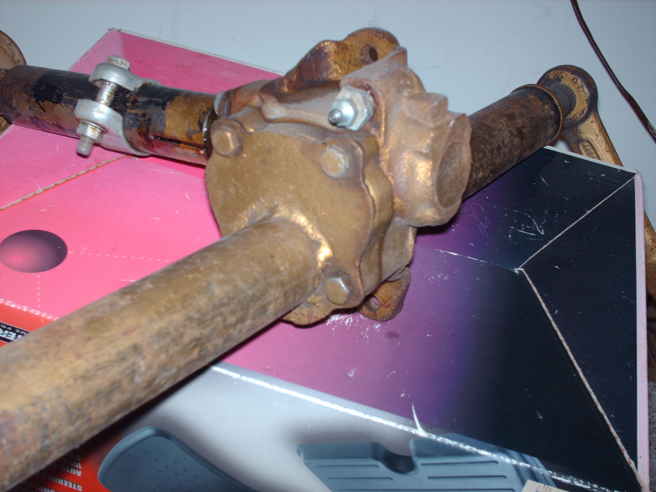

    Hello , Looks like an early single pin Ross to me . Ross built steering gears for everything from lawn mowers to Semi trucks . Here is a pic of the Ross in my pre war midget .

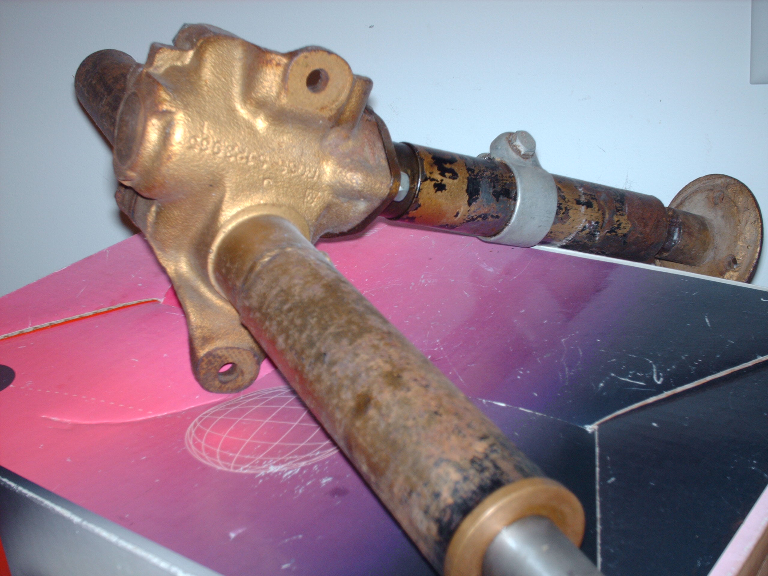

    Looked at your picture again . Not a very good picture , but I think I figured it out . Still think it is a Ross and probably a single pin style . Here is a pic of another Ross , that I think might be what your looking for . Ross # S122985 .
