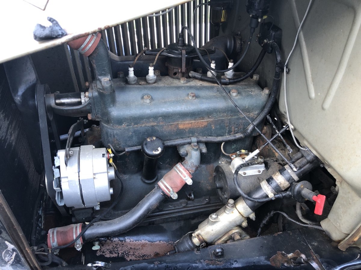

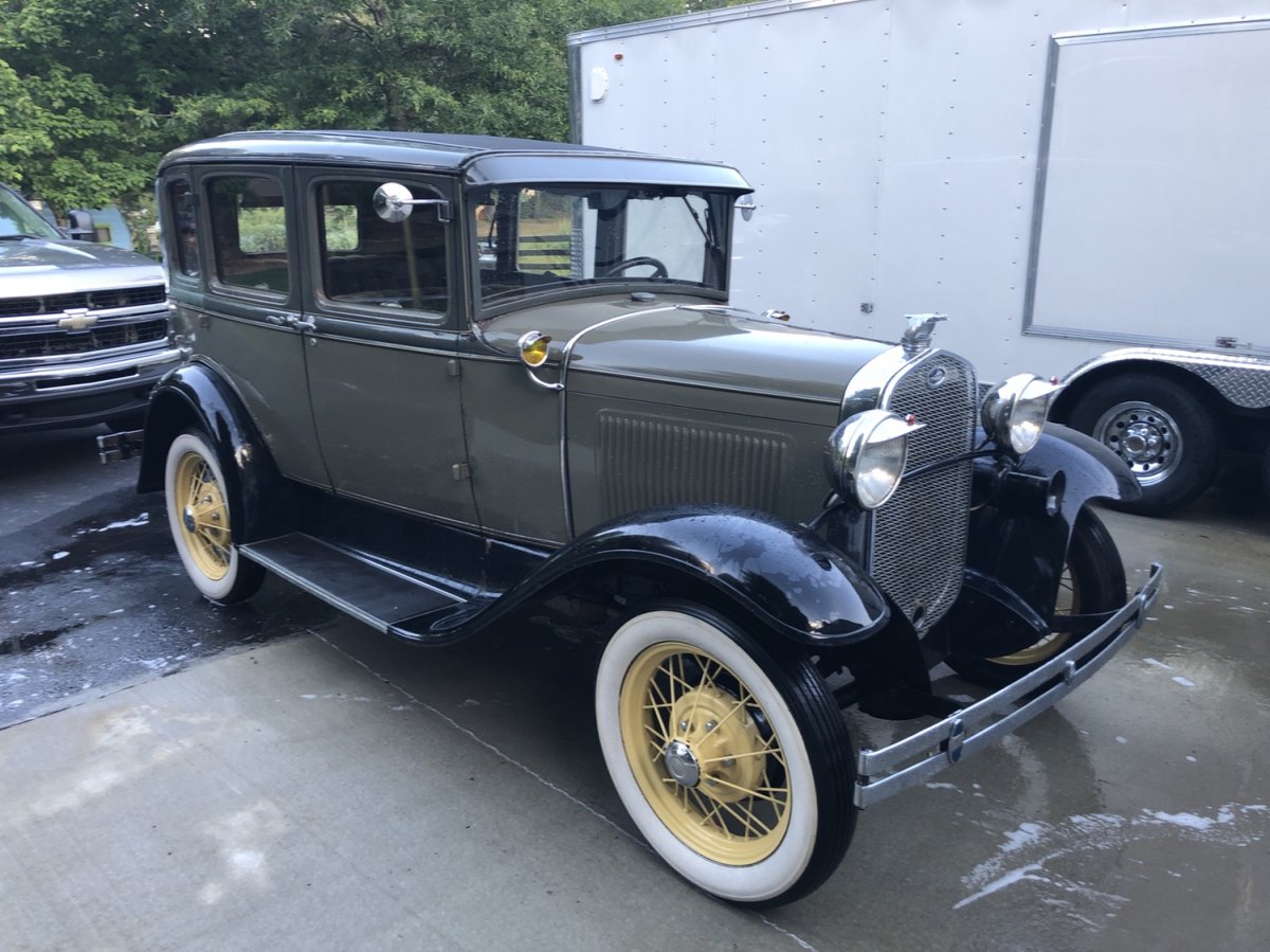

    It was bound to happen, even a custom guy is gonna end up with an earlier car eventually. I was at this auction, see, and there was this really solid ‘30 A Town Sedan. I didn’t give it much thought really, other than, “hey, that’s a cute dune buggy.” The auction was an airplane guy’s place and I actually went for equipment and maybe some airplane junk (none of which I ended up with). A friend of mine ended up winning an old Pietenpol barnstormer with a hopped up Model B motor in it (which plays into this tale in a bit). He got it super reasonable and as the lots went by, stuff was going pretty cheap. Up comes the Model A. I keep my hands to myself expecting to go beyond what I’d pay so no sense getting involved. As quick as it started, bidding stalls at what I considered a good deal. I couldn’t help myself....I just couldn’t let it go for that, so going once, going twice, new bidder in the back. No one counters me and the next thing you know I own an A model.

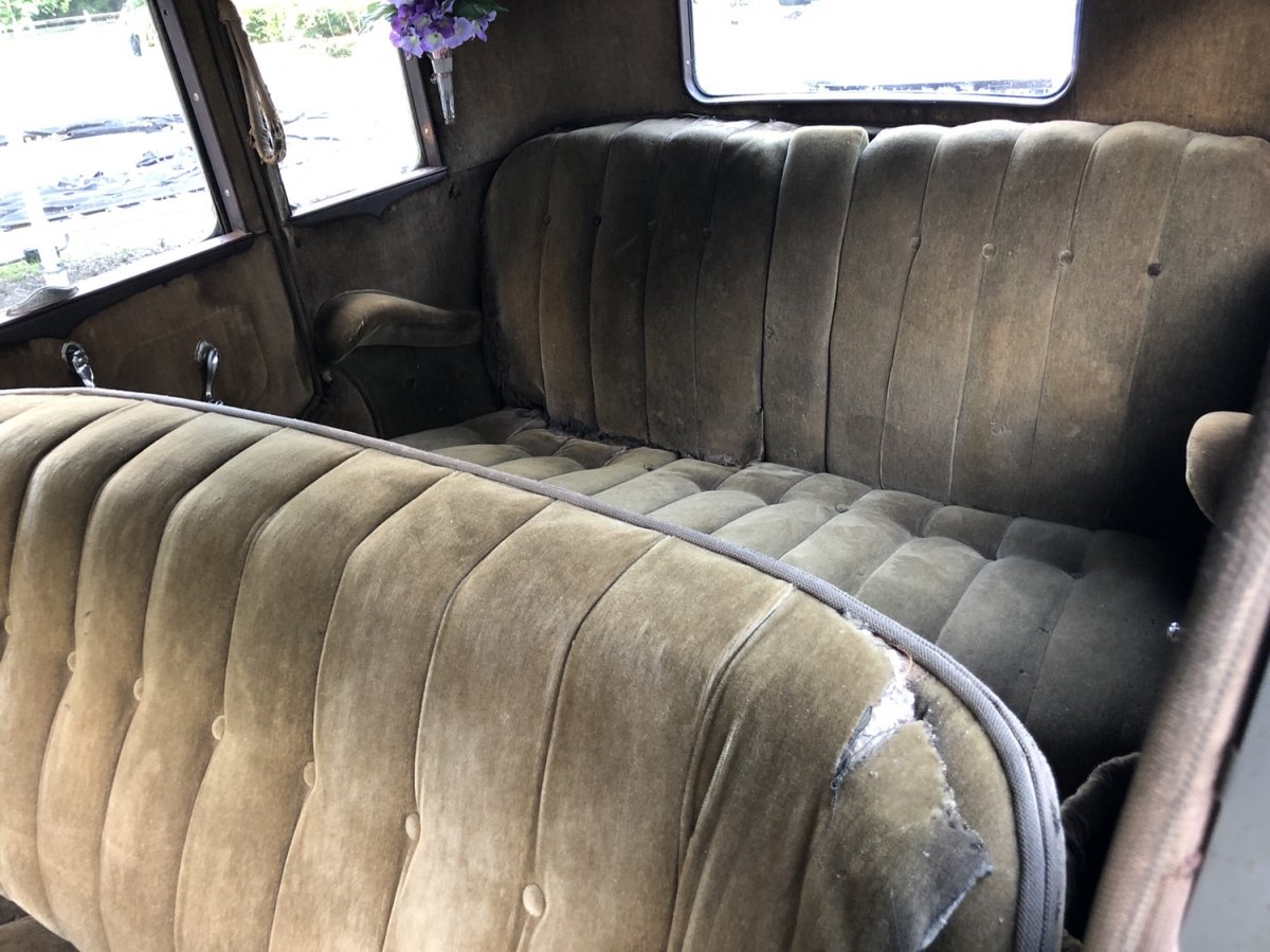

    Good looking car really. Running, driving and all in working order. No doubt and older restoration. Paint is cracked and peeling, top leaked a bit, but I think I have that fixed. The interior looks to be the original, but is sagging a good bit, splitting at a few seams and has a bad spot in the corner of the rear seat. Floors, fenders, doors all solid. Only rust I’ve found is a spot at the bottom of the body in the p***enger wheel well.
    My first thought was flip it, but I had fun putting around town in @FLAT-TOP BOB’s T roadster when we were in Wellington last fall and I’ve thought it would be fun to have a little putter car like that. A closed sedan makes it even a bit more attractive. I could leave it as is and do just that, but hey, you know guys like us just can’t leave well enough alone. Just seeing the article in TRJ on Vern Tardel’s new book on making a quick hot rod out of an older restoration is suuuuper tempting. Dropped and raked, a bit more horsepower, juice brakes, new interior kit, done. I think that’s where I might be headed. Nothin' crazy, largely bolt in, and have a cute little rod.
    I picked up some ‘35 wires and a T spring at the swap meet this weekend. The guy that bought the barnstormer is going to take the hopped up B motor out to replace it with an air cooled motor, so I might have a crack at that. Quick research leads me to think that might not be exactly bolt in and be a bit of a snag on working out a synchronized trans, and for the effort and money I might be better off stepping up to a flat head. I do have a good running 302 coming out of my dad’s ‘69 Mustang I’m redoing, but me thinks that’s further down the road than I want to go. 40-48 juice brakes maybe, but I haven’t looked into that a whole lot yet other to realize maybe self energizing F1 brakes would be just a bit better way to go. Dropped axle I ***ume and perhaps an F1 steering box? These are all things I dunno yet. @1stGrumpy sent me a bunch of links to threads he’s found helpful on his build which is much along the same lines I think I’d like to go. Search function and a few Model A books and here we go.....I don’t have a problem, I can quit any time. LOL
