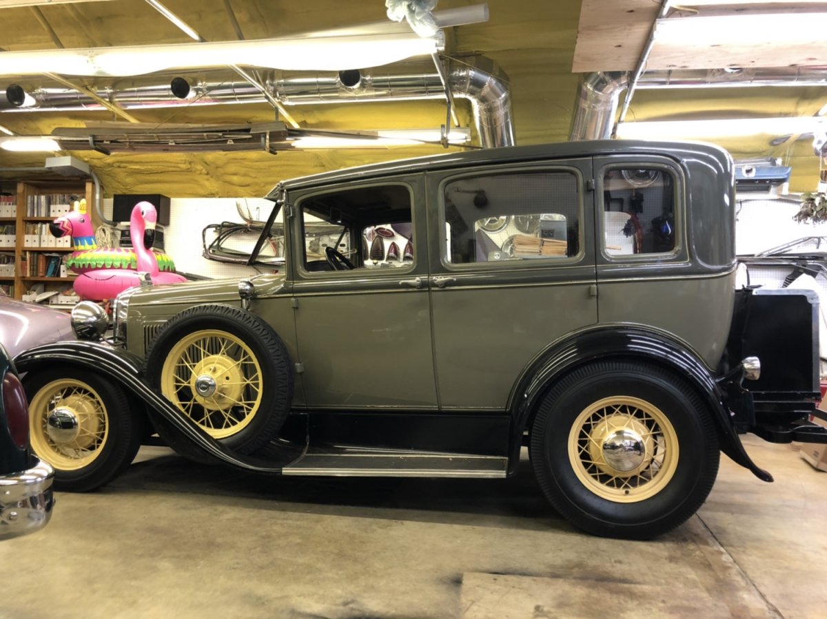

  20. drdave
    Joined: Jan 3, 2006
    Posts: 5,228
    drdave
    Here ya go @Fiftee3....
    I doubt it looks like much change....by the tape I’m up 3/4 of an inch. Lotta work for 3/4. Haha. Oh well.
    Bob, actually, the chalk mark from the first time I did it was still there, but this time I didn’t feel a “clunk” when I was certain the bolt head hit in the hole like I did last time. I figured better safe than sorry and went ahead and drilled the hole so I could know for sure.
    Just finished putting it all back together and getting it on the ground. One of the shock links fell off while I was waggling mess around, so since I had the links from the front that I had already cleaned, painted and rebuilt but didn’t use when I swapped to the shorty dog bone links, I went ahead and changed out both rear ones.
    Next up, back on the road for some miles. Now that the interior kit is here, maybe in the not too distant future I’ll get a chance to redo the seats. I’m going to hold off doing the rest of the interior though until I have time to pull the car apart and paint it. Cuz, you know, you can’t put the side panels on until you put the headliner in, which is best done when the top insert is off, which I could stand to do anyhow since it leaks. ...and if I’m taking the top insert off, I may as well fix the peeling paint around it. I hate to put the door panels on without rebuilding the glass runs since the door panels are nailed on. Well, gosh...as long as the glass is all out, it’s a shame not to fix the peeling paint around them....and if I’m going to be painting the top and around the windows, there’s realllllly not thaaaaat much left of the body to paint, so.....
    ....I don’t have a problem, I can quit any time.... lol

    from KCMO
    I’m surprised that you got that much lift from one more leaf! Car looks great though
    loudbang and drdave like this.
  23. drdave
    Joined: Jan 3, 2006
    Posts: 5,228
    drdave
    Thanks Tim. I was kinda hoping for 1-1.5 inches, but it is what it is. Funny, the passenger side is right where I’d like it, but the drivers side is a little lower. Guess something, somewhere is aged/settled/flattened so that the sides aren’t even. Or, maybe they were never even when they were new. Dunno. Lol
    Bob, Bob, Bob....creeping perfection sickness? Me? Nah, you got me mixed up with some other guy. I prefer to think of it as project efficiency...”as long as I’m there, I may as well...” haha!!
