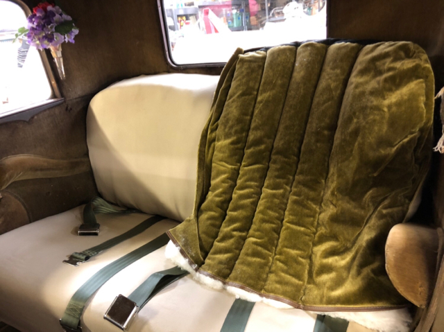

    Dave, I ordered it from Mac’s....Cartouche I think they call their line? I went with what they call the authentic interior. I’m really pleased with how it looks. Here’s a few pics...it’s more olive than the pics show, but it really highlights how shabby the original interior is. @Cliff Ramsdell was asking me to report back when I got the interior how I liked it as well...so far so good Cliff! [emoji16]

    wow - big difference in the colors. But I can see it working with black or tan. Were the other stock interior colors?

    The color of the new parts shows how the original has faded over the last 90 years.
    The pockets and nice and tight as opposed to the original ones.

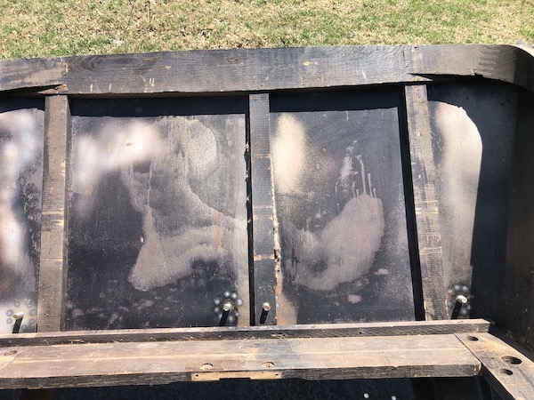

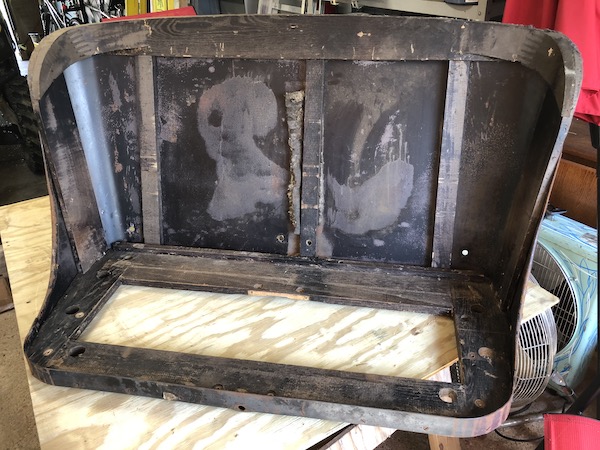

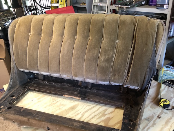

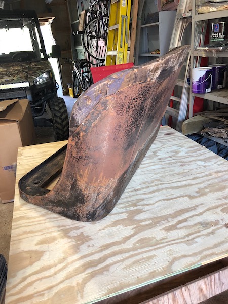

    Well, with all the time off work, in between other projects I've been working on redoing the seats. Of course, started by taking lots of pics and measurements as stuff comes apart, but the Mac's instructions are real good and everything fits just fantastic.

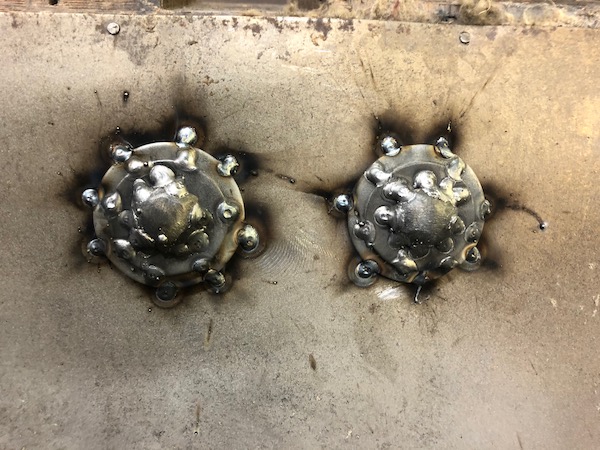

    I'm super pleased with how good condition all the springs and frames have been overall. I have had to weld just a couple broken spots on some spring frames, but no broken springs at all. Most everything is still in original paint in good condition. A little rust on parts of the back seat where the top has leaked in the past and the seats retained water. Nothing a little wire wheel and a fresh splash of black paint couldn't handle.
    Front seat is typical of the interior as a whole....mostly intact and serviceable, but pretty shabby. The bottom cushion just lifts off the frame, but the back cushion is attached and the cover nailed to the outer frame, top and bottom.

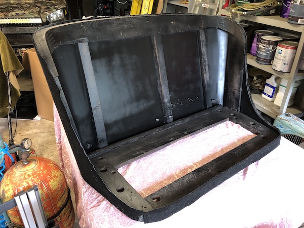

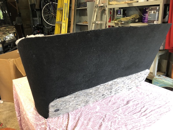

    Minimal surface rust below it all and the wood is still in great shape. I sandblasted the metal and repainted it all (all the seat tracks and hardware got blasted and repainted, too). You can maybe see the holes in the bottom of the back I drilled to mount the seat belts. When I put them in last year, I just drilled through the carpet cover and put the bolts over the top since there was no easy way to get the carpet loose and hide the bolts underneath. While I had it apart, I rounded off the heads of the bolts and welded the washers and bolts to the seat back. They will now be covered in padding and the upholstered cover and I only have to tighten the nuts without a wrench on both sides.
    All cleaned up and the pad on.... I have jute on the bottom to help smooth out the bolt heads and also fill out the carpet insert. The rest of the outside is covered with thin trunk liner. There was a thin layer of jute padding on it, but I couldn't find it that thin, so the upholstery supply had this and I think it will work great (I don't have the seat frame cover on yet, LOL).

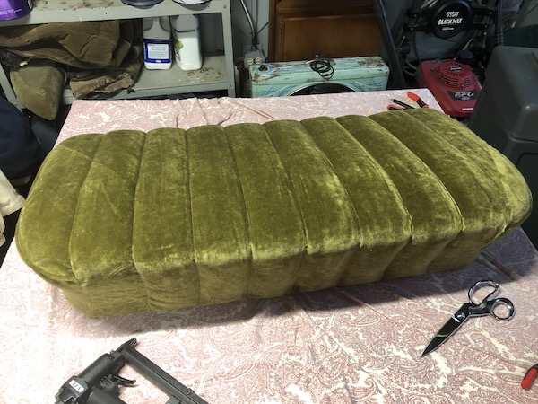

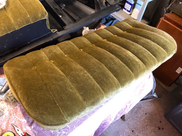

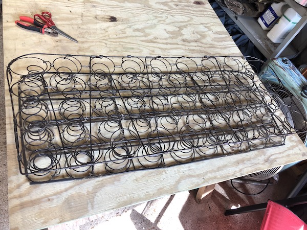

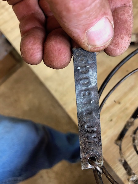

    Moving on to some actual upholstery...I do have the bottom cushion done. The springs like I said are in super shape....they all even still have these tags on them. Dunno what the codes are, interior trim color and standard or deluxe I presume.
    The covers from Macs could not have fit better. They provide a layer of jute that goes down on the springs, then a layer of cotton padding then the cover with cotton filled pleats. Very nice and I couldn't be happier with the quality, fit and looks. I think I will hit them with a steamer and a brush when I get all finished to even out the nap from being rolled and folded in the box. Amazing the difference in the look with the ****ons in....I wouldn't have expected the big change. Definitely worth the extra $36.50 for the deluxe interior in 1930. LOL Pardon the difference in color tint in the pics....there's big window right where I'm working that gets afternoon sun. haha Now to just keep plugging along with the rest. :D

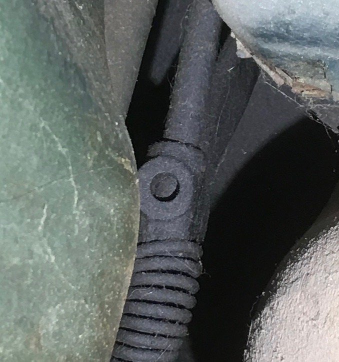

  22. Good to hear from you, I like your car and always enjoy what you are doing. There is one thing in the accelerator linkage that is frequently overlooked. Where the accelerator shaft p***es behind the engine the shaft is supported on two towers. At the top of the tower there is an opening that was intended for an occasional drop of engine oil.

    Thanks for the tip on the accelerator linkage Charlie! I've caught myself dropping some lubrication around it, but likely i've missed the spot it's actually supposed to go into. Probably has its fair share of gummage gathered in there as well, so cleaning that up and lubing properly will no doubt make a big difference.
