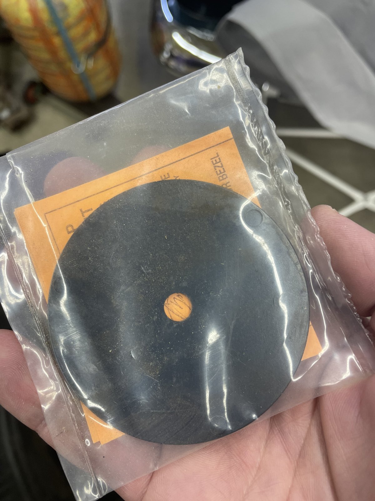

    Well golly, that's the cap I have. I'll have to go look in the box, maybe I already have the plate. I haven't looked at it in a while, so it could very well be there. Thanks!

    Well look what I found on the shelf tonight…
    Lol. Guess I’m set after all. :)

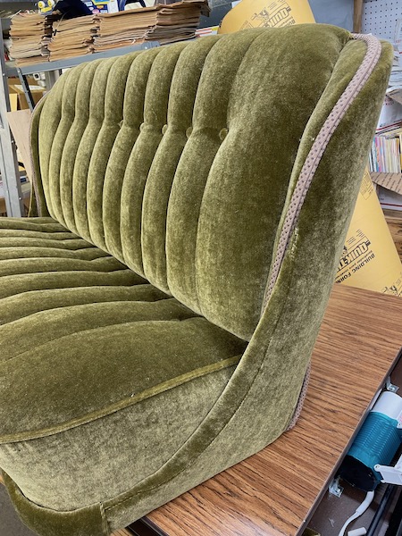

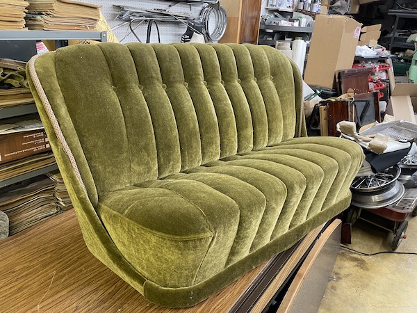

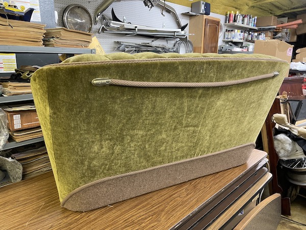

    Well, almost two years to the day I pulled the seats out, I finally finished the front seat the other night.
    I'm 95% happy with it, so I'll call that a win. The side seams on the frame cover are supposed to come around to the front of the frame and they came up short just a bit on both sides, but I was able to stretch it around enough to get it to fold over and reach the tack rail on the inside. Looks fine, but could have looked better. No matter where on the frame I put the cover (higher or lower, etc) It just would not line up. I stretched and stretched (on advice from my upholster aunt, I tried misting with water and warming with steam) but that's as close as I could get. Good enough for who it's for. LOL
    Also, the upper outside corners on the top cushion (the "ears" still sticking up in my previous pics from Jan) were quite the booger to get to lay down right. I would have liked them to curve in at the very top a bit more to follow the curve of the outside bolster attached to the frame, they have no wrinkles and the way the edge of the cover was cut and finished off on the corner I just couldn't make it go where I wanted it to without a fold on top and that wasn't going to work for me.
    In the end, I'm happy and should serve for another 90 years. A lot of life went though the originals as you can tell by the fade.

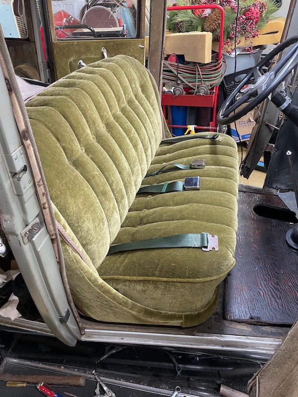

    Well, guess what? Just over 2 years after it was removed, the front seat has made it back in the car. It took some figurin' but I figured out how the seat track went back together and the order in which to put it and the seat back in. The sliders, brackets and adjuster screw all kinda weaves through each other and you can't just plop it in...so far as I have been able to figure out. I did end up struggling with the last two bolts on the back of the seat to the sliders that in the final*****ysis I should have done first. Oh well, live and learn. @Tim told me last night (after I got it all done) that when he has an order of bolts he needs to remember for****embly, he stamps the holes with the order the bolts go back in. Neat trick I wish I had known when I took it apart (but, it was all frozen up when I got it out, so it came out all wonky anyhow I guess), but I'll be stamping numbers on seat frame at the mounting holes so I don't forget for next time.
    It's unreal to me that is 92 year old factory paint on that floor pan and that it is in such amazing shape. The seat track I cleaned up, repainted, and regreased of course.
    And there she is, all back in place. Whew! Now if I didn't have the radiator all out and the 12 volt conversion finished, I'd be ready for a drive. LOL
    And for anyone who would care, here's the seat belts mounted behind the bottom cushion to the seat carriage/frame. Technically, the bottom of the back seat cushion cover was/is supposed to be attached to that wood rail you see standing up just below the seat belts. I hog ringed the cover to the back of the spring instead so I didn't have to run the seat belts through the cover. As a quick reminder, since I showed it 2 years ago, the bolts are carriage bolts and washers welded to the back of the seat frame and are covered by the seat frame cover. Here's the back of the seat frame again before the padding and cover...

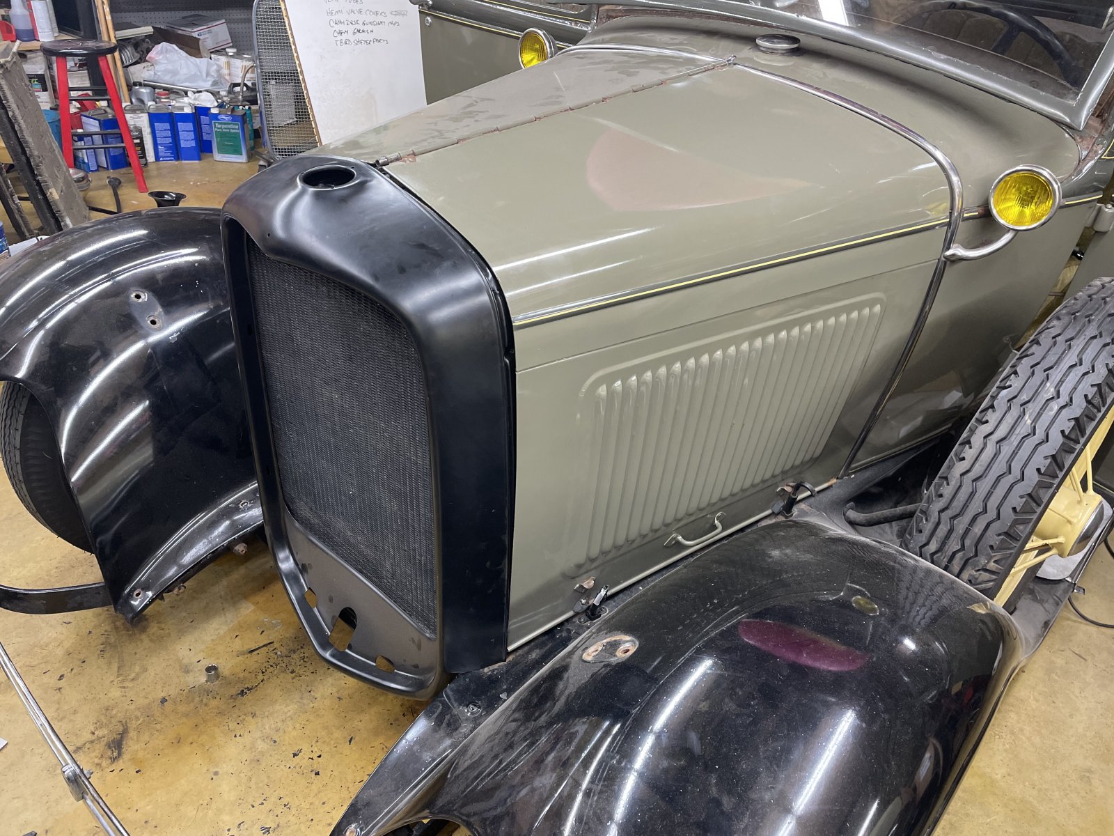

    Alllllmmmmoooooosssstttr but not quite fits….
    Looks like I’ll need to trim a smidge off the bottom of the shell where it sits on the fenders…as most everyone says you need to, and lean the radiator back about 3/4 of an inch. I’ll paint it match of course, and I have a 32 swan radiator cap for it….starting to get the sweater I unraveled knitted back in place.

    I've heard getting the headlight bar to clear the front of the '32 shell can be frustrating.

    I understand that as well. I have an old dropped headlight bar I’m going to use, but it already needs a bit of tweaking, so when I get the courage to fire up the torch and do that, I’ll tweak it to clear the grille insert as well.
