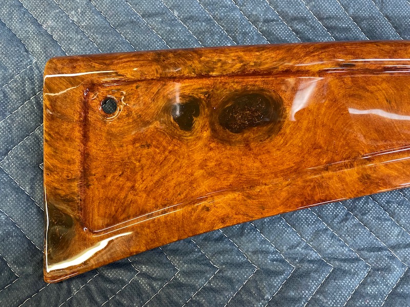

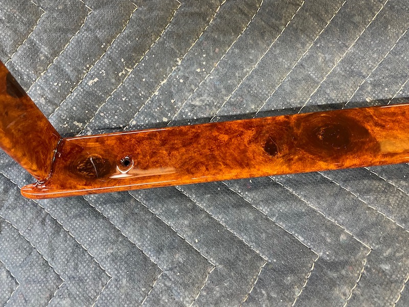

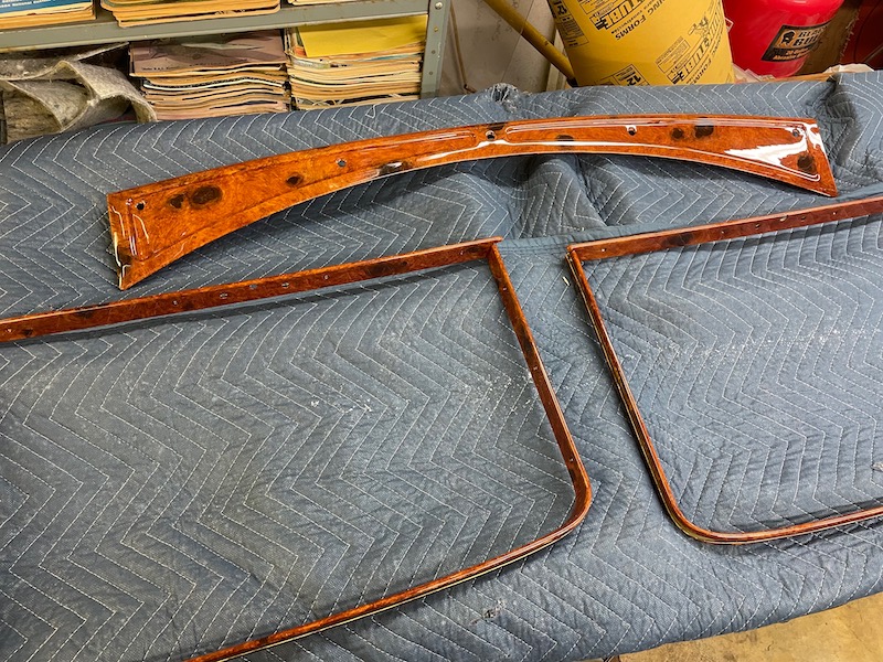

    Been elbow deep in home projects, so no real progress on the A other than moving it around the shop and the driveway shuffling things around. But, here's some teaser shots of the wood grained dash and garnish moldings I picked up at the Stray Kat....

  19. Those turned out great!
    drdave likes this.
  20. Tim
    Joined: Mar 2, 2001
    Posts: 20,103
    Tim
    from KCMO
    Yeah those are fantastic!
    drdave likes this.
  21. drdave
    Joined: Jan 3, 2006
    Posts: 5,237
    drdave
    Thanks guys! Real happy with how they turned out. Hopefully I won't scratch them putting them in. LOL

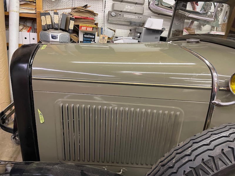

    A little update. Had an hour after a dr's appointment yesterday so I had a little time in the shop but not enough time to get dirty and clean back up before I had to be to work. Took the time to finish mounting the 32 grille shell to the radiator. Sadly, once it was all on, I am still left with an inch or so gap between the shell and the hood. The top of the radiator is pushed back as far as it can go on the support rods, so I guess I'll run a die down the rods to get some threads further down and cut a little off the ends so I can tip it back another inch-ish.

  23. The37Kid
    Joined: Apr 30, 2004
    Posts: 32,450
    The37Kid
    Was this radiator in the car with the A shell, or a new addition?
  24. drdave
    Joined: Jan 3, 2006
    Posts: 5,237
    drdave
    It's the A radiator with the filler moved to the inside under the hood.

  26. The37Kid
    Posts: 32,450
    The37Kid
    OK. Maybe the four shell to radiator attachment holes are in different locations 30-31 vs 1932? Does the front of the radiator bottom out on the curved '32 shell, the 30-31 is more square and may have more room.
  27. Tim
    Joined: Mar 2, 2001
    Posts: 20,103
    Tim
    from KCMO
    Where it’s an even gap all the way around that’s what I would try. Just scoot the shell back if it’s got room to move before bumping the rad

  29. drdave
    Joined: Jan 3, 2006
    Posts: 5,237
    drdave
    Yes, the shell is all the way back up tight to the radiator (a '30) and I had to drill two new holes for the upper mounting bolts, just as I have seen on other threads about fitting 32 shell's to 30/31 A's. The bottom of the radiator is scooted back enough and the gaps are good down low, so just need to tip it back a bit more. You can see the support rod is up against the back of the radiator tank, so I'll need to shorten it a bit, but the threads also won't be deep enough, so I'll have to run the die down and cut a few more I guess. In my mind I figured that fit-age and gaps weren't a huge concern in the early days of the****embly line so there is a bit of fudge to get things to fit I guess. LOL
