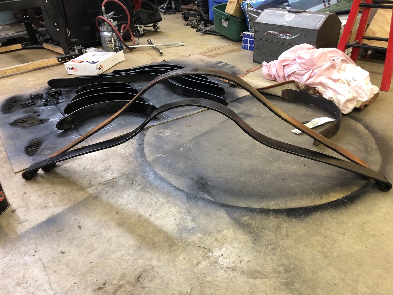

  1. Thanks they're all fixed. I have almost the same setup with all T leaves except the top A leaf for width. I didn't think I'll need to reverse the eyes but wasn't sure until all the weight was on it.
    I did the same thing to compare.

    Yeah, I didn't reverse the eyes on the back (I did on the front). I'm glad it landed where I wanted it with just adjusting the number of leaves.....I wasn't looking forward to reversing that rear spring with all the curves. LOL

    Hey Dave! I had read that a T spring in the rear would lower an A. Turned out to be true. Here’s the T main leaf and the A main leaf together.

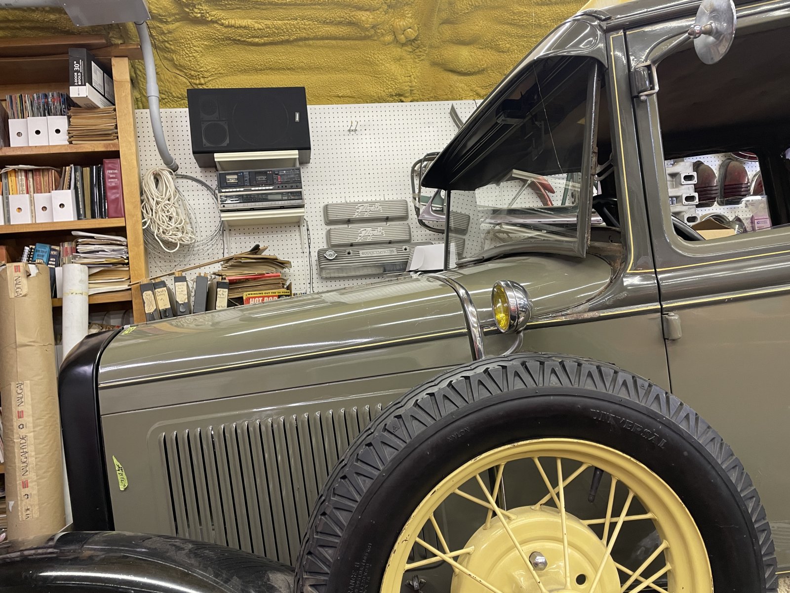

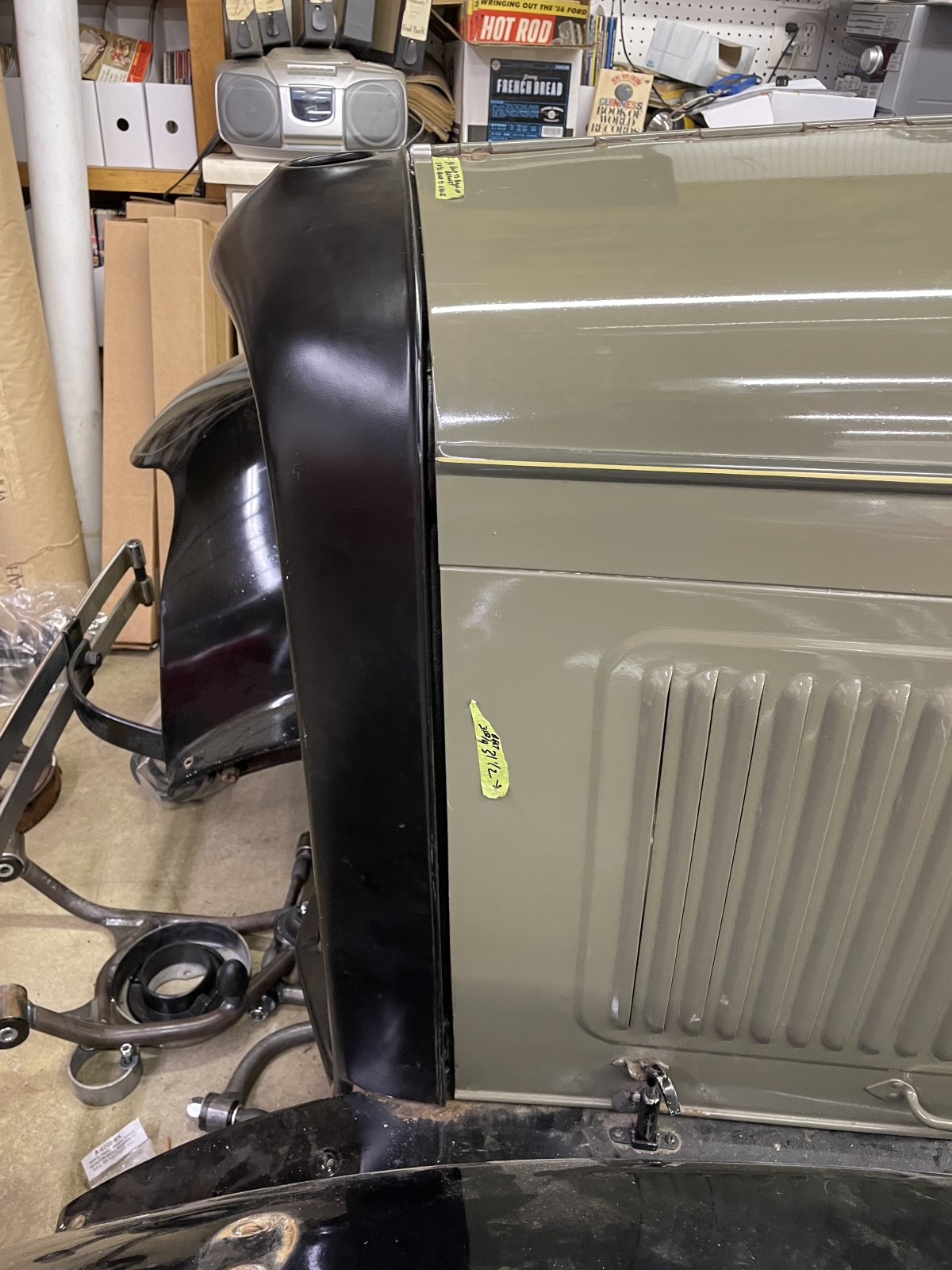

    Fiddled with the car a bit this morning before I left for the lake for a weekend of installing windows. Over the course of the last week or so, got a few minutes here and there to extend the threads on the radiator support rods, cut a smidge off the ends, and clean and paint them. Mounted them this morning and the result was I was able to move the top of the radiator back enough to get the hood gaps acceptable. The distance from the front of the firewall band and the back edge of the grille shell is the same now as it was with the A shell at the top and within an 1/8” at the bottom. I’ll call that close enough. Setting it all together, the grille shell seems at a good height so the hood is still straight/level.
    I guess the next up is to sort out the dropped headlight bar and decide where to drill the conduit holes in the shell, then it’s ready for paint and ***embly.

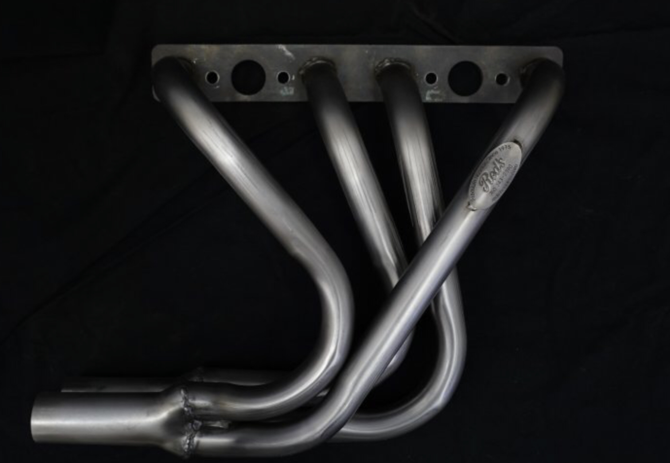

  12. Well Hello Dr. Dave,
    Was thinking about you this morning as I want to lower my A. I’ve been away from here couple years, but so glad to see some familiar names! So we moved to the NJ Shore 2.5 years ago. We always wanted to be on the water so here we are. I bought right before Covid. Thank goodness as now you can’t move here for under a lotta $.

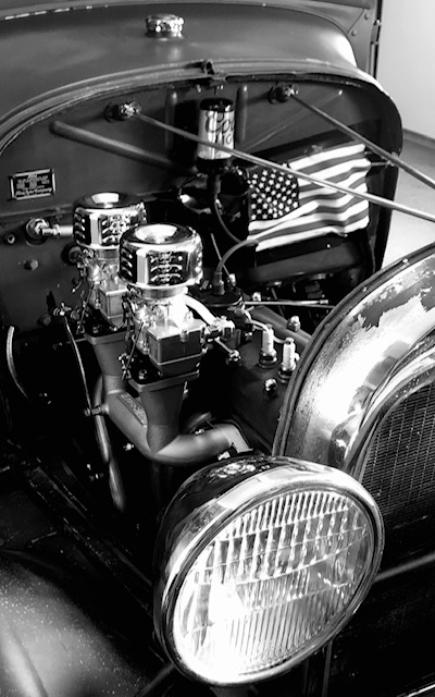

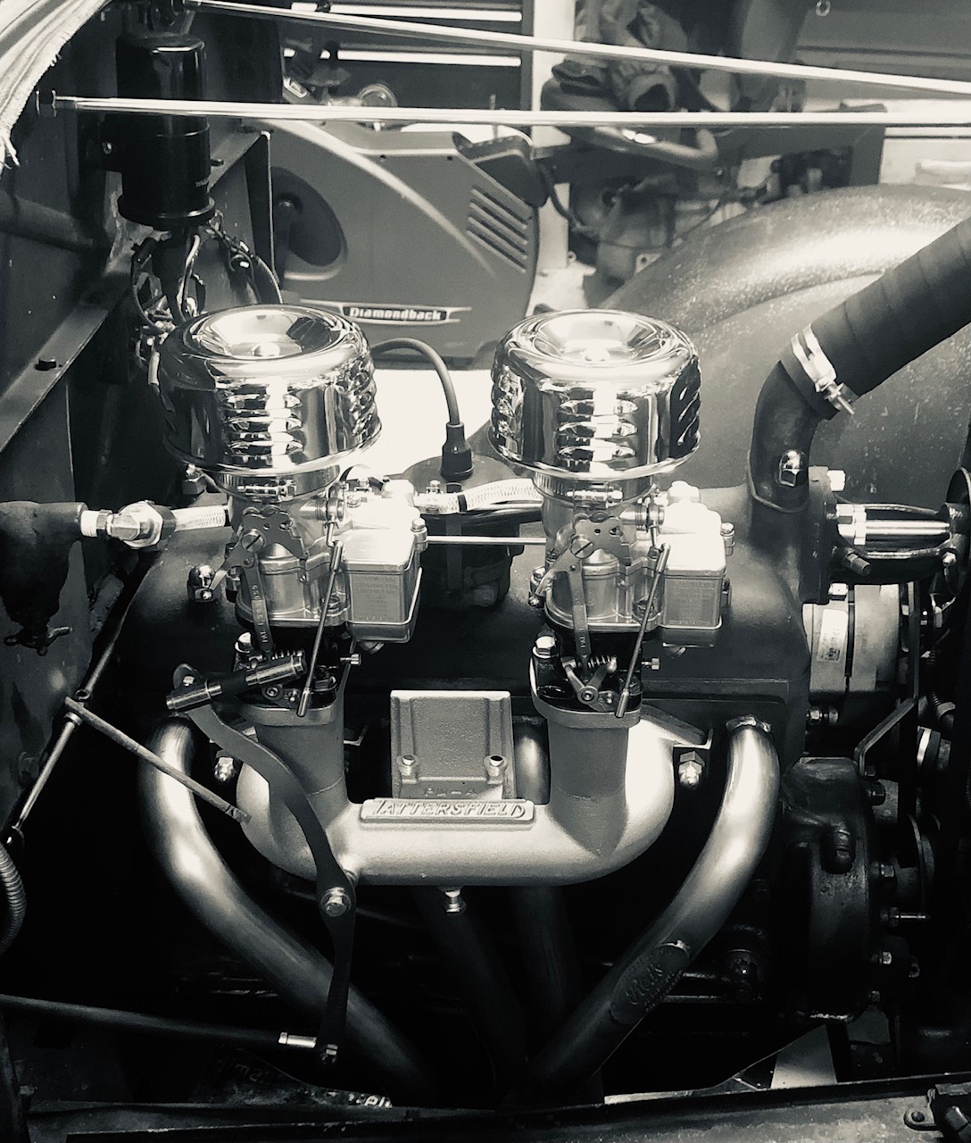

    Anyway, your car is looking great!I will be updating my old post soon I hope. I’m doing a T5 conversion that I will do***ent. Got all parts from Eddie, MODELA5. Happy Holidays!
    Yea, this came along and kinda stopped the Model A fund!
    thats me and daughter on my Grady 208. Wife took that pic from our front porch.
    Across from my home.

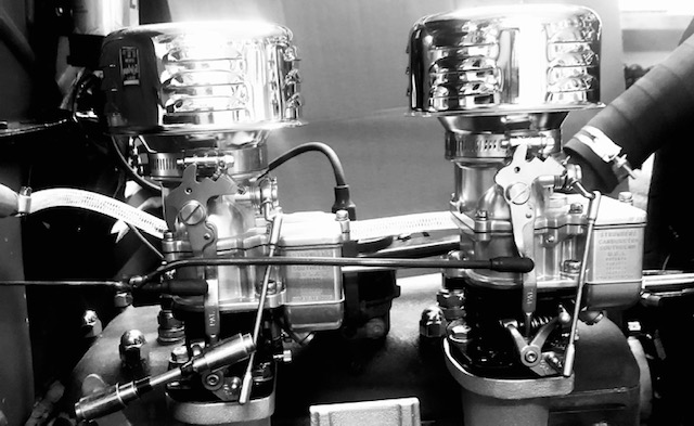

    Got my new Stromberg 81’s. Look amazing and run great…Reds 1 into 2 header, and hi rise manifold.

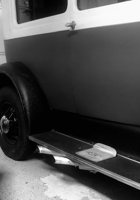

    Smitty’s gl*** packs out the side…2. Sounds great!
    Glad your still here! Cheers…Phil

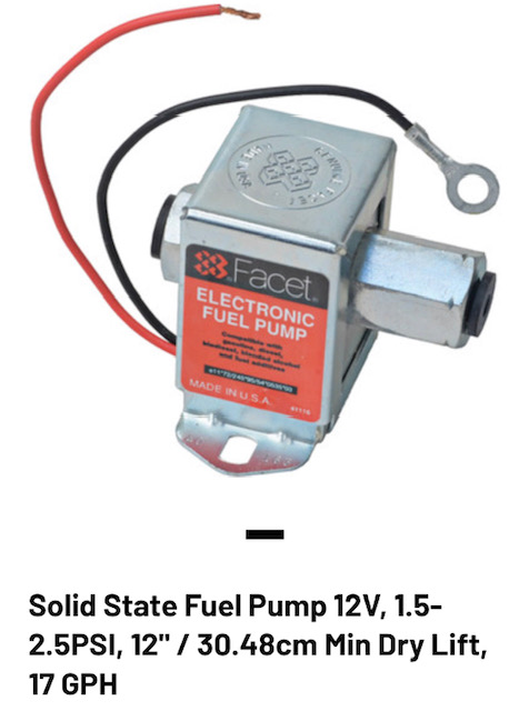

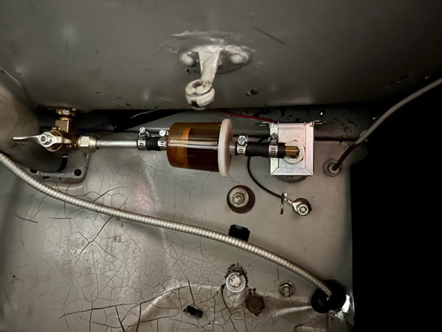

    Are you feeding those carbs right from the gravity feed of the stock A fuel tank or from a fuel pump? It looks like they are plumbed right to the fuel tank outlet. I guess I had in my mind changing to downdraft carbs meant a fuel pump was necessary.
    Okie Pete and Sancho like this.
  17. Very good question! Electric Facet pump inside. They are a little noisy, but very precise. The one pictured is not mine. Going to get this one. There are many options with this. Regulators don’t really go to a 2psi accurately.
    Here is my setup…Cigarette anyone!

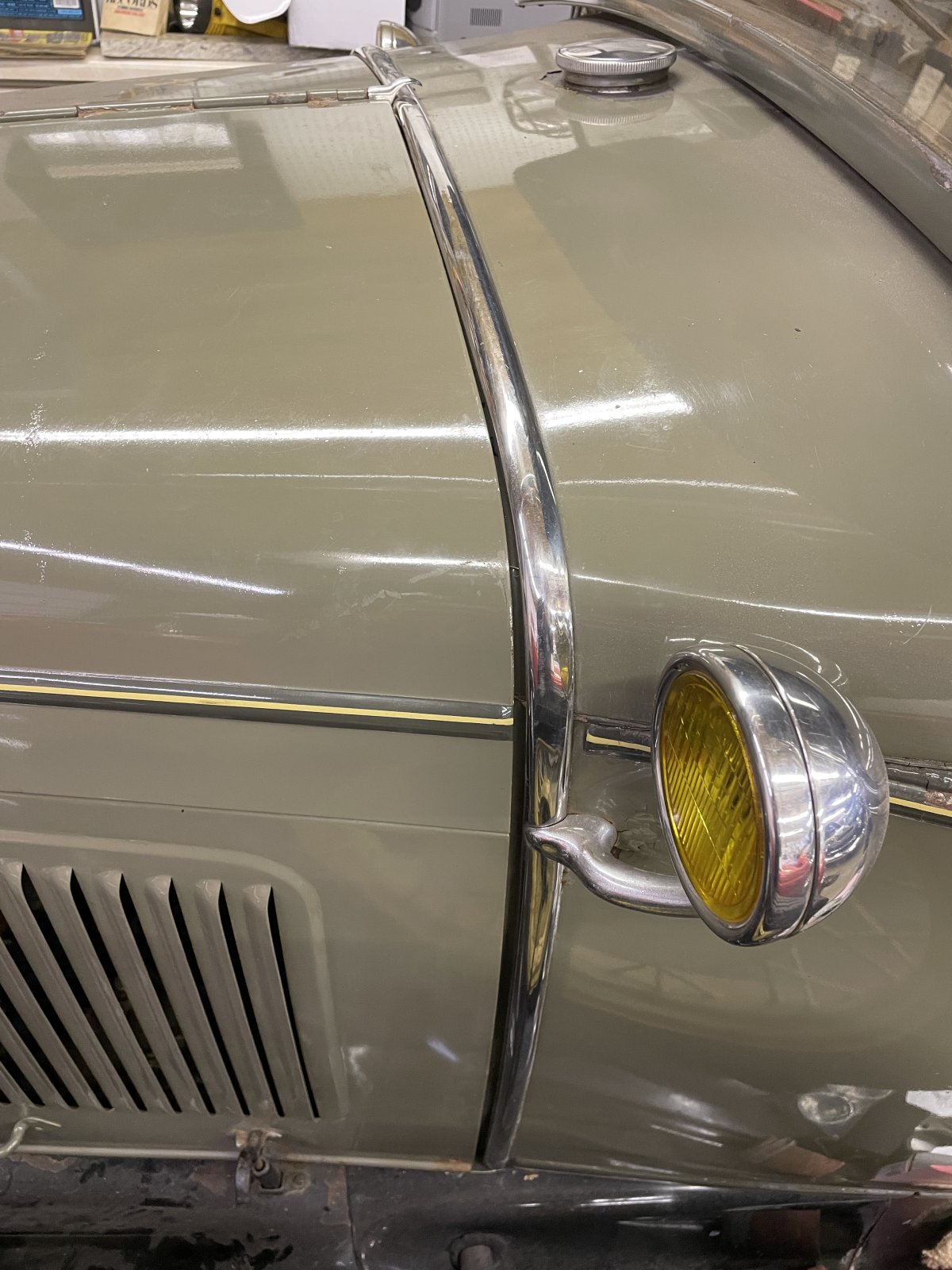

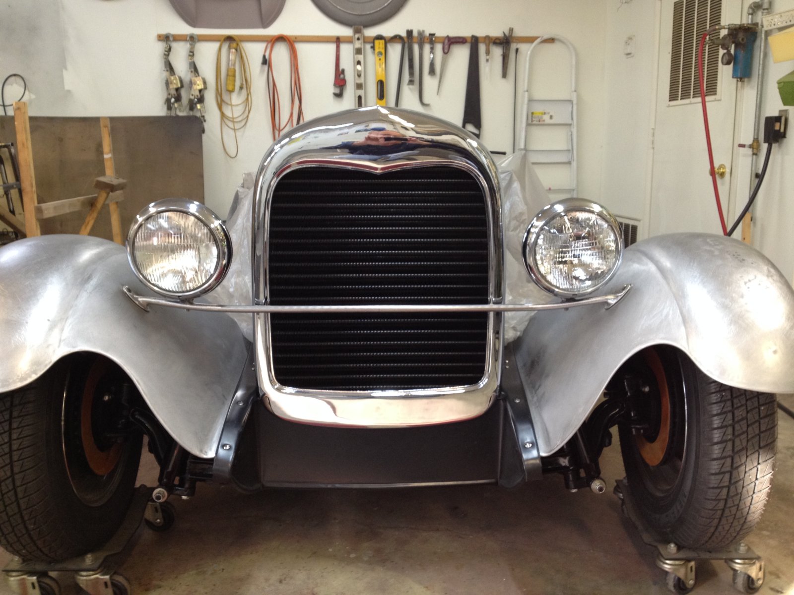

    Not much to report. I've been working on it off and on as I get a bit of time here and there. Got the wood grained windshield trim and new hinge hardware on along with the dash.
    I really need to work on the dropped headlight bar, but haven't had a big enough chunk of time to tackle it yet. I got this original A headlight bar a while ago that was dropped heaven knows when. It has a bit more curve in the middle than my stock bar, kinda like a '32. Sadly, whoever dropped it shrunk it's length. Maybe it fit the car they had, but it's too short for mine. So, I need to mess around with it and stretch the bends back out so it fits. Also, they got the drop too close to the bottom bolt hole so I can't get the lower bolt in. I'll start my stretching there and widen that enough on both sides so the bolts fit then see where I'm at.

  21. Tim
    Joined: Mar 2, 2001
    Posts: 20,324
    Tim
    from KCMO
    Looks like it should pull out and land just right. Now for the fun of over thinking a jig lol

    [​IMG]Somebody might be willing to cut the ends of a mid 1930 headlight bar to save on shipping costs so you can correct the dropped bar. Bob

  24. 5280A2
    Joined: Sep 8, 2014
    Posts: 197
    5280A2
    Looking at the difference in where the cups are for the headlights, do you think that might be a '28-'29 bar that had the ends dropped and then had the middle curved? Seems like they're farther apart on the bottom bar even though the curve is more pronounced.
    You should be able to file the bottom holes at an angle that allow you to insert the bolt before the bolt goes through the fender and fender bracket. That's how mine was done so you could get the bolt in. The large head on the bolt covers up the enlarged, somewhat oblong bolt hole. Most dropped bars get cut apart with a piece added in the middle, I think you can save it.

  25. drdave
    Joined: Jan 3, 2006
    Posts: 5,270
    drdave
    That's a good idea @5280A2....I'll keep that in mind. I thought maybe it was a 28/29 bar but someone would have had to go to a lot of work to have curved what would have been a straight bar. Of course, who knows...I wasn't there. ;)
    Thank you for the offer @The37Kid. I think I'll be fine without cutting it apart. My plan is to make a frame/template off the one that came off the car from some s**** I have laying here (learned that trick from the Vern Tardel book lol). That way I'll have something solid to bolt the dropped one to that will be the right dimensions I need to reach. Then, it's a "simple" matter of heating each section of the bends and easing them back out a bit. I'll need to move the center forward a smidge as well to clear the 32 grille bars. Of course, I've never heated and bent steel before, but I bend wire and have to keep it all in plane in 3 dimensions for a living, so we'll see how it goes. LOL

  26. Tim
    Joined: Mar 2, 2001
    Posts: 20,324
    Tim
    from KCMO
    One way to confirm it’s a 28-9’or a 30-1 is to look at the face that meets the fender. One has nubs that protrude out and the other is flat.

  27. pprather
    Joined: Jan 10, 2007
    Posts: 8,985
    pprather
    If you take some of the curve out of the center, will that push the ends out to the fender?
    drdave likes this.
  28. jakesbackyard
    Joined: Feb 13, 2007
    Posts: 949
    jakesbackyard
    from ND
    I made this bar from scratch for my old 29. Speedway sells the H/L cups. What I did with the inner bolt because I didn’t have room (like you don’t) is welded in a pointed stud (I don’t have a pic) that stuck down about 3/4” to locate and hold in the lower fender hole. Then used a bolt in upper hole to secure the bar on each end. Hopefully this makes sense. 649C84F3-56FC-496E-A428-0EEC46138C3C.jpeg 649C84F3-56FC-496E-A428-0EEC46138C3C.jpeg 3CED569C-72FB-437F-BDDB-DFBA5DDD78E9.jpeg
    winduptoy, Okie Pete, Outback and 2 others like this.
  29. drdave
    Joined: Jan 3, 2006
    Posts: 5,270
    drdave
    Which one's which? I was mostly going by the curve in the middle. LOL
    I think it sure would, but not sure how to pull that off. The middle is a hollow tube so much as I understand it rather than an actual bar. Not exactly sure how to flatten it without collapsing the hollow middle?
    Makes total sense, Jake, thanks for the tip!!!!
