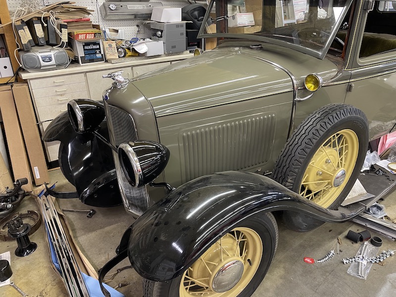

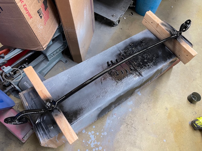

    Tada! A dropped headlight bar that fits like it should. Now I can confirm where I want to drill the holes in the grille shell for the wiring conduits and pull it apart for paint.
    Headlights are in primer...which of course revealed a couple dings I missed. I'll finish these up and prep the headlight bar then these items I'll paint black. I had some paint matched to the body, so the grille will be painted the color of the hood. Hopefully it's a pretty close match. ;)

    Headlight bar is done and painted, headlights are in final primer, grille is in sealer and should be painted tonight. Almost to re***embly stage!! 3 1/2 weeks until the Stray Kat....I think I can make it. LOL

    Thanks for posting that! That's a sure fire way to do it and not lose length at the same time....and be able to get more drop in the process. If I end up wishing I had more drop, I may go back into it and do it this way....but right now the jack out of my press is under the lake house to replace rotten sills. LOL

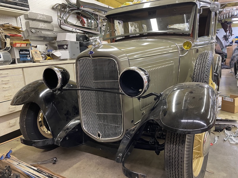

    All the little steps finally added up to big step last night. Got the grille shell, headlight bar and headlights all in place. Pretty stoked with the change it's all made.
    There would be those a**** my close friends that would say I let a creeping attempt at perfection get in the way of getting things done and back on the road, and they are 1,000% correct. But, rest ***ured, my spray can painting and less than perfect hurried prep in this case matches the dinged, scratched, chipped, peeling age of the car quite well. LOL. I even put the splash apron back on without stripping and repainting it....just s****ed the flakes off the back and threw it back in there. Haha
    Started drilling new holes in the bumper irons for the 32 bumper. Ever try to drill a hole in a Henry bumper iron? Good gravy, I'm wondering how many drill bits and how much oil this is going to take. LOL Also working on converting the horn to a '32 back cover and mount so I can mount it down at the bottom of the fender on the frame rail like a '32 since now it won't fit it's original spot under the headlight with the dropped bar. Finish the 12 volt conversion and I'm back on the road. Stray Kat here we come!

    You may find it simpler to modify the Model A horn bracket to fit the dropped bar. I was able to modify a horn bracket to provide about 3/4-inch offset so the horn would fit back into the smaller area below the dropped headlight bar.
